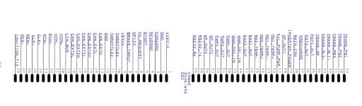

Assembling the VCU
Looking to build a ZombieVerter VCU yourself or the kit is missing hardware?
- Zombiverter hardware page for additional build instructions
The enclosure and header are required if you did not order a fully built board
VCU boards from the webshop, come pre-programmed and do not require any additional steps taken to work.
For programming a blank board see: ZombieVerter programming
The enclosure kit options:
The original connectors are from Aptiv (Delphi):
- Aptiv 56-pin connector
- Aptiv 56-pin header

Wiring
Each device requires different wiring setups, settings and power requirements.
*cross referencing OEM wiring diagrams is highly recommended
Wiring the ZombieVerter with:
- GS450H with ZombieVerter
- Leaf stack with ZombiVerter
- Tesla SDU with ZombieVerter
- Chademo with Zombieverter
Power wiring
The ZombieVerter requires a permanent 12V supply. This is so it can manage charging, timers, and monitor systems when the car is at rest.
The average power draw, at idle, is 150 mA.
- Pin 55 to 12V- ground
- Pin 56 to 12V+ positive
The ZombieVerter controls power/"ignition" signals to other devices (inverters, chargers, and DCDC converters), powering those devices when required. This is done by triggering an external 12V relay. ZombieVerter controls the external relay using low-side switching, meaning that it pulls the ground pin of the relay to ground.
- Pin 32 to ground pin on a 12V relay
- Relay positive pin to 12V+
- One of the relays switch pin to 12V+
This effectively provides a switched 12V supply, controlled by the ZombieVerter.
Used to switch "enable" mode to devices via:
- Leaf inverter enable pin
- Leaf PDM enable pin
- Mitsubisihi OBC enable pin
Contactor wiring
The Zombieveter manages the Negative, Positive and PreCharge contactors in an EV conversion.
This is done based off a series of voltage measurements (UDC), this voltage value (UDC) can be supplied from a variety of sources:
- ISA IVT shunt
- Nissan leaf inverter
- BMW S-BOX
- etc.
Without a proper UDC measurement, the ZombieVerter will fail precharge and never go into run mode.
The contactor control pins on the ZombieVerter are low-side switching, meaning that they pull to ground.
The positive leads from the contactors need to be connected to 12V+ and the ground leads to:
- Pin 31 for the negative contactor
- Pin 33 for the positive contactor
- Pin 34 for the pre-charge contactor
Throttle pedal wiring
The ZombieVerter supports dual-channel throttle. This redundancy is for safety in case one channel fails or drops out. It's highly recommended to use dual-channel throttle. Single-channel is an option.
Connect the following to the ZombieVerter pins:
- Pin 45 to throttle grounds
- Pin 46 to throttle channel 2
- Pin 47 to throttle channel 1
- Pin 48 to throttle positives
Start, Run, and Direction wiring
The ZombieVerter requires 2 inputs to get into "drive" mode. These pins need to be pulled high (connected to 12V +)
- Pin 15 to "on" switched input (key switched to "on")
- Pin 52 to "start" momentary input (momentary key switched "ignition")
Forward and Reverse
- Pin 53 reverse
- Pin 54 forward
