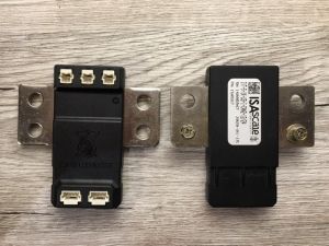

IVT-S 1000A current shunt front and rear
The IVT-S current measurement device, often referred to as a current shunt, is one of the most popular current measurement devices for use with open source EVs due to its high precision, modularity and relatively low price point. The IVT-S comes in a number of current ranges to suit the peak usage and budget of your EV - 100A/300A/500A/1000A/2500A.
