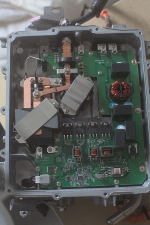

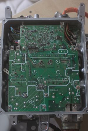

Internals:
Bottom | Top |

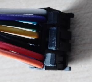

Note: Although the above pin numbers, for the 13 pin external connector, match the Mitsubishi wiring diagram the numbers marked on the connector are reversed for each row. Pin 1 is CAN H (Black), pin 6 is NC (orange), pin 7 is CAN L (red ) and pin 13 Sense ( green ). IGCT +12V power should not be powered permanently, this will create problems for using the charger. Recommended to only have the Charger powered with Ignition on or charging.

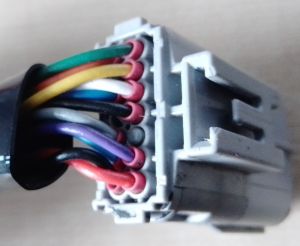

The charger is controlled via a 13-pin connector mounted on a short tail into the case. Connectors seem to be widely available to mate with this. Search for "Sumitomo 6189-1092 13-WAY CONNECTOR KIT Inc Terminals & seals [13-AC001]".

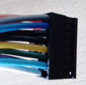

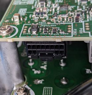

Internal Connector
In case the Charger doesn't come with the signal pigtail (which it usually does), the internal signal connector is from the Hirose GT8E series[6], specifically the Hirose GT8E-12DS-HU[7] with Hirose GT8E-2022SCF[8] pins.
The External to Internal wiring harness is as follows:
Internal Connector (Black) | External Connector (Grey) | |||
Pin | Wire Colour | Pin | Function (If Known) | |
1 | grey | 4 | DC SW - Enable DC/DC Converter | |
2 | blue | 3 | NC | |
3 | black | 6 | CAN H -CAN High | |
4 | black | 10 | GND – Ground | |
5 | yellow | 8 | IGCT – Main +12V Power Supply (via shared 7.5A fuse) | |
6 | green | 7 | Sense - Sense for DC/DC Converter (via shared 7.5A fuse) | |
7 | light blue | 5 | CHIN - Serial Protocol to EV Remote WiFi Module | |
8 | NC | 11 | NC | |
9 | orange | 1 | NC | |
10 | red | 13 | CAN L – CAN Low | |
11 | purple | 12 | CHOT – Serial Protocol to EV Remote WiFi Module | |
12 | white | 9 | CP – Control Pilot from Charge Port |
