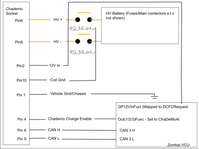

Chademo with Zombieverter
https://www.youtube.com/watch?v=zuPvgzQt6XQ
Requirements
  • Chademo Socket
  • 2 Contactors for Chademo use
  • Zombie VCU
  • shunt *
  • Jumper settings for HS CAN3. Solder SJ6, SJ7, SJ8 and SJ9, as per the instructions on the back of the board. Additionally Solder SJ5 and SJ10 for CAN3 Termination.
parameters:
  • "interface" set to "chademo"
  • "chargemode" set to "EXT_DIGI"
  • A GP output set to "ChaDeMoAl"
  • "GP12VINFuct" set to "DCFCRequest"
  • "CCS_ILim" set to maximum desired charge current
no shunt chademo bug:
While technically shunt is required for DCFC to measure current, there currently is a "bug" in firmware 2.30a that allows the zombieverter togo into charge mode and enable chademo with using the leaf inverter for UDC values and outlander OBC as charger.
conditions required:
  • zombie in op mode "off"
  • set "chargemode" to: "out_lander"
  • set "interface" to: "chademo"
  • set GP in from "proxpilot" to "none"
zombie should enter charge mode
  • plug in chademo station and start dcfc session
Chademo with Leaf Gen 2 PDM
In order to implement Chademo the QC contactors in the PDM need to be closed. At the moment the ZV can't do this so a small wiring modification needs to be done to the PDM. See this forum post for full instructions.
https://openinverter.org/forum/viewtopic.php?p=91584#p91584
Chademo Zombieverter connection diagram
