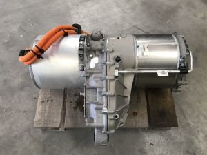

Reusing motors and inverters - aka drive trains
The drive train is one of the defining building blocks of your conversion as it defines how well your vehicle picks up speed. Over the years we have reverse engineered many popular drive trains from production cars such as Teslas. As a bonus using such complete drive trains facilitates getting the vehicle road legal in many countries. By now you have a choice of low to medium power drive trains that only cost a few 100€ up to high performance ones at many 1000€.
We have established two methods of running these OEM systems: reverse-engineering their communication protocol and making the drive train "think" it is still in its original vehicle OR swapping out the control electronics for our own open source motor controller. The latter method gives your more control and power but also a steeper learning curve.
Nearly all drive trains are targeted at 400V battery voltage. Run at a lower voltage they will produce proportionally less power. Here is what we have done so far and how we've done it. Some is still work in progress (WIP)

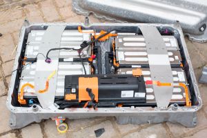

Reusing Batteries
The most expensive and probably equally defining component is the battery that stores all the energy for running your car. Batteries are usually assembled from a number of modules that in turn contain a number of cells. Usually batteries are reused on a module level. In rare cases the battery can be reused as is in its original battery box.
While there are also various open source implementations of battery management systems (BMS) we generally recommend using as much of the OEM BMS as possible. Sometimes the OEM BMS comes as an all-in-one solution that measures cell data and spits out state of charge and power limit information. In other cases the BMS is split into module units that measure the physical data (voltages, temperatures) and a central unit that calculates the high level information.
Sometimes we managed to reuse the complete system which is generally the safest as you can rely on the manufacturers well tested charge and discharge limits as well as reliable state of charge information (i.e. how much energy is left in the battery at any given time). In other cases we only managed to reuse the module units. This adds the convenience of having a well tested piece of hardware with the matching connector but required us to calculate all high level battery data ourselves. This also includes cell balancing.
Manufacturer | Model | BMS usability | Energy Content | Configuration | Rated Output | Achieved Output | Notes |
Tesla | Model 3 | Module and high level [WIP] | 60-80 kWh ? | ||||
Model S | Unknown | 85-100 kWh | |||||
Nissan | Leaf/NV200 | High Level | 24-40 kWh | ||||
VW | Passat/Golf | Module Level | 8.7-36 kWh | ||||
MEB | Module Level | 52-77 kwh | |||||
BMW | 3 Series Hybrid | Module Level | Gen 1: 7kWh. Gen 2: 9KWh | 80s | 83kW | These Batteries use the same modules. 3 series uses 5 whilst the 5 &7 series uses 6. | |
5 & 7 Series Hybrid | Module Level | Gen 1: 9kWh. Gen 2: 12kWh | 96s | 83kW | 120kW | ||
X5 | Module Level | 24kWh | 96s | 83kw | 12 Modules. |

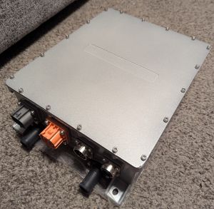

Onboard chargers and DC/DC converters
The DC/DC converter takes energy from your HV traction battery and sends it to the cars 12V systems and 12V battery. It is basically a 1:1 replacement of the former alternator. An onboard charger (OBC) takes AC current from the grid and converts it into DC current to charge the battery. These two devices are often combined in one common enclosure hence why we treat them as one.
Manufacturer | Model | OBC | DC/DC | OBC power |
Tesla | Model S (Gen1) | yes | no | 10 kW |
Tesla | Model S and X (Gen2) | yes | no | 11 kW |
Tesla | Model S and X (Gen3) | yes | no | 22 kW |
Tesla | Model S and X (DC/DC) | no | yes | |
Tesla | Model 3 | yes | yes | 11 kW |
Chevrolet | Volt | yes | yes | 3.7 kW |
Chevrolet | Volt 2 | yes | yes | 3.7 kW |
Dilong | yes | yes | 6.6 kW | |
Eltek | yes | no | 3 kW | |
Mitsubishi | Outlander / iMiev | yes | yes | 3.3 kW |
MG | ZS / MG4 / MG5 | yes | yes | 6.6 - 11 kW |
There are more chargers under investigation, only the proven working ones are listed here. See our charger listing for more.

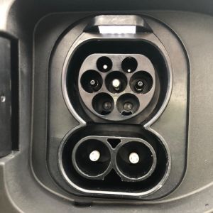

Rapid Charging
The above mentioned onboard chargers always have limited power as the space requirements and cost rise with power. To overcome this limitation modern EVs offer external access to their HV battery via a so called rapid charging port. This allows to charge the battery with a much more powerful external charger. As a bonus it also allows taking energy from the HV battery and powering appliances with it.
There are 2 rapid charging protocols and 5 connector flavours world wide
Connector | Communication | Prevalent countries | Open Source solutions |
CHAdeMO | CAN | Japan, world wide | ESP32, Arduino, ZombieVerter |
CCS Combo1 | PLC | US | Foccci, pyPLC |
CCS Combo2 | PLC | Europe | Foccci, pyPLC, I3LIM |
NACS | PLC | US | Foccci, pyPLC |
GB/T | CAN | China |

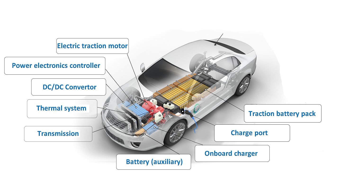

Auxiliary Parts
We have now treated all the major building blocks of an EV, but there are many other components to complete the vehicle such as heaters, gear shifters and so on. We will summarize them here.
- HV Junction Box
- HVAC (Heating, Air conditioning)
- Vacuum Pumps
- Power Steering
- Water Pumps
- VCU (Vehicle Control Unit)
- Shift Controllers
- Charge Ports
