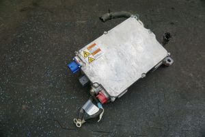

The Tesla Model S/X GEN2 DC-DC Converter is a popular candidate for EV conversions. It was first available in the Model S around Jan2014, and later in the Model X. It is located in the frunk area near the cowl.
It is not to be confused with the earlier GEN1 DC-DC Converter, whose casing was of a kidney-shape, was located in the RF fenderwell against the firewall, and it incorporated functions of the front HVJB; it contains fuses for the coolant heater, cabin heater, and air-condition compressor, and servicing these fuses was never supported by Tesla (though is frequently performed in the aftermarket), so it developed a reputation for being unreliable due to frequent replacement for blown fuses. Though the hardware connections are different between GEN1 & GEN2, they both use the same (5) wired connections with the same functions, and the CAN commands appear to (may be) the same.

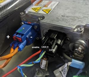

HV connector: KET MG655776 type D
HV+ (positive) line is the one on the leftmost - opposite side of the red 12v output bolt.
Note, be careful about which connector you get when salvaging this connector from Telsa wiring harnesses. Specifically, you want the key D variant.
- Orange (A/C): MG655773 (key A)
- Gray (fluid heater): MG655774 (key B)
- Brown (PTC heater): MG655775 (key C)
- Blue (DC-DC): MG655776 (key D)
Donor Harness: Tesla OE/OEM Part Number: 1032804-00-A has two Blue DC-DC plugs.
LV & Signalling

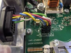

LV connector: Molex 0334721301
LV connector (top row)

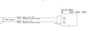

- Pin 1 : HW-EN (Enable ("turn on") via applying 12v+ )
- Pin 2 : CAN H
- Pin 3 : CAN L
The remaining pins are for the HVIL loop, and can be ignored if desired, as they do not affect the unit's function.
