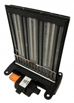

Overview[1]
PTC heater assembly found in VW ID series (ID.3, ID,4, ID.Buzz, etc.), as well as other VAG EVs (Seat, Skoda, Audi, etc).
- According to VW, the nominal voltage is 150 to 475V, but findings suggest it’s usable from 180VDC.
- It is made by Valeo and has a operational range between 0 and 6kW.
Part Numbers
| VAG Part Number | Found in Vehicles | Tested? |
| 1EA963581AQ | No | |
| 1EA963581BM | No | |
| 1EA963581BN | No | |
| 1EA963581C | VW ID. series | No |
| 1EA963581D | VW ID. series, Cupra Born, Audi Q4 e-tron, Škoda Enyaq iV | Yes |
| 1EA963581E | VW ID. series, Cupra Born, Audi Q4 e-tron, Škoda Enyaq iV | No |
| 1EA963581F | VW ID. series, Cupra Born, Audi Q4 e-tron, Škoda Enyaq iV | Yes |
| 1EA963581G | Audi Q4 e-tron | No |
Connectors
High-Voltage Connection
TE HVU 280 series
- Mating housing: 1-2318082-2 (key B)
- Contacts:
- TE-NO: 2-968859-3 (WIRE SIZE 4mm²)
- TE-NO: 2-968857-3 (WIRE SIZE 2.5mm²)
- Seals:
- TE-NO: 828985-1 (WIRE SIZE 4mm²)
- TE-NO: 963292-1 (WIRE SIZE 2.5mm²)
Or it can be salvaged at a junk yard from these part numbers:
- VW 1EA 973 702 X (The connector itself. Note: The 5119B variant fits the PTC perfectly unlike 3220B that requires some minor modifications)
- VW 1EA 971 475 B (A HV cable that connects to the PTC Heater. It uses the correct 5119B variant)
Low-Voltage Connection
VW 1J0 973 703
Potential Equalization
M6x1 lug
Dimensions and 3D Model
3D Model available at GrabCAD: [4]
heater matrix is 244mm long x 204mm wide x 27mm thick
the length of the entire unit is 284mm long
