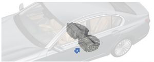

The battery pack is located under the rear seat.

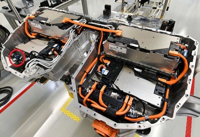

Location of Blue Connector on Battery Master 5 module pack

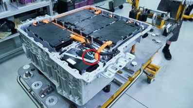

Location of Blue Connector on Battery Master 6 module pack

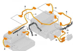

and here's how the six cell modules are connected together with the high voltage orange wires
High Voltage Cables
#1 Part Number: 61278621016 Main Negative (runs from Cell Module #1 to the Safety Box #8 front connector)
#2 Part Number: 61278621017 Connects Cell Module #2 to Cell Module #3
#3 Part Number: 61278621018 Connects Cell Module #3 to Cell Module #4
#4 Part Number:61278621019 Connects Cell Module #4 to Cell Module #5
#? Part Number:??????????? Connects Cell Module #5 to Cell Module #6
#5 Part Number: 61278621020 Main Positive (runs from Cell Module #6 to the Safety Box #7 front connector)
#6 Part Number: 61278618444 Connects Cell Module #1 to Cell Module #2
#7 Part Number: 61278650791 External Connector Positive
#8 Part Number: 61278650793 External Connector Negative

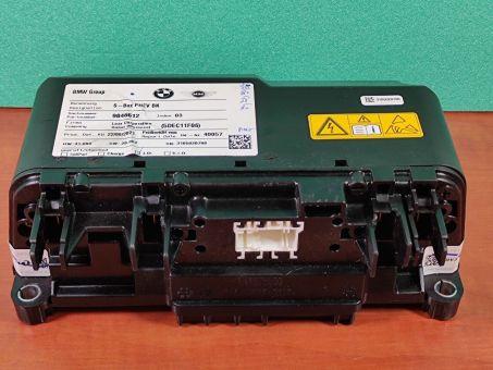

S-Box
The BMW Hybrid Battery Pack contains a module that contains contactors and a shunt which is known as a Control Unit Module Security Fuse Box, S-Box PHEV BK, or S-Box that is now supported by the ZombieVerter. There are S-Boxes available in a number of the BMW PHEV models.
BMW S-Box
BMW S-Box
Part numbers include 8686893, 8638197, 8651068, 8681536, 8844217, 9470054, 9846612, found in the following PHEV models:

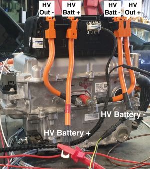

  • BMW S-Box High voltage connection

Four heavy duty spade terminals provide connection for HV Battery + , - and Output + ,-
Connection of Can data and 12v power is via a white 16 pin connector on the front.
Pins 12 and 14 to +12v
Pin 3 to GND
Pin 1 CANH
Pin 10 CANL
