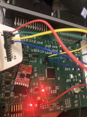

By using the ST-Link V2 in-circuit loader, .hex files can be sent to the board to initialize a fresh STM32 MCU, or if it can't be loaded via the bootloader.
Unless you have a specific reason not to, end users should use a released version from: https://github.com/damienmaguire/Stm32-vcu/releases.
The connections needed to use the ST-Link loader are shown below (the red wire provides power to the chip. If the vcu is powered by it’s 12v pins instead, the red wire can be omitted):
