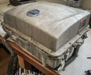

Mounts directly on top of the leaf motor inverter. Completing what is known as the "full stack"
  • 2013 to 2017 AZE0
  • 2018 to 2024 ZE1

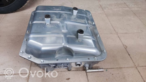

there has been various changes over the years to the shape and weight of the pdms, as the early year units are quite big and heavy. Nissan has streamlined the pdms, making them more suitable for fitting under the hood in a ev conversion.
  • any version of a pdm will physically mount onto any year leaf inverter
new, smaller cover pdm

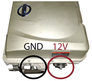

DCDC ground is through the case
DCDC positive is through the isolated M8 stud on the side of the case
