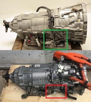

If you combine a LHD transmission with a RHD inverter (or vice versa) you might end up with a motor that is juddering, not spinning. IN this case you need to swap any two phase cables of both MG1 and MG2.

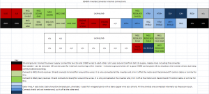

Note: If using Zombieverter, the inverter needs powering up after Zombie, use Zombie to power up the inverter.

Do not connect your HV battery to the OEM battery location, for conversion you have to bypass the buck/boost converter and connect directly to the HV bus. See the 3D printable parts below to help with this.

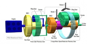

Motor information and ratios are as follows:
MG1 speed is -2.29:1[5]
MG1 rated speed is not known at this time and recommended to stick to the same speed as MG2
MG2 speed can be 1.9:1 or 3.9:1[5]
MG2 is rated at 300Nm and max 10,230 rpm[4]

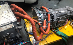

The transmission contains two "Motor-Generator" units. MG1 sits at the front of the transmission, and interfaces with the internal combustion engine through a planetary gear set. For this reason, to obtain torque from MG1, the input shaft of the transmission must be locked in place. This is usually done using a splined coupler, which is then welded onto the transmission front mount.
The input shaft on the transmission has 21 splines, with a 28mm major diameter. There are several Toyota clutches which have this in their centre. The original GS450h flywheel and coupler also contains the appropriate splined centre, of course.
The fluid fill port is the banjo bolt for the upper transmission cooler hose. The specified fluid is "Toyota WS" ATF.
It is a good idea to replace the two bearings in the electric oil pump before fitting a used transmission. There is a guide here[6]. Bearing part numbers are 61900-2Z and 608-2Z, you will need one of each.
The shift position lever on the right-hand side of the transmission engages the parking pawl when in the "all-the-way-back" position. All other positions disengage this pawl. The R, N, D, M positions only affect the output of the shift position sensor.
Note the following when purchasing the transmission:
- It is recommended to purchase one which has the electric oil pump fitted - these are a costly item as the bearings in them often fail, in some cases they cost more than the transmission. More on this in the Oil Pump section below.
- It is recommended to purchase a transmission which includes the wiring harness, or at least off-cuts of the connectors. Some connectors may be unavailable for purchase. There is a thread here which covers the connectors on this transmission.
- It is recommended to purchase the damper assembly with the transmission in order to lock MG1 as noted above. If you can not get the damper assembly, another option is to use the clutch disc from a Toyota 3B (probably also 13BT, 1HZ). These clutch discs have the same 21 spline/diameter configuration. One application is a "1983 Toyota Land Cruiser BJ-60 5spd manual". One Toyota part number is 31250-36230 (there are many depending on vintage) and you will find lots of crosses to 3rd party parts. [2] This was first discovered in this [3] post.
Dimensions
- Overall height (oil pan to top of bellhousing) is 39cm. Bell housing is full height, i.e. 39cm diameter, when the transmission is sitting on its oil pan (as it is on my bench), the bellhousing still just about touches the bench.
- Widest point is 40cm, includes a bump for a starter motor which I don't believe the GS450h even has. Likely leftover to mate with the 2GR engine.
- Overall length including tailshaft, output flange, and pilot shaft, is 82cm.
- Transmission is tapered quite heavily, the width and height is closer to 25cm after the bellhousing, but hard to gauge due to various outcropping parts (motor cables, oil pump, PRNDL selector, etc.)
- Weight is 128kg. Unknown if this is dry or filled. Likely partially filled. Unknown if this includes oil pump and cables.
- The input shaft pokes out 29mm from the general highest point of the back of the bell housing? (e.g. set a 20cm ruler there and measure from it)
- The taper at the tip of the shaft before the splines appear fully is 6mm long. (i.e. the length of the tip portion without proper splines)
- The output flange bolt pattern is 52.5mm radius (about 91mm from hole to hole). It does not seem to have a machined flange surface, only the 22.5mm diameter ~3.2mm deep recesses around the bolt holes are machined. Pilot shaft diameter is 16mm. Internally the flange has 26 quite rectangular splines. (not 27 or so like Toyota's more common off-road applications).

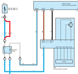

Wiring and control

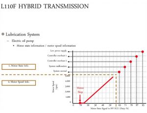

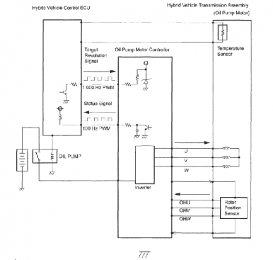

The external pump also requires a controller, which uses a PWM control scheme. Although this is rarely included with the transmission, it's quite affordably and widely available (Toyota part number: G1167-30020)
Pinouts, schematics and notes
- The metal case is the ground.
- Black (pin 6) is PWM in from your controller.
- Brown (pin 7) is PWM feedback from the oil pump. It is not required and can be left disconnected.
- The fat blue wire (pin 5) is 12V power. The oil pump uses around 50A Max. So plan for that. Add your own relay to stop it draining your battery while the car is off.
- The PWM for this is weird, it's not just 0-100. IIRC it is 0% at both ends, and rises to 100% near the middle, then back down again. This is just based on the sound of the pump with no load, so needs more testing to find the real values.

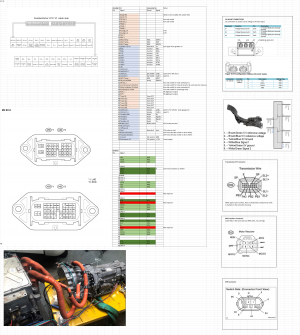

ZombieVerter VCU
As of 2022, the preferred solution (and the only one under active development) is the ZombieVerter VCU
Zombieverter pinouts and wiring diagram for the GS450H
Lexus GS450h VCU (deprecated)
Lexus GS450h VCU (deprecated) |
UPDATE: the dedicated Lexus GS450h VCU has been superseded/replaced by the ZombieVerter VCU. This section is kept active solely as legacy documentation and differs in important ways from the ZombieVerter implementation.
![]() The VCU is an external unit that will not fit within the GS450h inverter housing. It does not replace the GS450h inverter control board, instead it interfaces with it over USART.
A full schematic for the system can be found at this link Note that in addition to the VCU, inverter and transmission, a specific CAN bus connected shunt (ISA shunt) is required: Isabellenhütte Heusler
