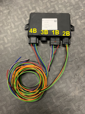

Connectors and Pinouts
All connectors are available at https://www.auto-click.co.uk/ worldwide.

Pin # | Function | Description |
1B-1 | LED_S | Charge Port Lighting (not necessary) |
1B-2 | - | |
1B-3 | LED_M | Charge Port Lighting (not necessary) |
1B-4 | LOCK_MOT+ | Charge Port cable Lock Motor |
1B-5 | LOCK_MOT- | Charge Port cable Lock Motor, and reference for 1B-16. |
1B-6 | CAN_H | Powertrain CAN |
1B-7 | CAN_L | Powertrain CAN |
1B-8 | IGN | Wake up signal input and output +12V (ignition, contact 15) |
1B-9 | VCC | Constant Power +12V |
1B-10 | GND | Ground |
1B-11 | - | |
1B-12 | - | |
1B-13 | - | |
1B-14 | - | |
1B-15 | CHARGE_E | Goes to KLE. Guessing this is charge enable or drive interlock signal? (Not necessary) |
1B-16 | LOCK_FB | Charge Port cable Lock Feedback (1k unlocked, 11k locked), referenced to 1B-5[7]. |
Pin # | Function | Description (BMW) | Description (MINI)[8] |
2B-1 | CP | Pilot (charge port)
Some charge ports need additional 620 ohms to GND. |
Pilot (charge port) |
2B-2 | PP | Proximity (charge port) | Proximity (charge port) |
2B-3 | Jumper | Connected to Pin 4 | PE / GND |
2B-4 | Jumper | Connected to Pin 3 | Connected to Pin 5 |
2B-5 | PE / GND | Ground (charge port earth) | Connected to Pin 4 |
2B-6 | - | US CCS1 version connected to 2B-2 | N/C (TBD if used for US CCS1) |
3B Pinout:
- N/A (for CHAdeMO only)
4B-1 | POS_CONT+ | Positive HV Contactor Control (Contactor coil resistance must be ~15 ohms) |
4B-2 | NEG_CONT+ | Negative HV Contactor Control (Contactor coil resistance must be ~15 ohms) |
4B-3 | POS_CONT- | Positive HV Contactor Control (Contactor coil resistance must be ~15 ohms) |
4B-4 | NEG_CONT- | Negative HV Contactor Control (Contactor coil resistance must be ~15 ohms) |
4B-5 | U_HV_DC | Charge Port DC Voltage (current input 3-20mA?)(1.42V for 0V HV, linear to 4.8V for 500V HV)[9] |
4B-6 | LED_RT | Red charge Status Light (12V RGB LED) |
4B-7 | LED_GN | Green charge Status Light (12V RGB LED) |
4B-8 | LED_BL | Blue charge Status Light (12V RGB LED) |
4B-9 | LED_GND | Charge Status Light Ground (common cathode of RGB LED) |
4B-10 | COV_MOT- | Charge Port Cover Motor (Not necessary) |
4B-11 | COV_MOT+ | Charge Port Cover Motor (Not necessary) |
4B-12 | COV_FB | Charge Port Cover Feedback (connect to GND to simulate open cover[10])(To be left floating for contactors weld test) |

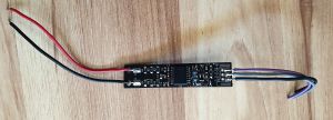

Isolated DC charge inlet voltage sense board
The LIM gets the inlet DC voltage from a board in the KLE.
This board needs to produce an isolated 3-20mA current signal (or: 1.42V for 0V HV, linear to 4.8V for 500V HV)[13] from the high voltage DC voltage.
A circuit of a voltage sense board is shared here and can be purchased here.
An alternative voltage sense board is available here.

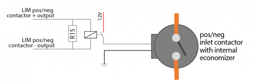

Larger contactor control
If you want to use larger contactors with PWM economizer or dual coil, use small relays to drive them and place a 15 ohm resistor (with heat sink) in parallel with each to simulate the original contactor coil's impedance.
Each of the two 15 ohm resistors must dissipate ~6W @ 13.4V, 50% PWM.
Further investigation is needed to find out if the LIM also detects a contactor failure via the current draw.

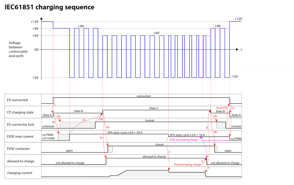

The EVSE (charging station) shares its charging capacity limits via PWM during IEC 61851/ J1772 AC charging, or via PLC during DIN 70121 or ISO 15118 CCS sessions, but often the car cannot handle the max available power of the charging station.
The actual battery voltage and battery current values are needed by the LIM to check the response of the charging station. In this setup, the battery voltage and current are measured by an Isabellenhütte IVT CAN bus sensor, but these values could also be measured and shared on the CAN bus by the BMS. (CAN message 0x112)

The main body is 170mm x 42mm x 104mm. There are 2 mounting brackets with 192mm hole spacing. Total width is 215mm. The connectors on the front have additional 16mm to the main body.
https://openinverter.org/forum/viewtopic.php?p=51061#p51061
LIM versions
Only "LIM_AC_DCO" versions work for CCS. Look for both "LIM_AC_DCO" and a MAC address on the label! If no MAC, the LIM is either AC-only ("LIM_AC") or AC + CHAdeMO ("LIM_AC_DCC"), and not useful for CCS.

Usually the J1772 (US) or IEC61851 (EU) protocol is used for AC charging.
Some new charging stations support AC charging with ISO 15118 high level protocol as well, but it is not confirmed which versions of the LIM support it.
By default, the the EVSE (charging station) outputs +12V on the CP pin, and when connected to an EV will be reduced to 9V because of a load resistor present in the Electric Vehicle; this signals the EVSE that the connector has been plugged into a EV. After this, the EVSE will send a 1khz +12V to ‐12V square wave (PWM signal) and the duty cycle value corresponding to the maximum current it could deliver. If the EV is okay with that value of current, then it performs a handshake by changing the load resistance and dropping the PWM voltage to 6V, after which the charging begins.
In IEC61851, where untethered charging stations are allowed, the PP pin is used to detect the maximum power rating of the cable.
In the US, with J1772, where charging stations need to be tethered, the PP pin is used to detect if the manual unlocking mechanism is pressed, to stop the current flow before the plug is removed.
More information: https://en.wikipedia.org/wiki/SAE_J1772
