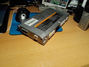

Nissan Leaf BMS
Here we collect information about Nissans BMS.

Different Versions
Their seem to be at least two different versions of the LBC out there, as discovered here: https://openinverter.org/forum/viewtopic.php?f=13&t=370&start=10
The earlier version has only white input headers while the later version has ONE black HV header and a grey low voltage header. We call the first version the "white" BMS and the later version the "grey" BMS.

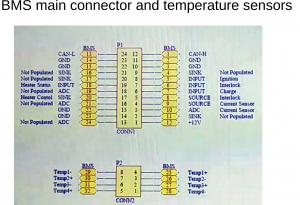

The BMS cannot limit anything, it only measures voltage and current and it will balance the cells 24/7 as long as it receives +12V on pin 5 (BAT) of the round connector, which is wired to pin 12 of the LB11 connector. The BMS will only communicate when there is 12V on either IGN (pin 4 round connector, pin 6 or 7 of LB11, for old/new BMS) or CHG IGN (Charging) which is located on pin 21 or 31 (old/new battery type), pin 5 of LB11. Treated as a black box the main differences are:
- Interlock is between Pin 8 and Pin 21 on white BMS as opposed to Pin 8 and Pin 6 on grey BMS
- Ignition input is on pin 6 on white as opposed to pin 7 on grey
- White BMS expects 4 temperature sensors, grey BMS only 3
- Supposedly the current sensors GND is on Pin 7 but I found Pin 7 internally unconnected and left GND on Pin 15
So if you have a "grey" wiring loom but a white LBC you need to move Pin 6 over to Pin 21 and Pin 7 to Pin 6.

CAN connector pins
Pins for CAN-H and CAN-L and others as identified by wolftronix in the diagram below. Pins are for LB11 and LB12 connectors in Nissan terminology.

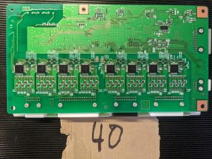

40kWh BMS
The pinout for +12V, CAN-H, CAN-L, Ignition and HV is identical o previous versions.
It uses a daisy chain of MAX17823B for sensing cell voltages.
