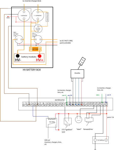

The ZombieVerter controls power/"ignition" signals to other devices (inverters, chargers, and DCDC converters), powering those devices when required. This is done by triggering an external 12V relay. '''''ZombieVerter controls the external relay using low-side switching'', meaning that it pulls the ground pin of the relay to ground.'''
* Pin 32 to ground pin on a 12V relay
* [[File:Gernice-zombie.png|thumb|583x583px|general zombie and battery box wiring]]Pin 32 to ground pin on a 12V relay
* Relay positive pin to 12V+
* One of the relays switch pin to 12V+
Line 177: Line 179:
''Without a proper UDC measurement, the ZombieVerter '''will fail precharge and never go into run mode.'''''
Note the ISA Shunt requires permanent power as it continuously monitors UDC and reports this to the Zombieverter. If powered on with ignition for example, previous UDC readings can affect pre-charge operation.

Wiring
VCU pinout diagram
Each device requires different wiring setups, settings and power requirements.
*cross referencing OEM wiring diagrams is highly recommended

Power wiring
The ZombieVerter requires a permanent 12V supply. This is so it can manage charging, timers, and monitor systems when the car is at rest.
The average power draw, at idle, is 150 mA.
  • Pin 55 to 12V- ground
  • Pin 56 to 12V+ positive
The ZombieVerter controls power/"ignition" signals to other devices (inverters, chargers, and DCDC converters), powering those devices when required. This is done by triggering an external 12V relay. ZombieVerter controls the external relay using low-side switching, meaning that it pulls the ground pin of the relay to ground.
  • general zombie and battery box wiring
  • Relay positive pin to 12V+
  • One of the relays switch pin to 12V+
This effectively provides a switched 12V supply, controlled by the ZombieVerter.
Used to switch "enable" mode to devices via:
  • Leaf inverter enable pin
  • Leaf PDM enable pin
  • Mitsubisihi OBC enable pin
Contactor wiring
The Zombieveter manages the Negative, Positive and PreCharge contactors in an EV conversion.
This is done based off a series of voltage measurements (UDC), this voltage value (UDC) can be supplied from a variety of sources:
  • ISA IVT shunt
  • Nissan leaf inverter
  • BMW S-BOX
  • etc.
Without a proper UDC measurement, the ZombieVerter will fail precharge and never go into run mode.
The contactor control pins on the ZombieVerter are low-side switching, meaning that they pull to ground.
The positive leads from the contactors need to be connected to 12V+ and the ground leads to:
  • Pin 31 for the negative contactor
  • Pin 33 for the positive contactor
  • Pin 34 for the pre-charge contactor
Throttle pedal wiring
The ZombieVerter supports dual-channel throttle. This redundancy is for safety in case one channel fails or drops out. It's highly recommended to use dual-channel throttle. Single-channel is an option.
Connect the following to the ZombieVerter pins:
  • Pin 45 to throttle grounds
  • Pin 46 to throttle channel 2
  • Pin 47 to throttle channel 1
  • Pin 48 to throttle positives
Start, Run, and Direction wiring
The ZombieVerter requires 2 inputs to get into "drive" mode. These pins need to be pulled high (connected to 12V +)
  • Pin 15 to "on" switched input (key switched to "on")
  • Pin 52 to "start" momentary input (momentary key switched "ignition")
Forward and Reverse
  • Pin 53 reverse
  • Pin 54 forward
Brake signal
  • Pin 49 need to be pulled high (connected to 12V +) when brake is pressed
