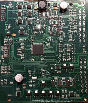

Due to chip shortages (written summer 2021) the board isn't fully assembled so you will need to do some soldering, or take it to a local phone repair shop (or similar) who'll find soldering at this scale like playing with Duplo (Legos to you Yanks).
Name | Part Numer | Alternative Part Number |
CONN1 | ||
IC10 | MCP25625T | |
IC14 | TJA1020 | MCP2004 |
IC19 | NCV7356 | |
IC20 | TJA1055T | |
IC21, IC22 | AD5160 | |
IC27, IC28, IC29 | FAN3122 | MIC4422YM (according to https://openinverter.org/forum/viewtopic.php?p=72827#p72827) |
NOTE : R50 will need to be changed to 1k and C45 to 1n in order for LIN to work properly. This will be amended on further builds. So if you have a board ordered before 14/03/24 this change is required.

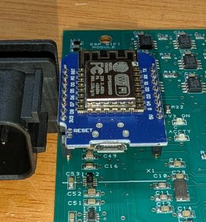

You need to solder the pin header to the Wifi board, and the smaller pin socket to the Zombieverter board. Since they both fit loosely, it's is best to plug the pin header into the pin socket, then set the stacks into the holes on the board, and set the wifi unit on top - getting all the pins into the holes. This will be wobbly and won't sit up straight on it's own. I set a block to the side that both the boards would touch, holding them upright. I then carefully soldered the pins on the wifi unit. The reason you have everything plugged together is to make sure that the pins will perfectly line up with the sockets.
Then turn the Board over, and solder the socket pins to the Zombieverter. Keep the Wifi board plugged in to be sure the sockets stay aligned properly! You'll need to find something to prop up the other side of the Zombieverter board so that it's level.

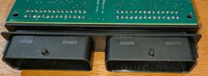

The next step is to solder the big multi-pin connector that hooks to everything else. I bought the Enclosure Kit, which comes with the connectors. Since the connector fits tightly to the board, you just need to carefully sqeeze the board down over the pins, and make sure it's pressed down for the full length of the connector. Then you can just solder all the pins.

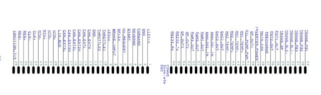

Pin Out Diagrams
Further information for a GS450 system can be found here: Lexus GS450h Drivetrain
Note: Diagrams updated so CAN EXT and CAN EXT2 now match the schematic and web interface.

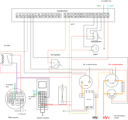

Leaf stack with zombiverter
As of software release V2.20A, the IVT shunt used for UDC data is no longer required for precharge.
The leaf Inverter itself can supply UDC data for precharge (set the Shunt Type = 0)
Tesla SDU with Zombieverter
Notes:
- This drawing is intended to show the minimum components and connections needed for Zombieverter control of an OI SDU via Can bus. Adapting power and Can bus connections for other OI inverters should function in the same manner, but this needs verification.
- All power connections must be fuse protected. Fuses are not shown for simplification.
- The following observations were made using Zombieverter firmware 2.20A and SDU firmware 5.35R:
- The Zombieverter does not enable inverter power prior to entering PreCharge mode. An external device other than the inverter is required to supply the udc measurement for switch to Run mode. This function is supported by the shunt and BMS options available in the Zombieverter parameters.
- A third device must be on the Can bus with the Zombieverter and Inverter.
- Requirements 1. and 2. are satisfied in the drawing by the IVT shunt.
- All devices except the Zombieverter are shown as powered by the ignition switch. Some devices may need to move to permanent 12V supply to support other functions, such as charging.
- An inverter power relay is required for Zombieverter control.
- Can mapping to pass data and commands from the Zombieverter to the inverter is hard coded in the firmware for both devices. Manual mapping is required for the inverter to transmit data to the Zombieverter. The Zombieverter is hard coded to receive this data. The following values need to be manually mapped in the inverter. Note: mapping uses hex address values, multipliers may need to change to provide correct values (confirm in Zombieverter spot values), inverter udc gets mapped to inv udc in the Zombieverter.

- Pump PWM - Limited to GS450 Oil pump pwm or tacho pwm output
These are high side 12v outputs, usually for controlling gauges or auxiliary items than need a pwm signals. They are not suitable for controlling relays.
Ground Input pins
These pins pull down to ground only. Do not connect any voltage to these pins.
PB1
PB2
PB3
Pin functions:
Note: While the web interface will allow input pins to be set to output and vice versa this will not actually work.
- ChaDemoAIw - OUTPUT - used as part of the Chademo charging protocol for the charge allow output to the charger.
- OBCEnable - OUTPUT: activates as part of the ExtCharger module
- HeaterEnable - OUTPUT: activates only in run mode and when coolant pump is on
- RunIndication - OUTPUT: activates when zombie is in run mode
- WarnIndication - OUTPUT
- CoolantPump - OUTPUT: activates during precharge, usually used for coolant pumps
- NegContactor - OUTPUT: activates during precharge for negative contactor
- BrakeLight - OUTPUT: activates when brake input is detected
- ReverseLight - OUTPUT: activates when direction is reverse
- BrakeVacPump DIGITAL OUTPUT: when BrakeVacSensor below threshold this is turned on.
- HeatReq - DIGITAL INPUT
- HVRequest - DIGITAL INPUT - when used with ext charger setting will start precharge cycle and put VCU into charge mode.
- ProxPilot - ANALOGUE INPUT - detect a charging cable plug in, requires external resistors, values depend on type 1 or type 2
- BrakeVacSensor - ANALOGUE INPUT - read a vacuum sensor and turn on the BrakeVacPump DIGITAL OUTPUT
- CoolingFan - OUTPUT: activates when FanTemp setpoint is reached
- HVActive - OUTPUT: activates when contactors are closed and VCU is in run or charge mode
- PWMTim3 -
- CpSpoof - PWM OUTPUT: used to spoof CP signal to OBC if also using a charging interface such as FOCCCI or I3LIM
- GS450Hpump - PWM OUTPUT: used to run GS450H oil pump
