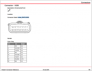

Small Drive Unit ("SDU") Data Connector
Low Voltage Data Connector
Small Front Drive Unit ("SDU") Data Schematic
Housing:
Molex MX150 33472-2002 (key “B”)
Pins:
22 AWG:      Molex 33012-2003
18-20 AWG: Molex 33012-2002
14-16 AWG: Molex 33012-2001
