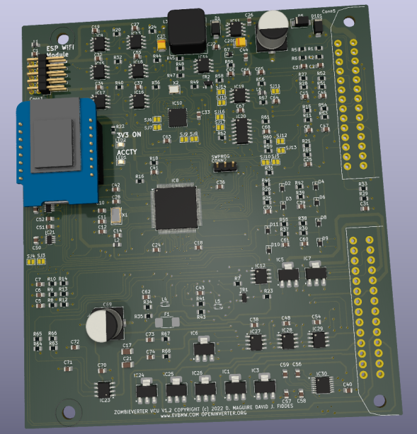

Introduction
Modern EV conversion projects often look to reuse salvaged parts from OEM vehicles, such as the motors, batteries and chargers.
The issue is that each part, and manufacture, use different methods of control and communication. Even when the methods of control are decoded, you are left with having to develop some sort of VCU to run the devices. These devices often talk different "languages", such as CANBUS, LINBUS, sync serial, PWM, etc
Instead of making custom boards for every device that's been decoded, why not just make a general purpose VCU (vehicle control unit) with lots of different types of inputs and outputs?
introducing: the "Zombieverter" VCU
a general purpose EV conversion VCU.
With a large array of inputs/outputs, control logic, and a web interface for configuration and data logging. The Zombieverter is a powerful, flexible and customizable VCU well suited for EV conversions. its also an open source project!

Assembling the VCU
Looking to build a zombiverter VCU your self or your kit has missing hardware?
- Zombiverter hardware page for additional build instructions
the enclosure and header are required if you did not order a fully built board
The enclosure kit options:
The original connectors are from aptiv (delphi):
- aptive 56pin connector
- aptive 56pin header
- Removal tool for connector terminals: Manufacturer: Aptiv (formerly Delphi) Part Number: 210S048

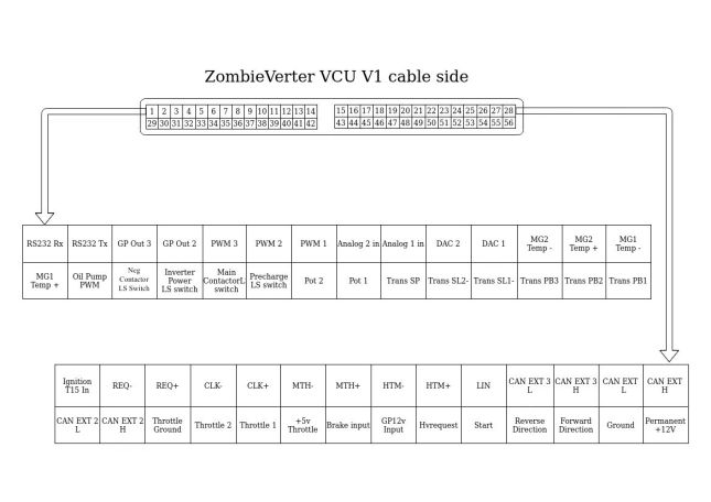

Wiring
each device requires different wiring setups, settings and power requirements.
*cross referencing OEM wiring diagrams is highly recommended
wiring the zombieverter with:

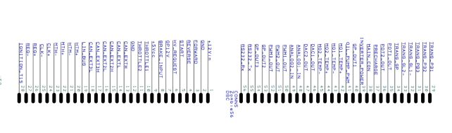

Power wiring:
The zombieverter requires a permanent 12v connection. This is so that it can mange charging, timers, and monitor systems when the car is at rest. The average draw at idle is 150 mA
- pin 55 to 12v- ground
- pin 56 to 12v+ positive
the zombieverter controls power/ "ignition" signals to other devices (inverters, chargers, and dcdc converters) when required. This is done by triggering a external 12v relay. Low-side switching, meaning that it pulls to ground.
- pin 32 to ground pin on a 12v relay
- relay positive pin to 12v+
on the switch side of the realy connect one pin to 12v+ and the other to the enable pin on the device your trying to control.
such as:
- Leaf inverter enable pin
- Leaf PDM enable pin
- Mitsubisihi OBC enable pin
Contactor wiring:
the zombieveter manages the Negative, Positive and PreCharge contactors in a ev conversion. This is done based off a series of voltage measurements (UDC), which can be supplied from a variety of sources:
- ISA IVT shunt
- nissan leaf inverter
- bmw SBOX
with out a proper UDC measurement, the zombieverter will fail precharge and never go into run mode.
The contactor control pins on the zombieverter are low-side switching, meaning that they pull to ground.
The positive leads from the contactors need to be connected to 12v+ and the ground leads to:
- pin 31 for the negative contactor
- pin 33 for the positive contactor
- pin 34 for the pre-charge contactor
Throttle pedal wiring:
The zombieverter supports dual-channel throttle, this redundancy is for safety incase one channel fails or drops out. its highly recommended to use dual channel throttle. single channel is an option.
connect the following to the zombieverter pins:
- pin 45 to throttle grounds
- pin 46 to throttle channel 2
- pin 47 to throttle channel 1
- pin 48 to throttle positives
Start, Run, and Direction wiring:
The zombieverter requires 2 inputs to get into "drive" mode. These pins need to be pulled high (connected to 12v +)
- pin 15 to "on" switched input (key switched to "on")
- pin 52 to "start" momentary input (momentary key switched "ignition")
Forward and Reverse:
- pin 53 reverse
- pin 54 forward
