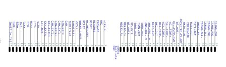

Wiring
VCU pinout diagram
zombieverter pinout from https://github.com/damienmaguire/Stm32-vcu/blob/master/Hardware/Zombie/ZombieVerter_V1%20-%20Schematic.pdf
each device requires different wiring setups, settings and power requirements.

Input/output pins:
The Zombieverter has a number of selectable input/output pins that can be used for a number of functions. These pins are:
Low side Outputs.
  • GP Out 3
  • GP Out 2
  • Neg Contactor switch/GP Out 1
  • Trans SL1- (If not using the GS450H)
  • TransSL2- (If not using the GS450H)
*Low side output connect to ground when activated.
The low side outputs in Zombie are ideal for switching relays, such as for coolant pumps.
High side PWM.
  • PWM 3
  • PWM 2
  • PWM 1
  • Pump PWM - Limited to GS450 Oil pump pwm or tacho pwm output
These are high side 12v outputs, usually for controlling gauges or auxiliary items than need a pwm signals.
*not suitable for controlling relays.
Ground Input pins
These pins pull down to ground only. Do not connect any voltage to these pins.
PB1
PB2
PB3
Pin functions:
