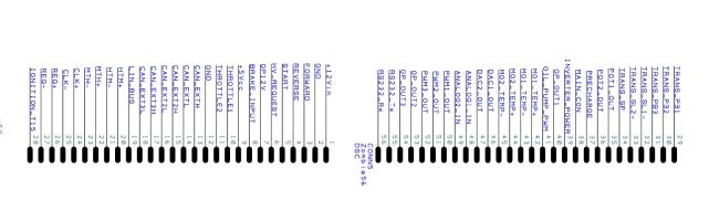

Wiring
Pin Out Diagrams:
Leaf stack with zombiverter
Tesla SDU with Zombieverter
