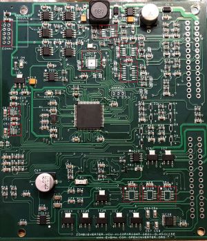

Based around the original design of the open inverter platform, the zombieVerter consists of 2 main parts:
- a web interface
- a communication protocol

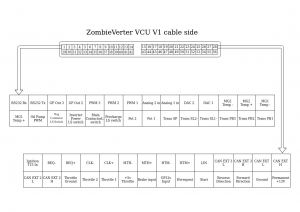

Pin Out Diagrams
GS450H with zombieverter
Further information for a GS450 system can be found here: Lexus GS450h Drivetrain
Note: Diagrams updated so CAN EXT and CAN EXT2 now match the schematic and web interface.

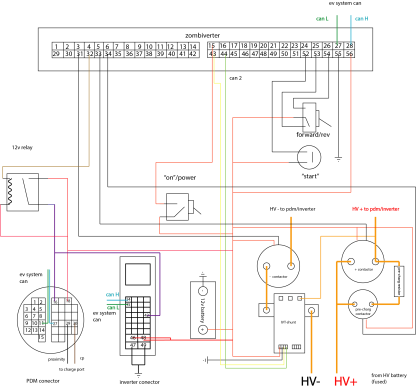

Leaf stack with zombiverter

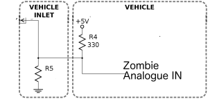

Proximity Pilot
This analogue input used to detect a charging cable is plugged in.
A resistor to the 5v needs to be connected to the analogue in pin, 330 ohms in the spec, and R5 needs to be another resistor between analogue in pin and ground. Type 1 connectors should be a 2.7k ohm resistor and type 2 should be 4.7k ohm. Note the charging port may already have this resistor installed.
Open up the Zombie UI and choose ProxPilot for the function of the analogue in pin. Then start plotting PPVal and then plug in, you can then use this to select your PPThreshold. Bare in mind the resistance will vary on the cable plugged in depending on the Amps it can supply.
https://www.youtube.com/watch?v=U3c4V8vMb6k Video here for the setup and demonstration.
