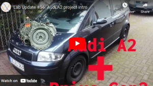

Audi A2 with Prius Inverter

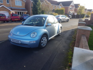

VW Beetle 2003 EV conversion
