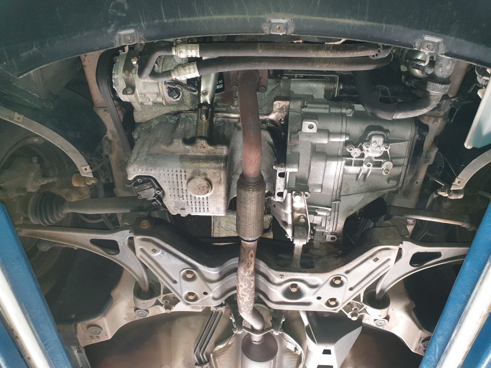

A friend of mine will attempt to convert his Audi A2.

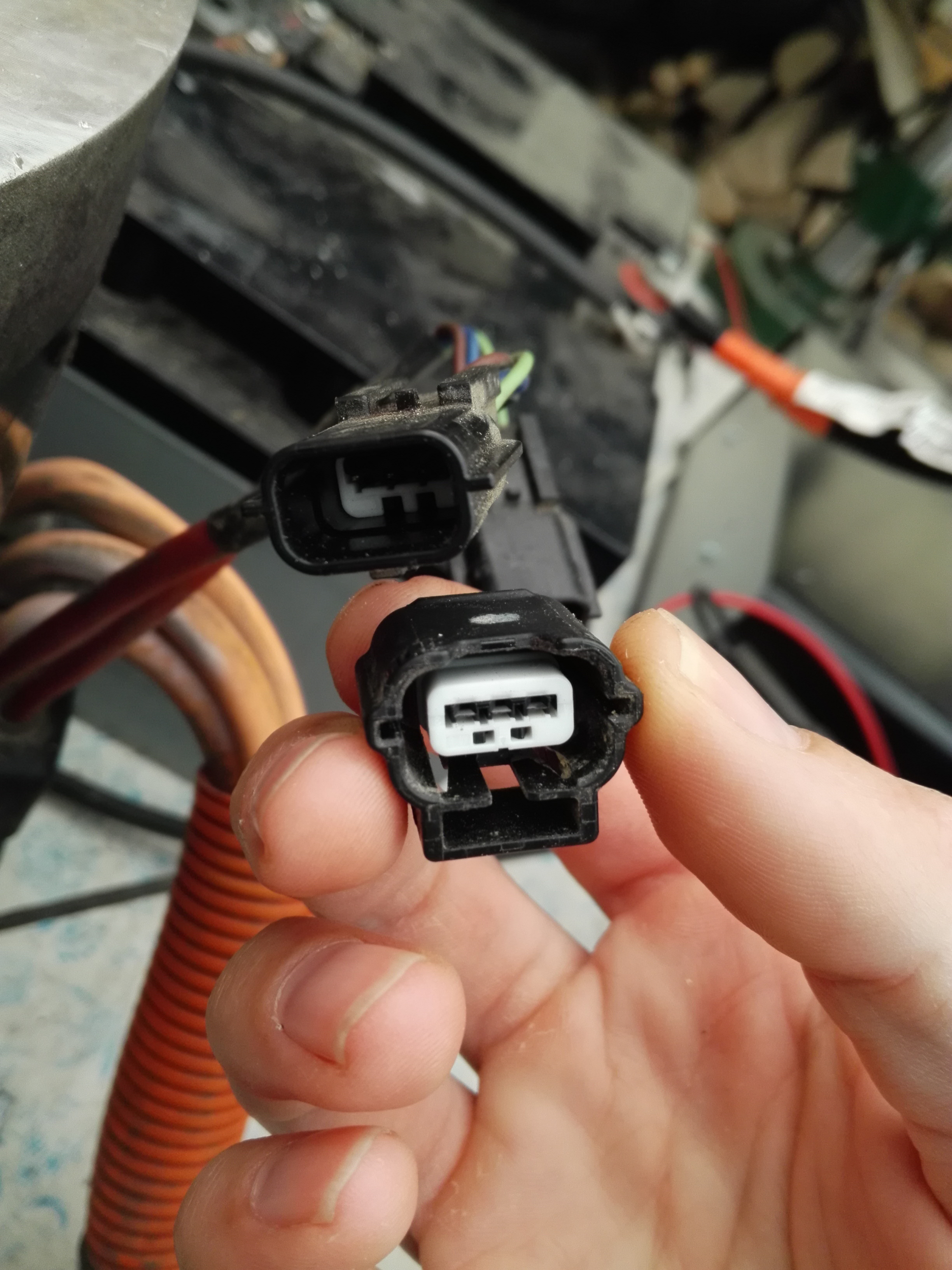

I would also like to use the DC/DC converter and the auxiliary inverter for an A/C compressor. They sit at the bottom of the inverter. Is there any info on these?

I think you asked a couple months ago about the DC/DC and someone gave you a pinout at least...
*digs around*
viewtopic.php?p=4550#p4550 -- There maybe?
And, I noted there last time that I thought Damien had reverse engineered the DC/DC already as a battery charger. But I haven't seen any details of it or how to replicate that other than his proof of concept.
I haven't heard of anyone tackling the aux inverter yet.I would also like to use the DC/DC converter and the auxiliary inverter for an A/C compressor. They sit at the bottom of the inverter. Is there any info on these?

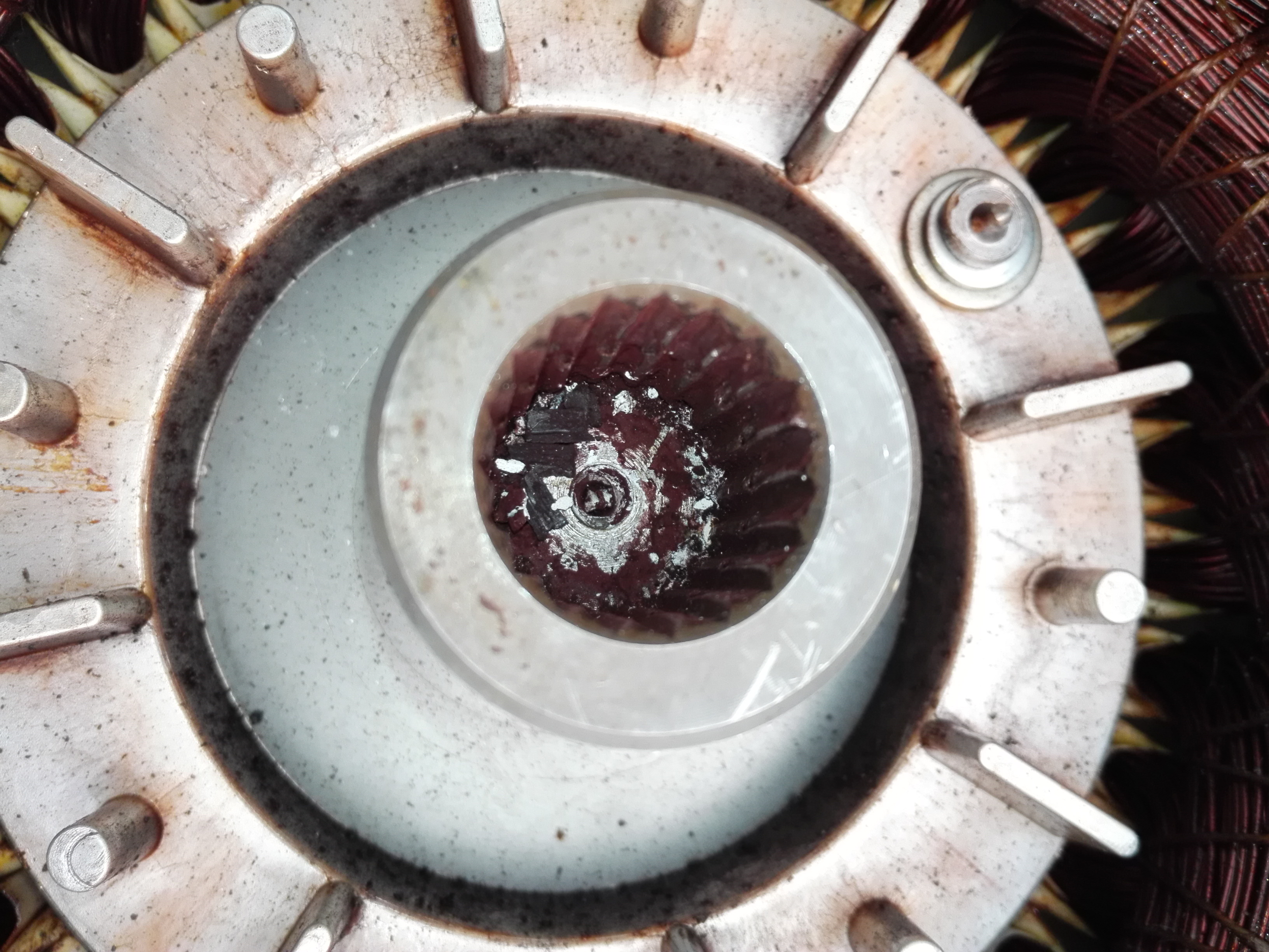

I already bought that motor a few months ago for 280€ so we will make an effort to use it.
I found the splined hub as a replacement part on ebay, so apparently it can be removed and replaced by something fitter.

All this conversion have in common that there were debates what to do with the axial load from the clutch. It can be like 40kg load when shifting etc... My first reaction was then you simply not use the clutch and shift like i do here... https://mazdamx3ev.wordpress.com/2018/0 ... lopka-ven/
The motor i was discussing has two ball bearings and they support weight of the shaft radially, but that kind of bearing also supports some load from the axial side. So it should not be a problem to ask a machinist to get you bearings with good seat to ward of some axial loads.
Did you dissassemble the motor yet? Can you send me some photo of bearing retention system in the front?
I also asked some of those cars drivers and their reply was to just use the plate on transmission housing and mount the motor to it. No bearing needs to be adapted. Make good effort to allign the center, but really clutch remains.
Well today i had conversation with Marjan and he said you need to keep the clutch. When at low RPM motor does not have enough pull and if you remain in 2nd gear some steep hill may be against your torque. Then you need to shift to 1st gear and go... If not you are stuck an have to stop since most 1st gears are not synchronised to be used from 2nd to 1st. Basically from his experience you ned to drive it with high RPM.
My motor has enough torque to pull from 5th, so i dont have that problem.
He absolutely advocates to mackine out the flywheel so you remove its countertorque when in regen.

Thanks for offering to fund this project. The need to change down to 1st gear on inclines really makes me think twice whether this motor is a good choice.
