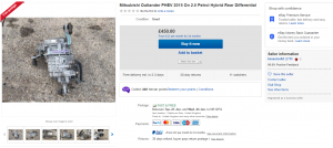

Example Ebay Listing:

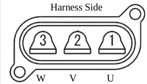

High Voltage
3x 3 phase lug connections with HV gland plate[2]

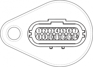

Signal Connector
Resolver/Temperature sensor: Hirose GT18WB-14DS-HU
Resolver Connector Colours/Resistance:
R12 - 35,5R Black, White
S13 - 86,4R Green, Red
S24 - 78,5R Yelow, Blue
The polarity of all six wires have to be correct in order for the motor to work.
Resolver/Temperature sensor OEM cable/harness part number: 8556A131 (can be used as a source for the connector if stock of the Hirose connector isn't available)
Pinout of Resolver/Temperature Sensor connector:
| Pin | Label | Description |
| 1 | N/A | Not used |
| 2 | TG2 | Temperature sensor 2 ground |
| 3 | TG1 | Temperature sensor 1 ground |
| 4 | RGND | Resolver ground |
| 5 | S4 | Cos connection |
| 6 | S3 | Sin connection |
| 7 | R2 | Exciter connection |
| 8 | N/A | Not used |
| 9 | TH2 | Temperature sensor 2 |
| 10 | TH1 | Temperature sensor 1 |
| 11 | N/A | Not used |
| 12 | S2 | Cos connection |
| 13 | S1 | Sin connection |
| 14 | R1 | Exciter connection |

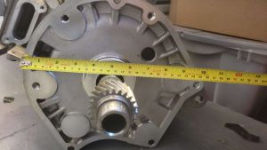

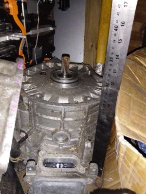

Mechanical Dimensions
Outer Dimensions
