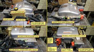

Prius Gen 2 Inverter Montage

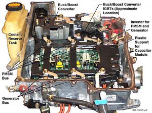

Internal look at the Prius Gen2 Inverter

The Gen2 Prius (2004-2009 model years) has a variety of useful components inside the inverter package:
  • 2 high power inverters, for the 2 motors MG1 (starter) capable of handling 250 amps, and MG2 (drive motor) capable of handling 350 amps.
  • A DC-DC converter to provide 12v and up to 100amps power supply to the automotive systems and accessories.
  • A tertiary power inverter to run the A/C, CAN controlled via the "BEAN" (????) network
  • A boost module to boost the 200v battery pack up to 500v, which looks to be able to function as a battery charger (wish list for future development)

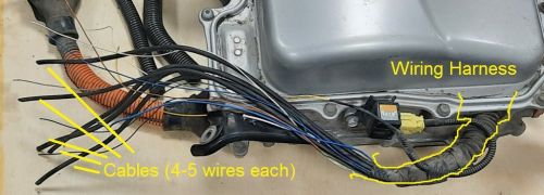

Re-purposing a Prius Gen2 Inverter outside of a Prius is done simply with add-on controllers that replace the vehicle's wiring harness and ECU.

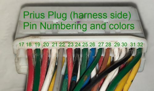

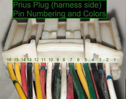

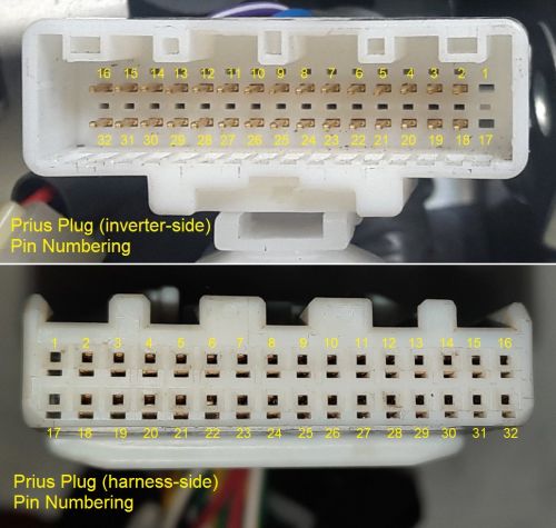

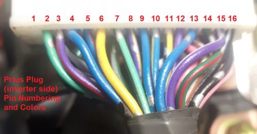

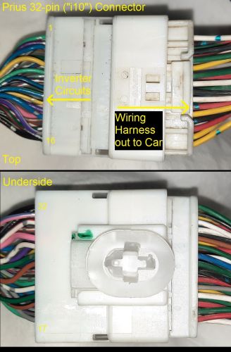

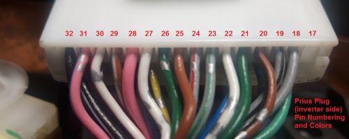

32-pin Prius Inverter Pin mapping
Note: Wire colors on the male/female side of the 32-pin "i10" connector do not match. The inverter-side plug uses an almost unique color scheme, but the wiring harness side reuses many colors - unique only to a given shielded cable (of which there are 5), plus some extra unbundled wires. To save time chasing wires, you can find anything in the same bundle, and know the rest by noting which other colors are in that cable. There are also a few loose wires not bundled into a cable or shielded.

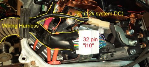

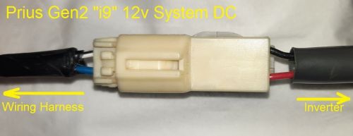

Note 2: The 12v supply rail for the "i9" connector also changes color at the wiring harness. The thicker blue loose wire is positive, the thick loose white-black wire is the ground.
Note 3: There is also an enclosure safety connector, this is the thin blue loose wire on the wiring harness.
32-pin Prius Inverter Pin Numbering
32-pin Prius Harness Pin Numbering
32-pin Prius Inverter Colors
32-pin Prius Inverter Harness Connections
32-pin Prius Inverter i9 12v DC
32-pin Prius Inverter Harness Cables
Pin # Designation Description Wire Color
(Inverter Side)
(See pictures to the right)
Wire Color
(Harness Side)
1 vacant
2 GIVA MG1 Phase Current V LightGreen White - Cable 1
3 GIVB MG1 Phase Current V Purple-Red Black - Cable 1
4 GUU MG1 PWM U - Speed Signal Wave Blue Black - Cable 2
5 GVU MG1 PWM V - Speed Signal Wave Blue-Red Green - Cable 2
6 GWU MG1 PWM W - Speed Signal Wave Yellow Yellow - Cable 2
7 MIVA MG2 Phase Current V LightGreen-Black Green - Cable 3
8 MIVB MG2 Phase Current V Purple-Yellow White - Cable 3
9 MUU MG2 PWM U - Speed Signal Wave Blue-Black Black - Cable 4
10 MVU MG2 PWM V - Speed Signal Wave Blue-Yellow White - Cable 4
11 MWU MG2 PWM W - Speed Signal Wave Yellow-Black Red - Cable 4
12 VH Inverter Capacitor Voltage Purple Yellow - Cable 3
13 CPWM Boost converter PWM switch signal Blue Black - Cable 5
14 CT Boost converter temperature sensor Green-Red Red - Cable 5
15 VL Boost converter input voltage Purple-White Yellow - Cable 5
16 GINV Inverter Ground Black-White Yellow - Cable 4
17 vacant
18 GIWA MG1 Phase Current W Grey Red - Cable 1
19 GIWB MG1 Phase Current W Grey-Black Green - Cable 1
20 GSDN MG1 Shutdown Brown-Black Red - Cable 2
21 GIVT MG1 Inverter Temperature Green-Black White - Cable 2
22 GFIV MG1 Inverter Fail White-Grey Grey
23 MIWA MG2 Phase Current W Grey-Green Red - Cable 3
24 MIWB MG2 Phase Current W Grey-Red Black - Cable 3
25 MSDN MG2 Shutdown Brown Green - Cable 4
26 MIVT MG2 Inverter Temperature Green Light Blue - Cable 4
27 MFIV MG2 Inverter Fail White Green
28 OVH Overvoltage Pink Brown
29 CSDN Boost converter shutdown signal Brown-White White - Cable 5
30 FCV Boost converter fail signal White-Red White
31 OVL Boost converter over voltage signal Pink-Blue Black
32 GCNV Boost converter ground Black-Red Green - Cable 5

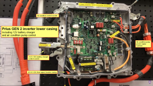

DC-DC Converter
Prius gen 2 inverter lower casing internals
Prius Gen2 DC-DC connections.

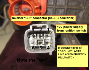

DC-DC converter "C 5" connector
The onboard DC-DC Converter is powered by the high voltage traction battery to supply 12v and up to 100A for low-voltage automotive components and 12 battery maintenance, equivalent to an alternator or generator. Direct control of the converter is simple, only one 12v wire connected to Pin#1 of connector "C5" is necessary to activate it, but a second input can be added at Pin#4, to enhance control.
All 6-pin connectors are Yazaki 7283-7062-40, including the resolver connections on the transaxle.
The 6-pin "C5" connector terminal positions and harness-side colors:
1 IGCT 12v+ Blue
2 ID1 Not Needed Purple
3 S B+ (opt) White
4 NODD 0-5v+ Ppl/Gld
5 VLO Not Needed Blue
6 Vacant
The case of the inverter must be vehicle ground (12v battery negative terminal), just as an alternator or generator would be.
With the HV bus energized and switched 12v applied to Pin#1 of "C5", the DC-DC will produce 13.2-15.2 Vdc on the large C6 single-conductor connector nearby, which is equivalent to a 12v alternator/generator positive terminal. Depending on voltage applied to pin 4 (if used), output can be tailored; when grounded, it will act as a "KILL" input and DC-DC output will drop to zero. No base load is required to produce voltage.
Note: The output at C6 (large grey connector) is not internally fused and not disabled unless power to Pin#1 of C5 is off, or Pin#4 is grounded, but the DC-DC converter can only produce output when the HV bus is energized.
Note on Limitations - The DC-DC system is not designed to charge up a low 12v battery and certainly not one that's completely dead, doing so can damage the inverter/converter. Pin#1 can be tied directly to the same ignition switch signal as the control board receives as this circuit draws only about 6.3mA.
A/C Inverter
The onboard A/C inverter is powered by the high voltage traction battery to supply 3 phase power to the A/C pump. It's controlled by a propriety SPI like 12v interface.
