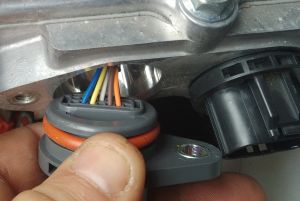

Interfaces 1x Resolver/Motor Temperature sensor interface
Hirose GT18WB-14DP-HU - 14 way proprietary connector[4][5]
Black 1x 12V Power/CAN Bus Interface
Hirose GT18WB-14P-HU - 14 way proprietary connector
Grey
1x DC Bus Input - M10 Bolts with gland plate
1x 30A Fused DC Bus Junction Output - M10 Bolts with gland plate
1x 3 Phase motor output - M10 Bolts with gland plate
Mechanical Mounting 3x Lugs around lower face, M10 bolts multiple locations[6]

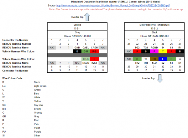

Pinout of Outlander Rear Motor Inverter Controller
Outlander REMCU Pinout/Interface Connections. Also downloadable as .XLSX and .ODS format for your own use. Please update here if you find any errata!
Wiring diagram to the right.
It would appear that there are 4 unused pins on the Vehicle Connector (D-211).
IGCT - ECU control power supply voltage
IGCT appears to be main ignition control relay - 12V
This is the supply voltage for the REMCU and should be supplied with battery voltage when turned on.
RSDN - REMCU shut-down signal
RSDN is a signal from the PHEV-ECU and is referred to as "REMCU shut-down signal" as part of the "Rear Motor Shutdown Circuit". It seems to be the equivalent of the MSDN signal from the PHEV-ECU to the Front Motor Controller. The RSDN signal could be used as a safety circuit. In normal operation, it should be pulled to low (1V or less).[11]
CAEH & CAEL - CAN Communication
Standard CAN bus, Baudrate 500KBaud??
[Note: The CAN is NOT terminated]

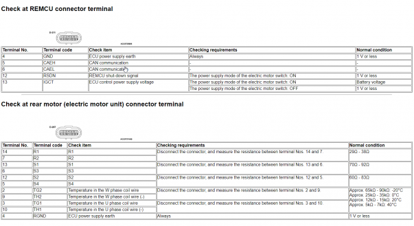

Diagnostic Codes [12]
P1048 - Rear motor shutdown circuit [13]
The PHEV-ECU stores diagnosis code No. P1048 when the rear motor shut down circuit fails.
Check the wiring harness between PHEV-ECU (RSDN terminal) connector and the rear EMCU (RSDN terminal) connector.

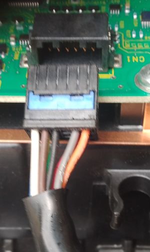

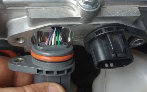

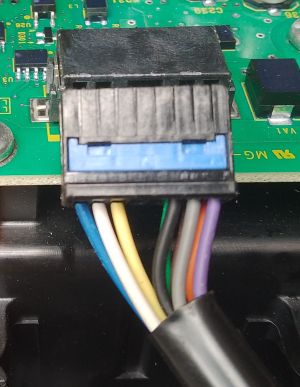

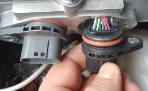

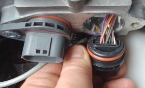

Inverter Resolver & Can Connector
The original Connectors:
1x Resolver/Motor Temperature sensor interface [Hirose GT18WB-14DP-HU - 14 way proprietary connector[4][5]] - Black
1x 12V Power/CAN Bus Interface [Hirose GT18WB-14P-HU - 14 way proprietary connector] - Grey
These connectors are unobtainable however Tom DeBree has created a 3d printable connector that utilises TE Pins and Dupont style connector:
https://openinverter.org/forum/viewtopic.php?t=682&start=75
It must be noted Chinese Dupont connectors are not good for much more than testing as they are not a good Fit.
It is recommended to use original motor to inverter cable for an easy life, however if you need to make up a cable or are splicing into the cable due to damaged socket etc, it is important to note that the motor will spin backwards if it runs forward or has a noticeable judder when trying to set off under load (see https://www.youtube.com/watch?v=6fq3Y90fYY8) it is very likely that the polarity of the resolver pairs maybe incorrect. (additional note: increasing "throtramp" in zombie can introduce a judder at low rpms).

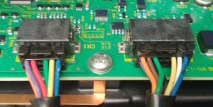

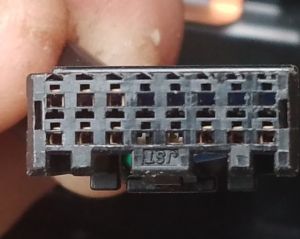

The internal PCB connectors are JST CPT-series, 2.0 mm pitch:
  • 12-pin cable housing: 12CPT-B-2A
  • 16-pin cable housing: 16CPT-B-2A
  • Crimp terminal: SCPT-A021GF-0.5
The matching PCB-mounted headers are:
  • 12-pin: SM12B-CPTK-1A-TB
  • 16-pin: SM16B-CPTK-1A-TB
