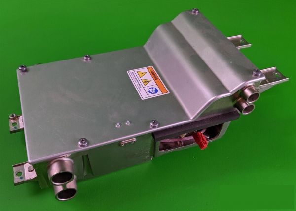

The Tesla Model S GEN1 Rear HVJB (TPN 1016561-00-A) was a High Voltage Junction Box found in the all 2012 through late 2013 Model S. It is centrally located under the rear seat frame, and the Single or Dual GEN1 On-board Charger(s) (OBC) are located to the right and left of it. It was replaced via gradual phase-in by the GEN2 Rear HVJB starting around Oct2013, when the GEN2 On-board Chargers were introduced; the GEN1 & GEN2 Rear HVJBs are not interchangeable, neither physically nor electrically.
It functions as a junction for connections to these subsystems:
  • Traction Battery Pack (HV DC)
  • Drive Unit ("Inverter") (rear only, as the Dual Motor option wasn't offered during the GEN1's lifespan)
  • Charge Port (AC and DC input)
  • DC-DC Converter (GEN1, which also functioned as the Front HVJB, until GEN2, about Jan2014)
  • On-Board Charger(s) (GEN1 Chargers only)

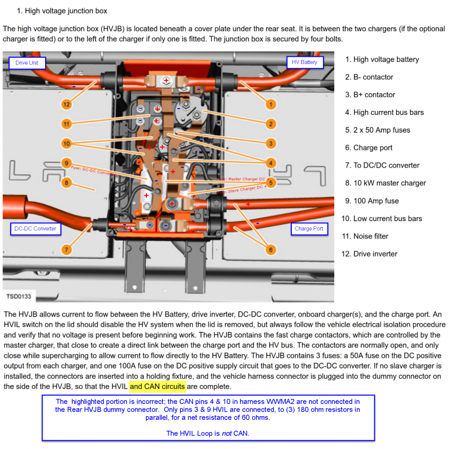

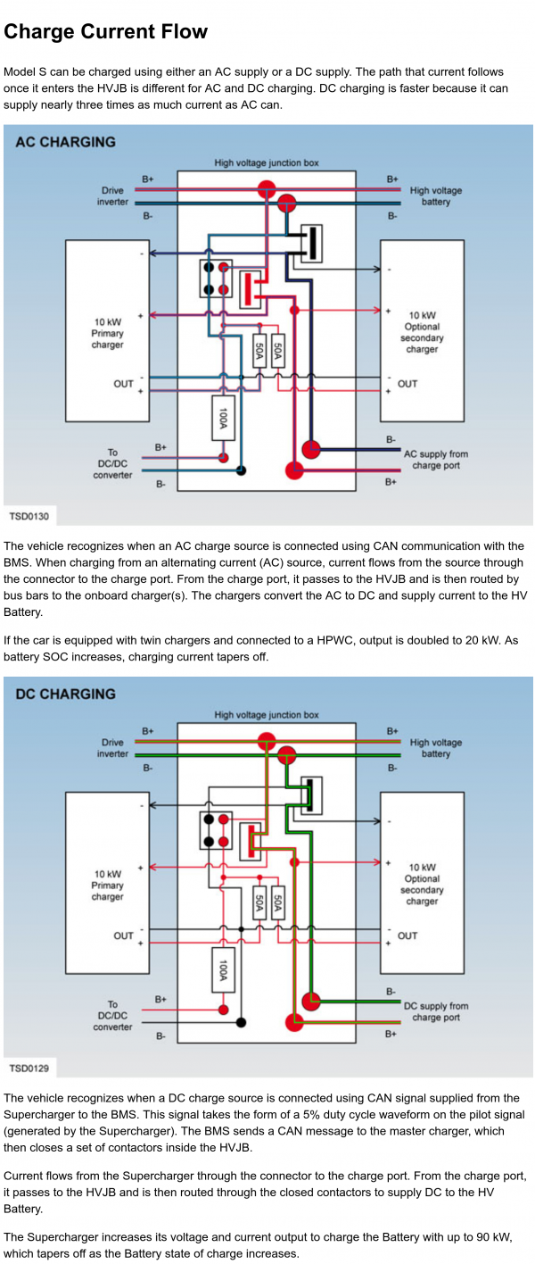

HV
All HV connections are well documented by the "Theory of Operation" image below. All are bolted connections.
Tesla Model S GEN1 Rear HVJB operating prinicple, from early Tesla Model S Service Manual, Theory of Operation Guide.
Tesla Model S GEN1 Rear HVJB component details, from Tesla Service Manual, "Theory of Operation" section.

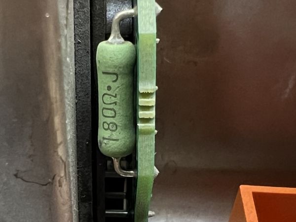

It has a small PCB soldered to its rear, which contains ONLY (3) 180 ohm resistors, wired in parallel, to provide a net 60 ohm path for the HVIL Loop, on pins 3 & 9. See HVIL section for details on how this connector is used.
The following images showcase this "parking" connector on the Rear HVJB for harness WWMA2, which if not connected to a Second/Slave OBC, must be connected to this "parking" connector in order to obtain a 60 ohm resistor to complete the HVIL loop. The BMS maintains a constant current in the HVIL loop and measures the voltage drop associated with that current level. It will not allow the contactors to close (or remain closed) if the correct resistance isn't measured in the HVIL loop[1]. Telsa's various documentation from this era have several inaccuracies when verified against actual vehicles; do not rely upon documented pinouts.
Telsa Model S GEN1 Rear HVJB: harness WWMA2 "parking" connector which contains only a 60 ohm resistor. This connector is used when a Tesla does not have a Second/Slave OBC.
Telsa Model S GEN1 Rear HVJB: front view of harness WWMA2 "parking" connector which contains only a 60 ohm resistor.  This connector is used when a Tesla does not have a Second/Slave OBC.
Telsa Model S GEN1 Rear HVJB: rear views of harness WWMA2 "parking" connector which contains only a 60 ohm resistor.  This connector is used when a Tesla does not have a Second/Slave OBC.
Telsa Model S GEN1 Rear HVJB: rear view of harness WWMA2 "parking" connector which contains only a 60 ohm net resistance.  This connector is used when a Tesla does not have a Second/Slave OBC.
Tesla Model S GEN1 Rear HVJB "parking" connector for harness WWMA2, used in Single OBC installations only. Note (3) 180 ohm resistors, connected in parallel, to obtain net 60 ohms for HVIL loop.
180 ohm resistor. One of three on the Tesla Model S GEN1 Rear HVJB "parking" connector for harness WWMA2, which is used only in Single OBC installations.

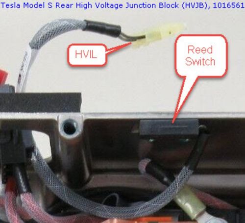

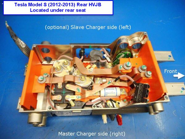

Like other HV assemblies on the Model S, the Rear HVJB has a Lid Reed Switch, activated by a magnet on the cover, that breaks the HVIL Loop when the cover is removed. The Rear HVJB has a short harness from this Lid Reed Switch, which is always plugged into the Single or Master OBC to maintain the HVIL Loop.
HVIL Lid Reed Switch
The below two pictures show the GEN1 Rear HVJB's Lid Reed Switch, which had a relatively high failure rate[2] that caused shutdowns, error messages, and start failures:
Tesla Model S GEN1 HVJB (under rear seat), lid removed, showing the HVIL cover reed switch and HVIL connector that connects to a mating connector on the OBC.
Tesla Model S GEN1 Rear HVJB (under rear seat), lid removed, showing the HVIL cover reed switch and HVIL connector that connects to a mating connector on the OBC.
Closeup of Tesla Model S GEN1 HVJB (under rear seat), lid removed, showing the HVIL cover reed switch and HVIL connector that connects to a mating connector on the OBC.

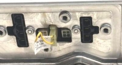

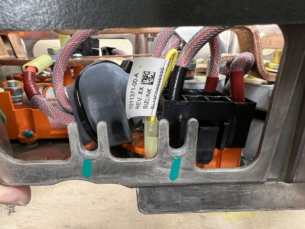

HVIL Loopback Harness
Tesla Model S, HVIL Loopback Harness 1101371-00-A (single yellow wire), installed. Tesla: used only on Second/Slave OBC. RAV4 EV & B250e: used on only OBC.
Tesla: The loopback harness, Tesla 1101371-00-A, is included/stored inside all Tesla Model S GEN1 Rear HVJB in an internal "parking" socket, when only a single OBC is provisioned. See Other Parked Connectors below for location image. When an Second/Slave OBC is installed, the HVIL Loopback Harness is removed from its internal parking connector and installed on the Second/Slave OBC.

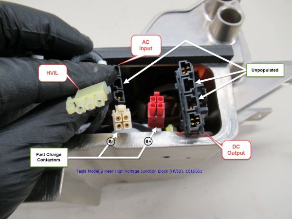

Fast Charge Contactors Control

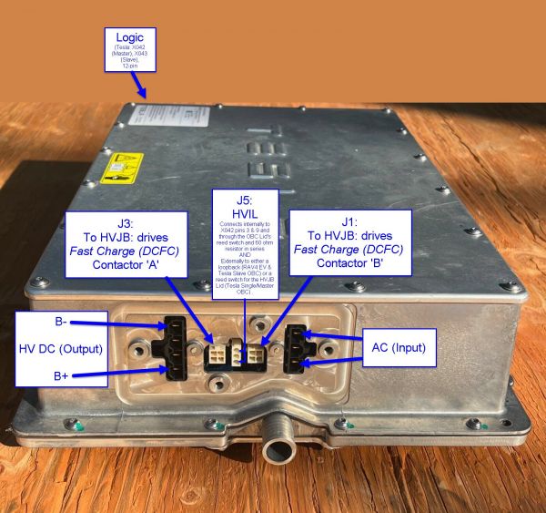

Tesla Model S GEN1 OBC Connectors, to which the GEN1 Rear HVJB's side harnesses mate.
Tesla Model S GEN1 OBC Connectors (closeup of the Fast Charge Contactors Control and HVIL) to which the GEN1 Rear HVJB's side harnesses mate.
Tesla Model S Rear HVJB: Single/Master OBC interface connectors. All (5) of these are in use for the Single/Master OBC; only the AC and DC connectors are in use for a Second/Slave OBC (no HVIL or Fast Charge Connectors are used for the Second/Slave OBC).
These four-pin connectors each route to a single contactor in the Rear HVJB. Those contactors bypass AC charging and allow DC from the Charge Port to connect directly to the HV bus for DCFC.
  • These two connectors are physically interchangeable.
    • One has a red plastic connector, and connects to the B+ contactor.
    • One has a white plastic connector, and connects to the B- contactor.
  • It is not known if the OBC performs PWM economizing. The Rear HVJB Fast Charge contactors are Tesla 1006871-00-A (TE Connectivity 2138957-2), but no datasheet can be found.
  • The top row pins are 12v; the bottom row pins are Auxiliary contacts, NO (normally open). These harness' black wires are for the contactors' coils, and the white wires are for the NO auxiliary contacts.

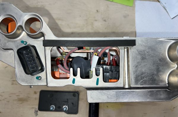

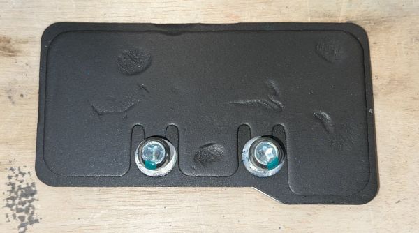

Tesla Model S GEN1 Rear HVJB: left side blanking plate, used when a Single OBC is installed.  Removed when a Second/Slave OBC is installed, which will use parked connectors behind this plate.
Tesla Model S GEN1 Rear HVJB: left side OBC port, open when a Second/Slave OBC is installed.
Tesla Model S GEN1 Rear HVJB: (3) parked connectors for Second/Slave OBC: HVIL Loopback Harness (yellow wire), and AC/DC Connectors (to the right).
When a Tesla Model S is configured for Single OBC, several connectors that are not used are "parked" and can be used for installing a Second/Slave OBC later. There are three internally-parked connectors, which are parked inside the HVJB, left side, behind a blanking plate. These internally parked connectors are:
  • AC Input (to Second/Slave OBC)
  • DC Output (from Second/Slave OBC)
  • HVIL Loopback Harness (for installation on Second/Slave OBC, and on all Toyota RAV4 EV and MB B250e OBCs)
There is one externally-parked HVIL harness, see Logic "dummy" Connector above.
