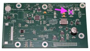

Missing IC4 Chip
According to this forum post, IC4 used to be populated with a USB to serial FTDI chip. However, on the latest boards, all settings are configured via wifi so it is no longer needed.
Image of Tesla Gen2 charger board with missing IC4 chip
