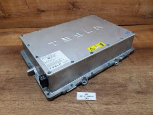

Tesla GEN1 Onboard AC Charger
Tesla Gen1 Onboard AC Charger. Note the stamped "TESLA" on the cover, which visually distinguishes it from later versions. This view shows the Logic Connector X042/X043
The Tesla Gen1 on-board AC charger (OBC) was a single phase 10kW AC charger that was fitted originally and primarily in the Tesla Model S, from Jun2012 through late2013*, when it was replaced with Gen2. Gen1 models are easy to identify, having the word "TESLA" stamped on the top metalwork and having no black anti-tamper tape; the Gen2 charger lacks the Tesla identifier stamped on the metalwork, and has anti-tamper tape over the seams.
One (or optionally two, in a Master/Slave configuration) Gen1 chargers are installed beneath the rear seats in the Model S for AC charging. The Single/Master OBC is on the right side of center. If two OBCs are fitted, the Second/Slave is fitted to the left of center under the rear seat; both are identical hardware, though the firmware differs.
The charger is comprised of (three 3.3 kw modules?), each mounted to a liquid-cooled heat sink that forms the base. This assembly enables single phase AC charging only.
The Gen1 chargers are considered to be more trouble-prone than the later units, and are not as popular for use in EV conversions or ground-up builds, partly because they do not support 3-phase AC input. However, they are used in many OEM installations that continue to need servicing. Examples of OEM installs include Telsa (all 2012-Sep2013 Model S), Toyota (all 2012-14 RAV4 EV[1]), and Mercedes-Benz (initially "Electric Drive", later "B250e"[2], 2014-15?**). As far as is known, these are identical from a hardware perspective[3], but the firmware differs and is not interchangeable between installations.

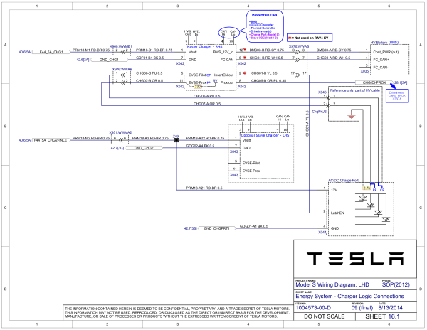

Logic Connector (X042 or X043)
Tesla Model S GEN1 OBC Logic Connector X042 Wiring. Tesla wiring diagrams do not define all circuits for a connector. This diagram has been amended to include circuits from other pages, to completely describe X042.
Tesla Model S Gen1 OBC Logic Connector X042 Wiring, from Service Manual sheet 16.1.  Tesla wiring diagrams do not define all circuits for a connector; this diagram has been amended to include circuits from other sheets 24.2 (HVIL) & 38.1 (CAN), to completely describe X042.

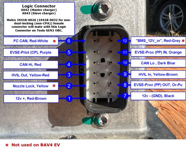

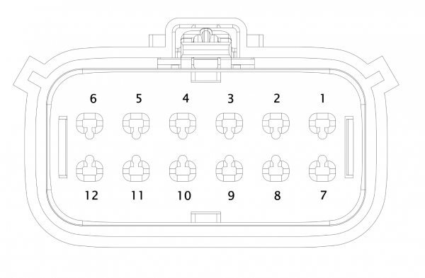

Tesla Model S GEN1 OBC X042 Logic Connector pinout.
Tesla Model S Gen1 OBC X042 Logic Connector pinout.

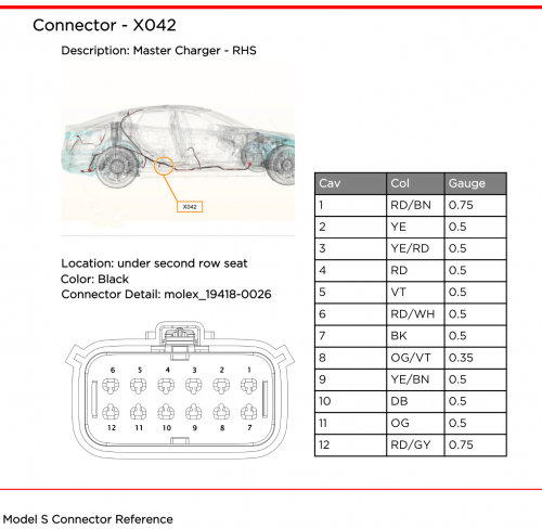

For Logic Connector X042 (X043, when referred to when provisioned in "Slave" duty, D4 in the Toyota RAV4 EV), the mating connector needed to plug into the charger is Molex 19418-0026[7] for 18-22 AWG (19418-0027 for 14-16 AWG) which is in the MX150L series. This connector features CPA[8] (Connector Position Assurance), a dual-locking feature. For bench-testing, etc., the non-CPA connector is Molex 19418-0038[9] for 18-22 AWG (19418-0037 for 14-16 AWG); this connector requires one less operation to disengage, but is less suitable for automotive use or environments where heavy vibration is present.
Telsa Model S (2012-2013) OBC Logic Connector X042 details, from Tesla Service Manual.
Logic Connector X042 (Master charger) and X043 (Slave charger). Molex 19418-0026, female harness connector to mate with X042 Logic Connector on Tesla Gen1 OBC.
Logic Connector X042, Master charger, and X043, Slave charger. Molex 19418-0026, female connector to mate with X042 Logic Connector on Tesla GEN1 OBC.
Molex 19418-0026, female harness-side connector to mate with X042 (male terminals) Logic Connector on Tesla Gen1 OBC (Logic Connector X042 (Master charger) and X043 (Slave charger)). This is the terminals-end view of the housing.

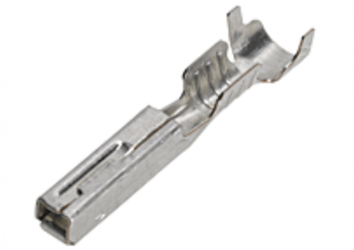

The female terminals for this housing are Molex 19420-0010[10] (18-22 AWG; 19420-0009 for 14-16 AWG). These are tin-plated, and are rated for (25) cycles. Gold-plated versions are available, and they are rated for (100) cycles.
Molex 19420-0010 female terminals for Logic Connector X042, for 18-22 AWG (0.35-0.75mm²).
Pin No. Function Description Tesla
Wire size *
Telsa
Wire Color *
1 12v supply 18 AWG (0.75mm²) RD-BR
2 ** Charge Port: nozzle lock "InsertEN out" 20 AWG (0.5mm²) YL
3 HVIL Out 20 AWG (0.5mm²) YL-RD
4 CAN + 20 AWG (0.5mm²) RD
5 EVSE-Pilot (CP) 20 AWG (0.5mm²) PU
6 ** Fast Charge CAN "FC_CAN". Possibly SWCAN. Connects only to BMS "FC_CAN+" 20 AWG (0.5mm²) RD-WH
7 12v GND 20 AWG (0.5mm²) BK
8 EVSE-Prox (PP) OUT PP signal from EVSE to Drive Unit. Marked "Prox out" on Tesla's documentation, this was thought to be a "inhibit drive" signal, but testing has been inconclusive/negative for that function so far. 22 AWG (0.35mm²) OR-PU
9 HVIL In 20 AWG (0.5mm²) YL-BR
10 CAN - 20 AWG (0.5mm²) DB
11 EVSE-Prox (PP) IN PP signal from EVSE to OBC 20 AWG (0.5mm²) OR
12 ** "BMS_12V_in" "Cont_PWR (out)" (Contactor power?) from BMS (BMS enables DCFC contactors?) 18 AWG (0.75mm²) RD-GY
* = Specifications are from 2012 Tesla Model S documentation; other applications may have differing specs.
** = Not used on RAV4 EV.

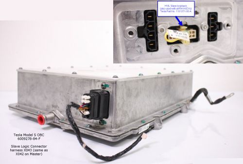

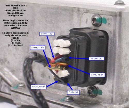

Logic Connector when configured as Second/Slave OBC
When an OBC is provisioned as a Second OBC ("Slave"), the Logic connector is populated with a subset of the above, as the First OBC ("Master") handles all external interfaces. Only power/GND, CAN, and HVIL are connected.
Tesla GEN1 OBC: "Slave" configuration Logic and HVIL connections.
Tesla Gen1 OBC: "Slave" configuration Logic and HVIL connections.
When the vehicle is configured for a Single OBC only, the Second/Slave Logic harness WWMA2 is parked in a "dummy" connector on the Rear HVJB. That connector does nothing, except that it contains 60 ohm resistance on pins 3 & 9, for the HVIL Loop. It does not contain CAN termination. For more information, see Tesla Model S GEN1 Rear HVJB, Logic "dummy" connector.
Tesla Model S OBC in Single/Master configuration. Note "parked" harness WWMA2 on Rear HVJB.

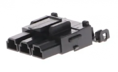

AC Input Connector
The Power Input/Output connectors are of the Molex Mini-Fit Sr. wire-to-wire series[11]. The datasheet is here.
The AC Input Connector housing needed to plug into the charger is Molex 42816-0312[12]
Molex 42816-0312 housing, 3P, for DC Output.

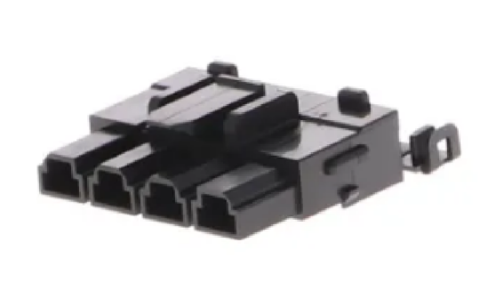

DC Output Connector
The DC Output Connector housing needed to plug into the charger is Molex 42816-0412[13]
Molex 42816-0412 housing, 4P, for AC Input.

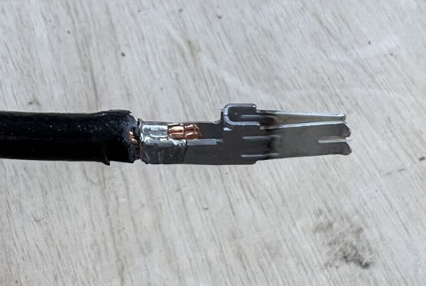

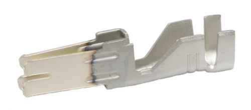

The female terminals for the Power Input/Output housings are Molex 42815-0134[14] for 8 AWG (8mm²). However, the tool to crimp an open barrel terminal in 8 AWG practically only exists as the Molex 2002188700[15], which is very expensive (>USD$680 (Apr2023)). Carefully consider this when ordering. One approach is to cut off the insulation crimp section from the rear of the terminal, then carefully use a crimp tool die that is designed for 10 AWG, being careful to not over-crimp.
Molex 8 AWG open barrel terminal, modified by removing the rear insulation crimp section, then crimped using Pressmaster MCT and die 4300-3146, using the 10 AWG position.
The Molex datasheet strongly recommends the use of Nylogel 760G dielectric grease on this terminal if it will be exposed to vibration and/or thermal cycling[16]. However, this applies only to terminals with tin plating[17], and it is unknown whether the terminals used by Tesla are tin-, silver-, or gold-plated.
Molex 42815-0134 female terminal, for 8AWG (8mm²) wire.
Soldering this terminal is strongly discouraged.

HVIL (J5): Only the outside pins (top and bottom) are in use. These are used to integrate the HVJB's Lid Reed Switch into the HVIL loop. Every OBC contains a 60 ohm resistor in series with its Lid Switch (added to 2014 Wiring Diagram above, included by Tesla in Service Bulletin SB-10052449-4313, 2015), between Logic Connector (X042/X043) pin 3 and HVIL connector "top pin".
  • Tesla: Connected to the HVJB's Lid Reed Switch if the OBC is the only (single) or Master (dual) OBC. If the OBC is configured as Second/Slave, a loopback harness is connected instead.
  • Tesla: The loopback harness, Tesla 1101371-00-A, is included/stored inside all Tesla Model S Gen1 Rear HVJB in an internal "parking" socket, when only a single OBC is provisioned.
  • Toyota: A loopback harness is always connected.
  • MB: TBD (probably a loopback harness is connected).
Loopback harness installed (Tesla: Second/Slave OBC only; Toyota: All):
Tesla Model S GEN1 OBC HVIL Loopback connector. Used on Tesla Slave OBC installations where the HVJB Lid Reed Switch is already connected to the HVIL circuit via the Master OBC. Also used in RAV4 EV, as there is no HVJB installed at all in those models.
Tesla Model S Gen1 OBC HVIL Loopback connector.  Used on Tesla Slave OBC installations where the HVJB Lid Reed Switch is already connected to the HVIL circuit via the Master OBC.  Also used in RAV4 EV, as there is no HVJB installed at all in those models.

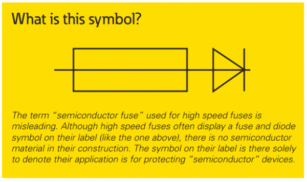

These fuses are "semiconductor protection fuses" and are "very fast acting"[21]. The Eaton Bussman (Cooper) units are imprinted with the common diode symbol that represents semiconductor fuses, and it does not imply that the fuse has a diode function.
Eaton Bussmann FWH-50B semiconductor fuses are fast-blow to protect sensitive components. This fuse is reported to be a replacement for OEM Ferraz Shawmut A50P50-4
Semiconductor fuses may have a diode symbol imprinted, but this does not imply that the fuse functions as a diode.
Eaton Bussmann (Cooper) FWH-50B, showing the diode electrical symbol which indicates that it's a semiconductor fuse (very fast acting).
