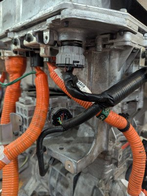

I'm planning on using a Zombieverter with a used 110kW Leaf motor, 2020. PDU Model 292C0 5SA1B (A3 ?), EM57 316386Z
On the https://openinverter.org/wiki/Leaf_stac ... ombiverter page, it shows several connector pinouts for the Leaf Motor - which I can't see how they match with what I see on my motor.
I can identify the 12v +/-, J1772, Pack, CHaDemo connectors.
I don't see how the other connectors correspond to F13, F14, and F18. ( 2 big round ones on my motor, and several small ones.)
I can't seem to find any source for a 2020 Leaf Service manual either.

F14 is the resolver connector on the motor can, near the coolant lines.
The others are different because the wiki is showing connectors for a gen2 system and you have gen3. The round one connecting to the inverter is the equivalent to the rectangular one (F13) on the wiki.

Ahh, fun. Anyone have the pinouts for a Gen3 set of connectors?

https://photos.app.goo.gl/mfgp9rkYvGKA6XPQ9
Make sure you're looking at the connections from the right direction.
Delete the .txt at the end, it's a pdf.
2021_nissan_leaf_Network_diagram-1.pdf.txt
(19.57 MiB) Downloaded 520 times

The pictures WiKi show Leaf 80 kW, you have Leaf 110 kW, it has different connectors and different can traffic.
