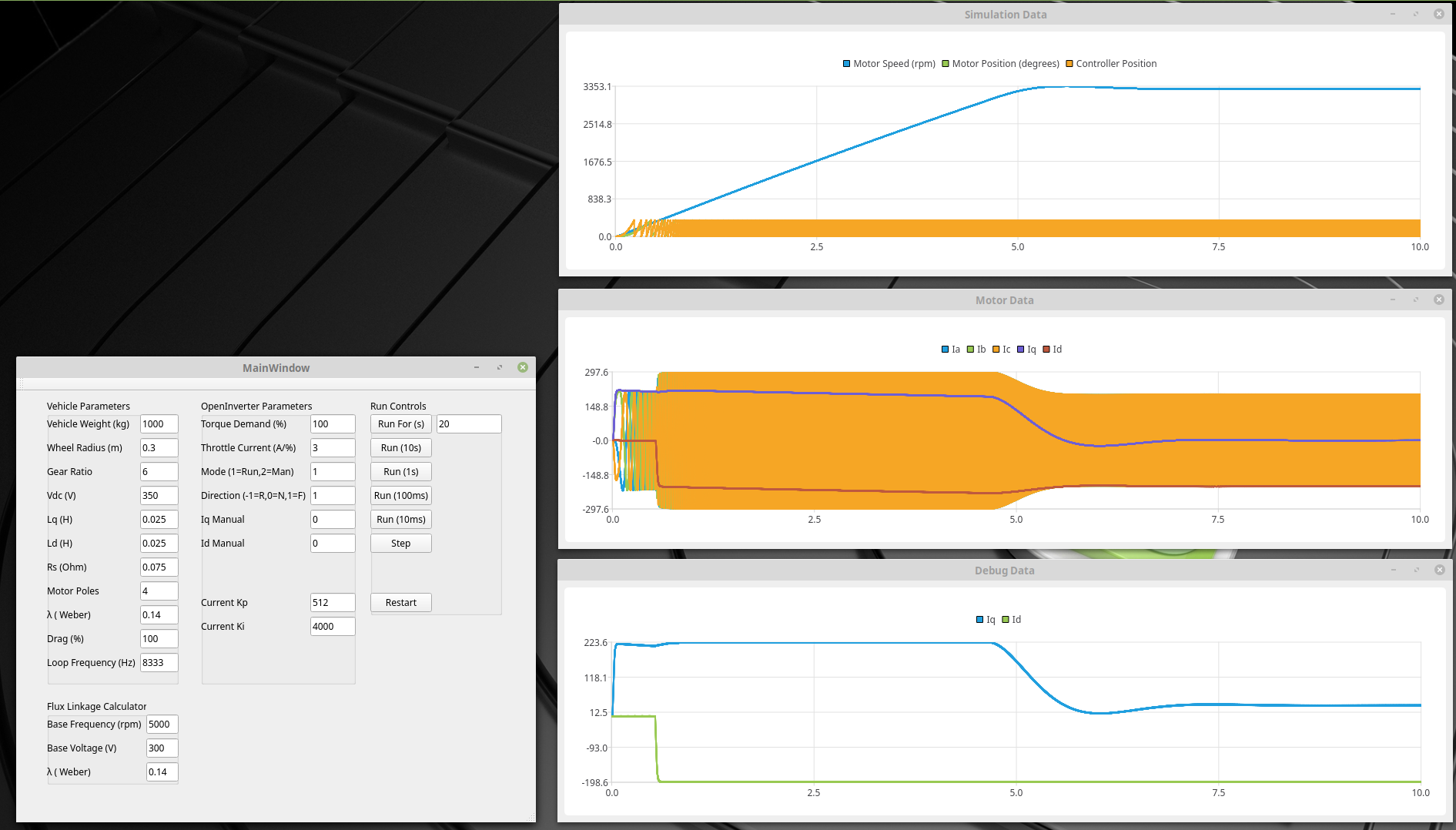

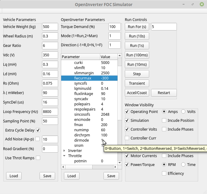

Post by Pete9008 »

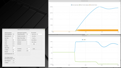

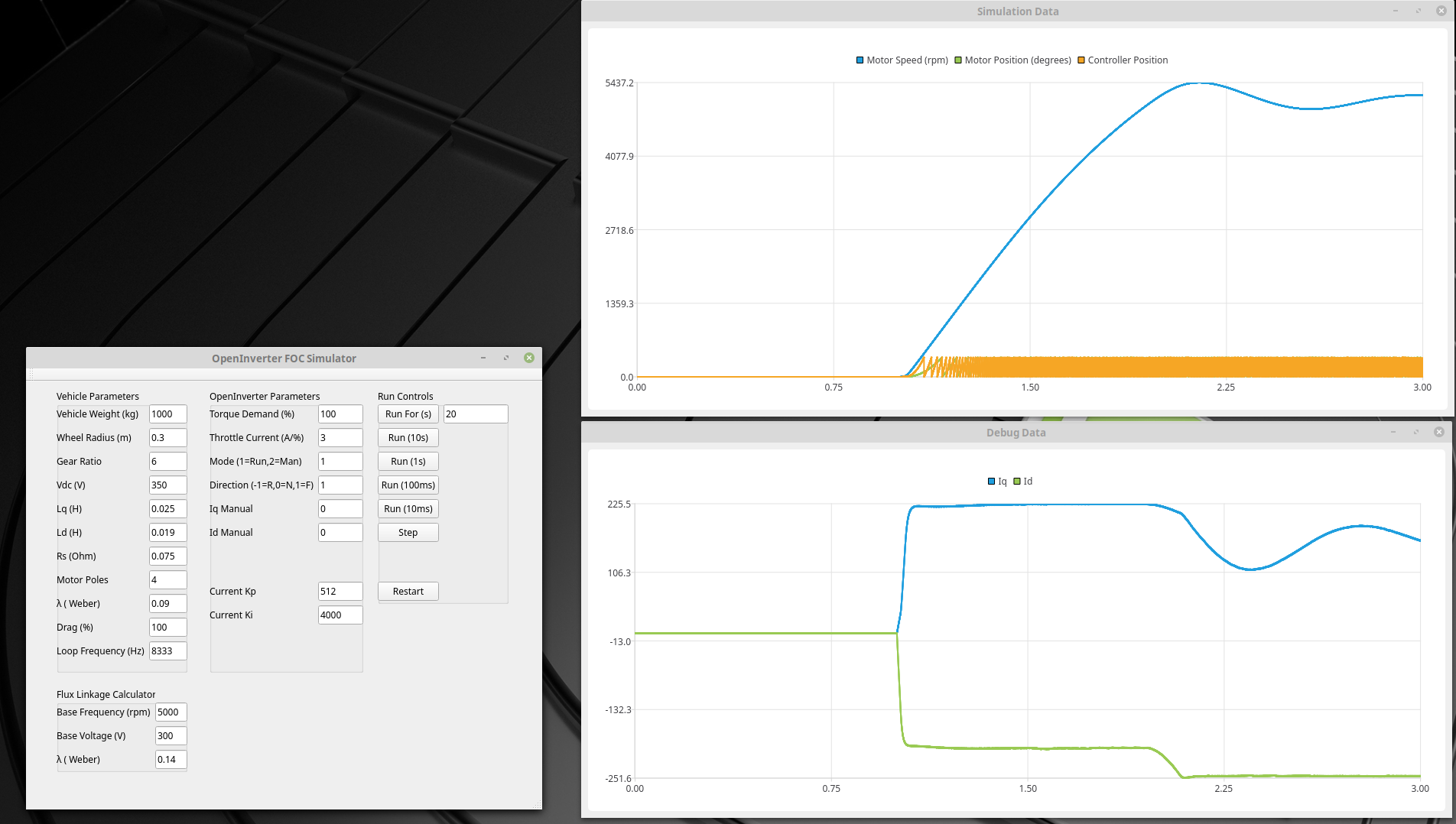

Thanks, not got as far as I'd hoped this afternoon and haven't managed to look at integrating the OpenInverter code yet. Fixed a couple of bugs in the model but mainly been fighting with Qt graphs; they were taking over a minute to render a seconds worth of simulation! Eventually found the problem was that it was re-rendering the graph as each point was added - changed it to only render complete blocks and it's fine now (renders 10sec worth of data in a couple of seconds - may become a problem again as more lines are added though).
This is where it is currently at:
The control windows allows the model parameters to be set and control running the simulation. It currently pops up two windows, one for motor current and one for motor speed. This simulation is just starting with a motor spinning at 3600rpm feeding into a 1R load and watching how it spins down - it looks fairly sensible. Changing the parameters and load resistance change things in sensible ways which is promising.
Currently it doesn't do anything about core saturation (the simulation gives 18000A into a short circuit!), the drag parameter doesn't do anything and I've just realised that I've forgotten to take account of the number of motor poles.
Also bear in mind that I don't know what I'm doing here and so am currently treating this as a learning exercise. I definitely wouldn't trust this model to base any important decisions on but am hoping that it will be good enough to help understand what might be happening during the transition into and out of field weakening.
Also not too sure how useful it might be for MTPA as I'm not to sure how to calculate the magnitude of the reluctance torque to allow it to be included. Any ideas how to do this?

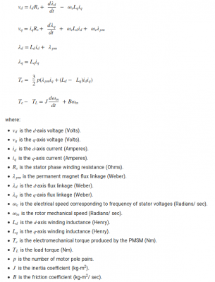

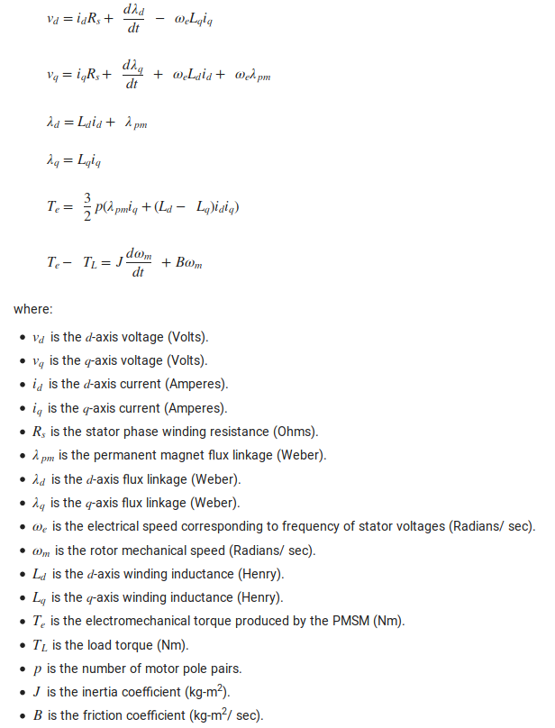

Been doing a little more reading on the maths for motors and have come to the conclusion that while the model I have at the moment is probably good enough for investigating field weakening it 's more or less useless for MTPA. Looking at a couple of posts from @bexander led to here https://se.mathworks.com/help/mcb/ref/m ... rence.html and in particular this:
At the moment my simulation just uses the first two terms of each of the first two equations (or rather it will once I add motor resistance). I don't really understand the significance of the last two terms but I'm guessing they represent cross coupling between the d and q fluxes and so model the bits needed for MTPA simulations. Without these adding the reluctance torque term is probably a waste of time.
The problem is I need to calculate Id and Iq for a given Vd and Vq so the above equations are the wrong way round. What I need is the top two equations rearranging to give Id and Iq for a given Vd and Vq. Once upon a time I might have been able to do this but currently it's beyond me so could anyone help?
Also an explanation of what the extra terms are doing would be great too, I don't like using equations without understanding them!
Edit - Looking again I am including the ωλpm term assuming that's the BEMF?

Could someone please tell me what I'm missing here?
Using this equation from above:
and the following values (combination of @bexander 's measurements and general values off the web):
p = 4
Lq=6mH
Ld=2mH
Flux linkage= 0.13Weber
Iq = 250A
Id = 0A
Gives a torque of 195Nm - seems reasonable.
With Iq or 240A and Id of -70A gives 590nM - would be nice but sounds unrealistic!
With Iq or 175A and Id of -175A gives 890nM - really???
I've seen articles suggesting a 14-40% increase in torque for MTPA but nothing like this - what am I missing?

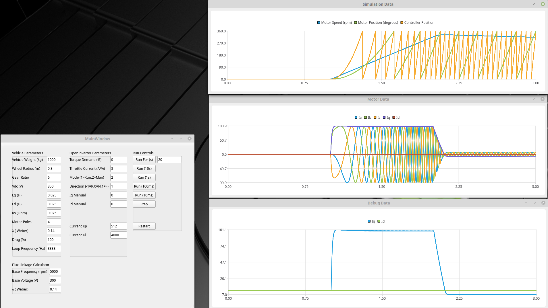

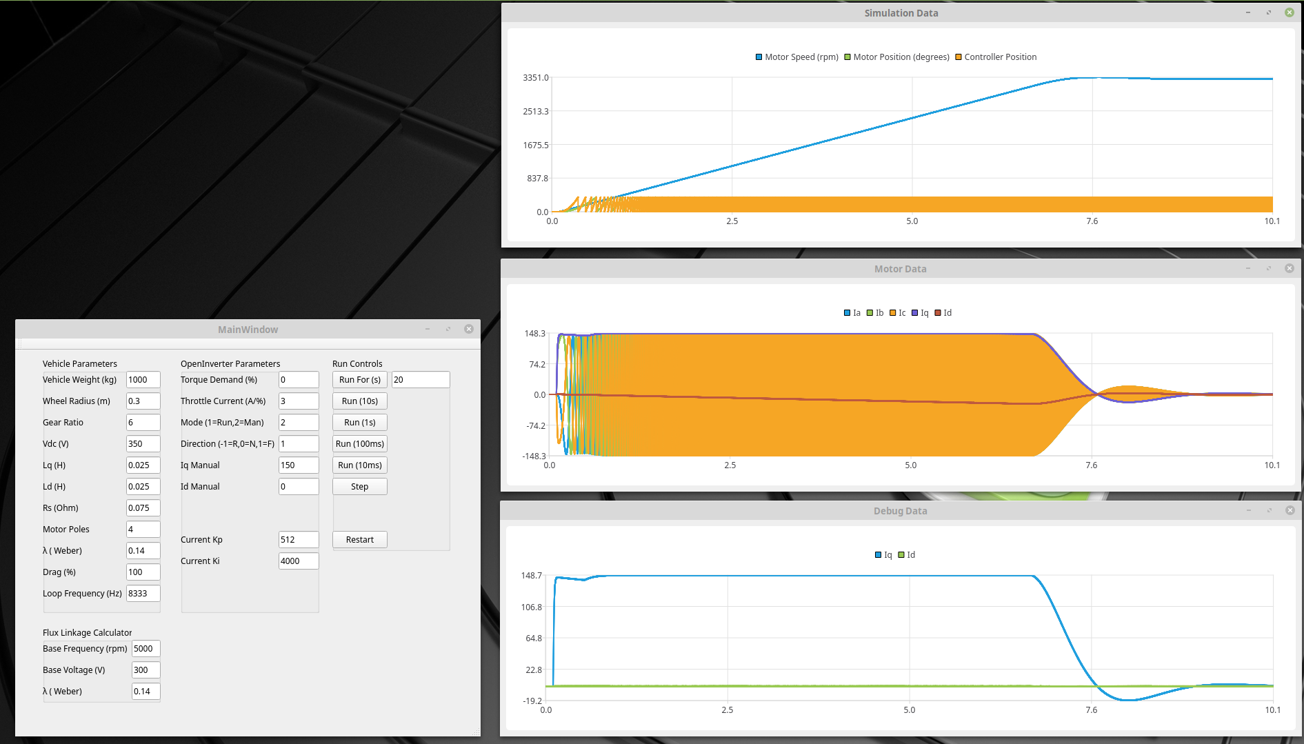

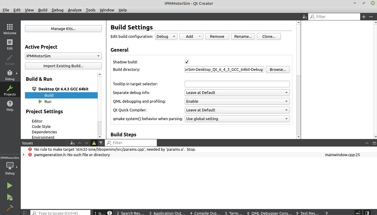

The OpenInverter code is now integrated into the simulation and is moving the motor (not properly though, just oscillating). Hopefully I just need to sort out the scaling going in and out, get all the pole pair settings so they match and get the phase offsets aligned for it to start doing something more sensible. Then it's a case of adding controls to the GUI for the important parameters before being able to run some tests.
I've had to modify the PwmGeneration source files which I was hoping to avoid doing as it makes switching to different code versions more difficult. Once it's working I'll need to go back and write a lot more test stubs to try and use the unmodified files. The main problem I had is I just can't get my head round the way you have written the anain class, the implementation is very elegant but just beyond my C++ skills. Any suggestion of how to write a test stub for it would be welcome.
Pete9008
Posts: 1801
Has thanked: 102 times
Been thanked: 351 times
Post by Pete9008 »

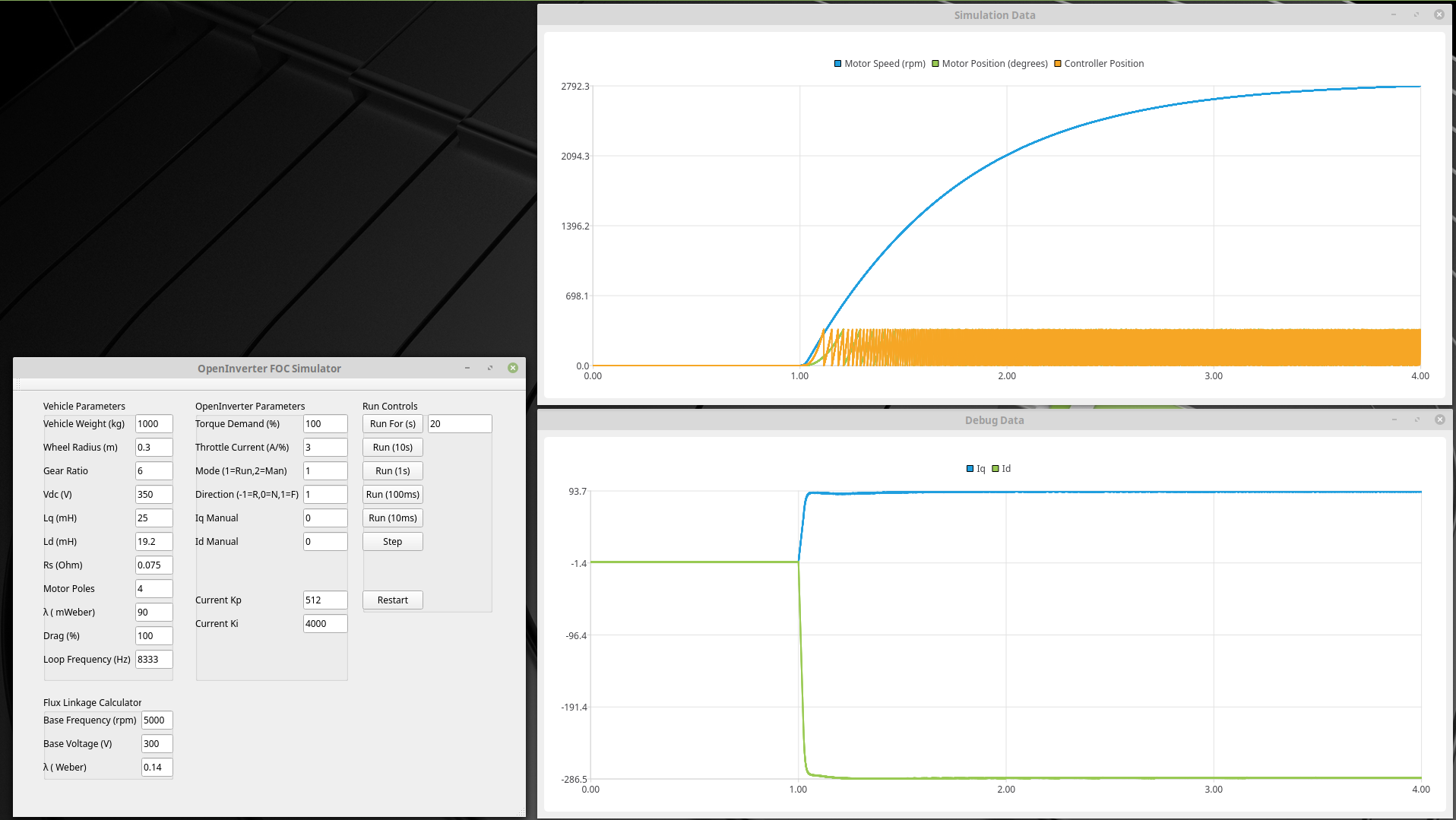

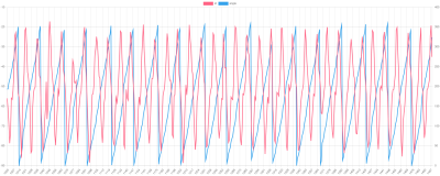

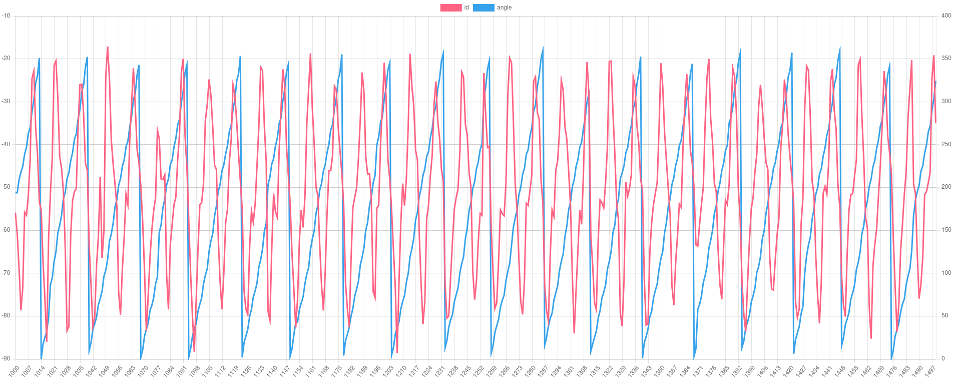

Getting closer but the control loops aren't doing quite what I expect.

The simulation seems to be working :D
I've ended up messing about with the OpenInverter source code more than I intended to while trying to figure out the problem so it will need a fair bit of tidying up. In then end most of it was understanding the scaling and fixed point stuff - must have tried every wrong combination before finding the right one.
First capture, just a simple transient test in manual mode with a command of 100A Q current:
This is with the PI gains from the standard parameters. After tuning it:

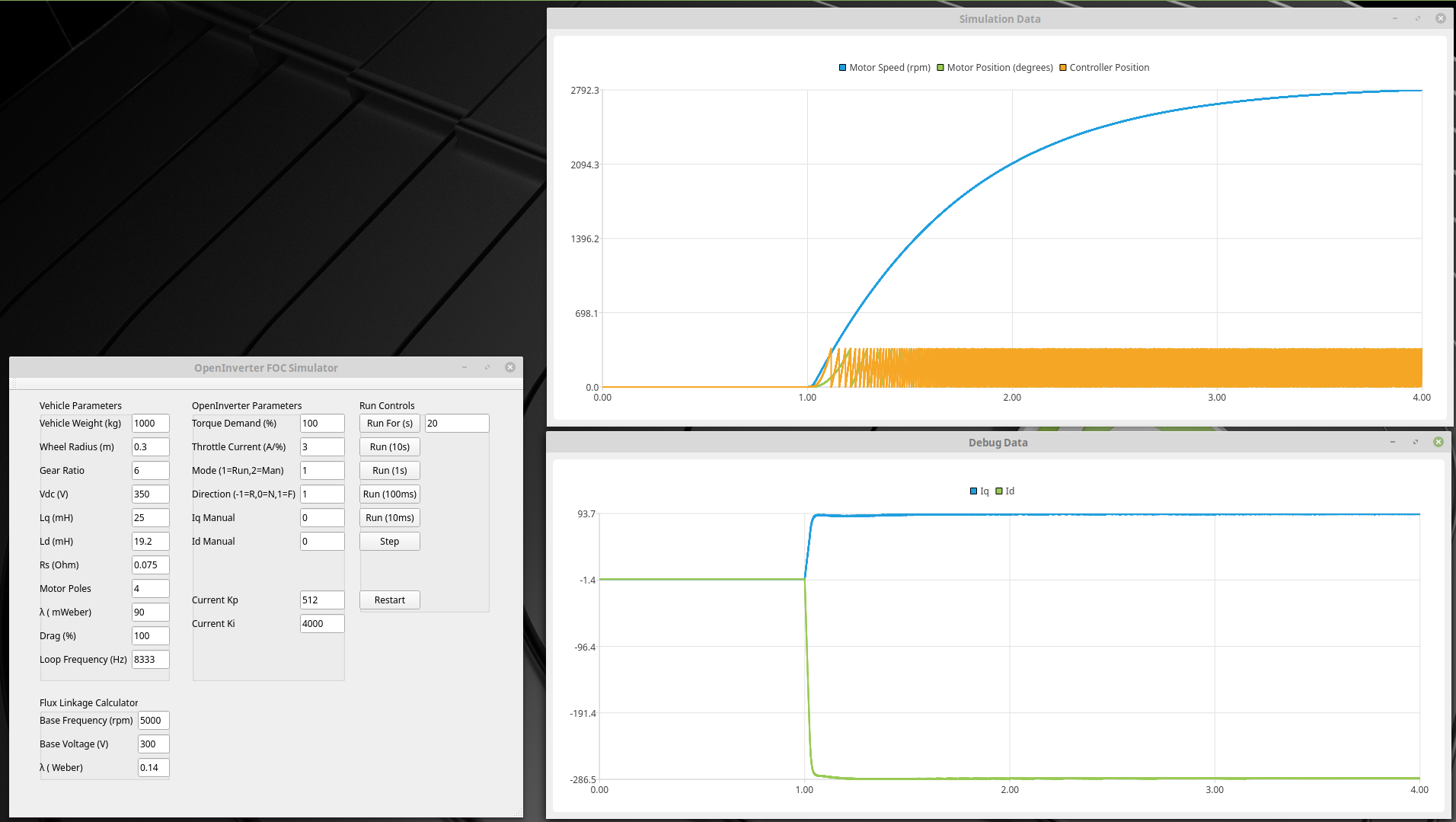

Next another manual mode run, 150A current but this time running till steady state is reached:
And finally a run mode run with 100% torque requested:
I think field weakening is disabled (default parameters used - need to dig into it a bit more) but it's interesting to see that the motor speed stops increasing when it gets to base frequency. Not sure how it manages to over speed slightly or why it decelerates slightly when told to coast. The later could be resistive losses in the winding, which are now included, or the fact that sync advance is running even though it's not needed (probably the next thing to have a look at).
Overall pretty happy with that. It's going to have to go on the back burner for a while now as I need to get on with the DIY that I should have been doing for the last few days rather than this but hopefully I can have a look at the field weakening in the evenings.
Edit - just noting it here so that I don't forget - the model is still missing some of the terms in the Iq and Id calculation (as described above) but is hopefully good enough for now.

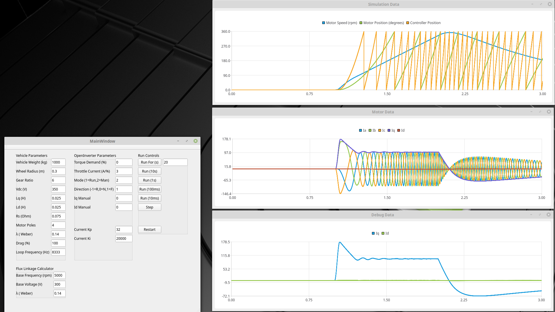

Right, rubbish nights sleep to not safe to do DIY :(
On the other hand that's a good excuse to do more code (as it's just getting to the interesting bit) :)
Looking again at the last plot above it is obvious that:
  • It's obvious that either the field weakening or MTPA algorithms are running
  • My simulation isn't doing a very good job of reducing the BEMF in the presence of negative Id
So the first job today is to figure out which (wondering whether the frequency is wrong which would mess both up) and fix the model BEMF calculation.
Next is probably to disable MTPA for now, I think I've got my head round how parameters work now so will probably add one for (Ld-Lq). Then see if the model simulates FW OK.

Parameters added for Lq-Ld and flux linkage. Two problems, that took ages to find. First the fixed point representation uses a different number of decimal places in the param and foc modules meaning that paramaters can't be pulled into the foc module for the MTPA algorithm wthout conversion. Second there is a bug in the OpenInverter code MTPA algorithm. Code, with the correction, is:
static const s32fp fluxLinkage = FP_FROMFLT(0.09);
static const s32fp fluxLinkage2 = FP_MUL(fluxLinkage, fluxLinkage);
//static const s32fp lqminusldSquaredBs10 = FP_FROMFLT(0.01722); //additional 10-bit left shift because otherwise it can't be represented
static const s32fp lqminusldSquaredBs10 = FP_FROMFLT(0.03444); //additional 10-bit left shift because otherwise it can't be represented
static const s32fp lqminusld = FP_FROMFLT(0.0058);
The change is the constant lqminusldSquaredBs10, the 10bit shift needs the value to be 0.03444 not 0.01722.
Screen grab for original code:
With the above fix:
And changed to use parameters gives the same result so I haven't broken anything (yet!):
This could possibly explain a few issues with reduced torque at higher revs when using MTPA!
