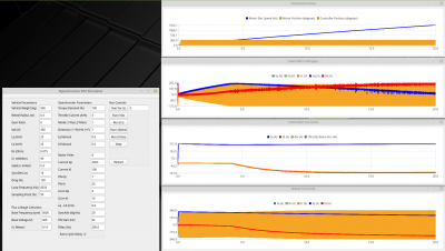

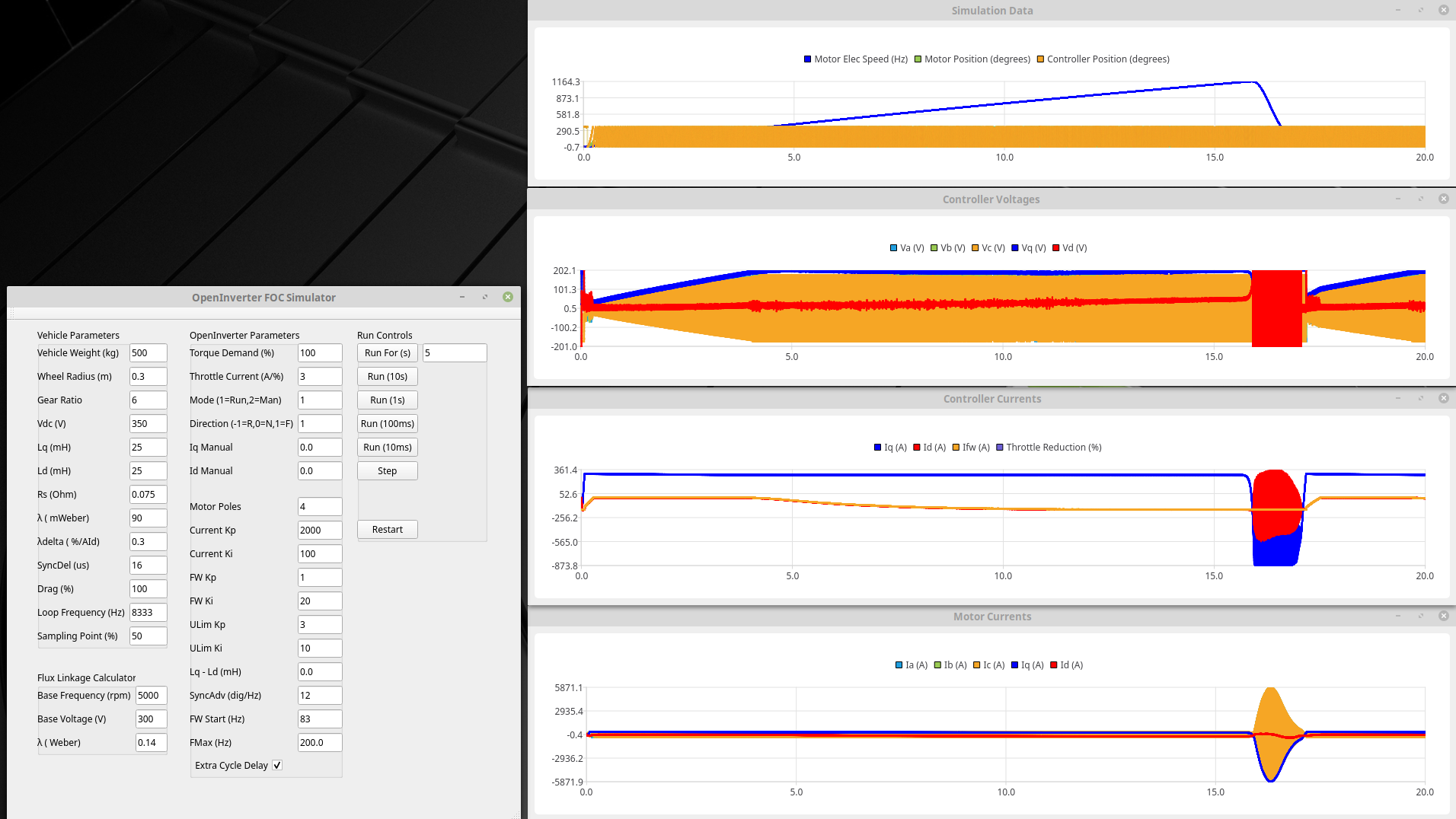

Have had a play with the simulator, a bit of PI gain tweaking has got to this: That's using a margin of 2000 (2100 gave very similar results), kp=2000, ki=100, FW kp=1, FW ki=20. I found any more FW kp caused serious oscillations. It's also with Mtpa disabled to make the plots clearer.
It looks pretty good apart from the very odd dip on Iq when FW starts to come in, not too sure what's causing that yet.
If you let the simulation carry on it runs out of Id as speed increases and looses control again.

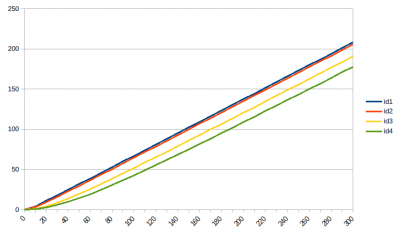

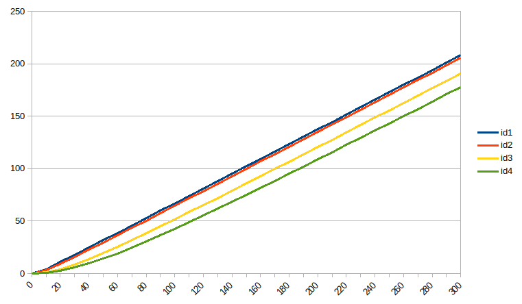

Here is what I found:
id1 is with ldminuslq=5.8 mH and fluxLinkage=90 mWeber
id2 is with ldminuslq=5.8 mH and fluxLinkage=150 mWeber
id3 is with ldminuslq=1 mH and fluxLinkage=90 mWeber
id4 is with ldminuslq=1 mH and fluxLinkage=150 mWeber
So the greater ldminuslq the higher the reluctance torque ratio and the higher the d-current component. The higher the fluxLinkage the lower the reluctance torque ratio and the lower the d-current. Spread sheet attached if you want to have a play.
Ideally you'd actually find out these values for your motor and enter them. Less ideally you just play with just one of them and see what is performing best. catphish would love this

Found the cause of the dip, if margin is too small it runs out of Utotal while adding Ud so has to back off Uq, increasing margin to 2500 just gets rid of it to give this:

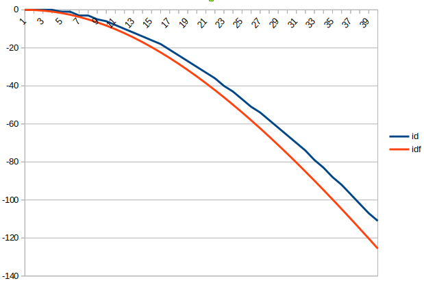

BTW - I was still a little worried about the floats in the Mtpa calculation (the mantissa is only 23bit - less than the number of floating bits in the adjusted fixed point version) so I ran it against the fixed point version just to check.
For 1mH: and 0.1mH The float does a better job, especially at lower lqminusld values (rounding errors on the fixed point version), which is good
Also nice to see the same answer coming out of two different implementations!

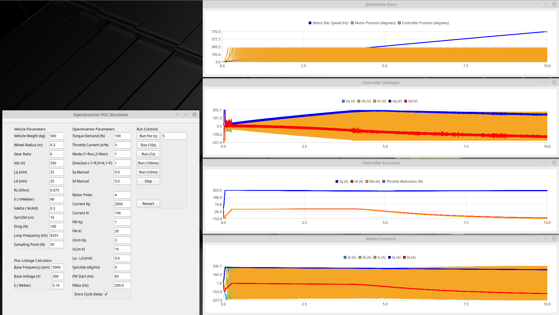

It's been bugging me why the above didn't work as expected so I decided to have another look. I think the following three plots sum it up:Pete9008 wrote: ↑Tue Sep 06, 2022 7:30 am Just figured out why you are losing power without syncadv!
Its not Mtpa its the rotor angle calculations. The way the code is at the moment syncadv it trying to do two jobs and not doing either properly.
If you run low syncadv you get the correct answer from the park/clarke for iq and id but then use the wrong angle value for the inverse transform andg get vq and vd wrong - better stability but poor power.
If you run high syncadv you get the wrong answer from park/clarke transform for iq and id so any vq and vd calculated from by the inverse transform them will be wrong whatever angle is used for the inverse transform.
What we need to do is calculate iq and id without syncadv but then use scynadv to recalculate the rotor angle before doing the inverse transforms for vq and vd. This will give us iq and id based on the rotor angle at the point of measurement and vq and vd for the projected rotor angle at the point where the new duty cycles are loaded into the timer and vq and vd actually come into effect. It should give us good stability AND good power.
Syncadv will then need to be set to the equivalent of 180us (the measured latency).

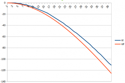

Edit2 - just tried to simulate this using the standard firmware in the model and it's not showing the torque increase I was expecting which is a little surprising. Will be interested to hear whether it makes a difference on a real motor as there is either a problem with my understanding or a bug in the simulator.
Edit3 - It's my understanding! The actual value calculated for Vd and Vq really isn't that important, it doesn't actually mean anything, it's just the output of the control loops, what matters is the id/iq being right. The loops themselves compensate to a degree for the angle error meaning that the recalculation of the angle prior to the inverse transform is less important than I thought it was. Adding the recalculation will help slightly with stability as it makes life slightly easier for the control loops (and I do see this in the simulation) so it is still worth doing.

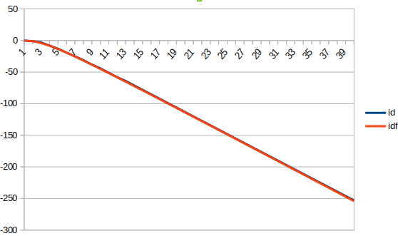

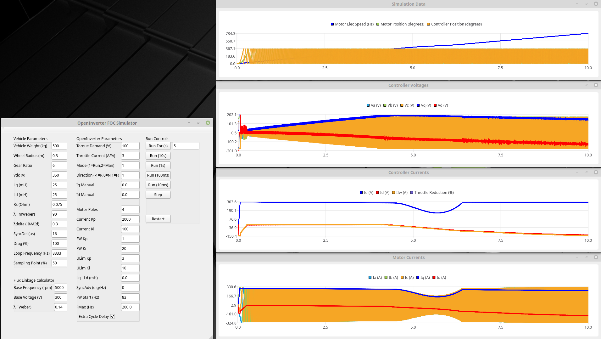

No angle recalculation: With angle recalculation (equivalent to a SyncAdv of 12): With angle recalculation (equivalent to a SyncAdv of 20): Note that the SyncAdv field shown in the plots has been repurposes for sync compensation.
It's fairly clear that the angle recalculation has very little effect on performance, the acceleration being virtually identical across the three plots. What it does do is improve loop stability. In the plot without compensation the control loops lose it around 835Hz (9.9krpm on a 5pole motor) producing very strong regen (4-5 times as strong as the max acceleration!). Using a sync compensation value of 12 still gives the strong regen but at 14krpm (45% increase). Increasing sync compensation to a value of 20 keeps the control loops stable for the entire simulation period (the max speed is equivalent to 17krpm on a 5pole motor!). The value of 20 will actually allow the motor to run up to 30k, it does get a bit unstable above 20k but never produces strong regen.
So sync compensation could be worth it depending on the motor and what speed it needs to be driven up to.
EDIT - Note all the above is straight acceleration, no lifting off the throttle! This is just the loops losing control and getting strong unwanted regen purely due to increasing speed while accelerating.
EDIT - just had a play with the above and its effect on unwanted regen when lifting off on the throttle - basically it provides a slight improvement but nothing that really makes a difference. Limiting the rate of throttle change does help a bit but the further you push into the field weakening region the less effective it is, by the time you get up to 10k even very slow throttle removal (seconds) isn't enough to keep things stable. The problem is that this is also a snap effect, it's fine at one speed but you go a bit faster and it goes into full regen the moment you come off the throttle. To get up to 10kprm type speeds I think we're going to have to look again at reducing the measurement to output latency.
