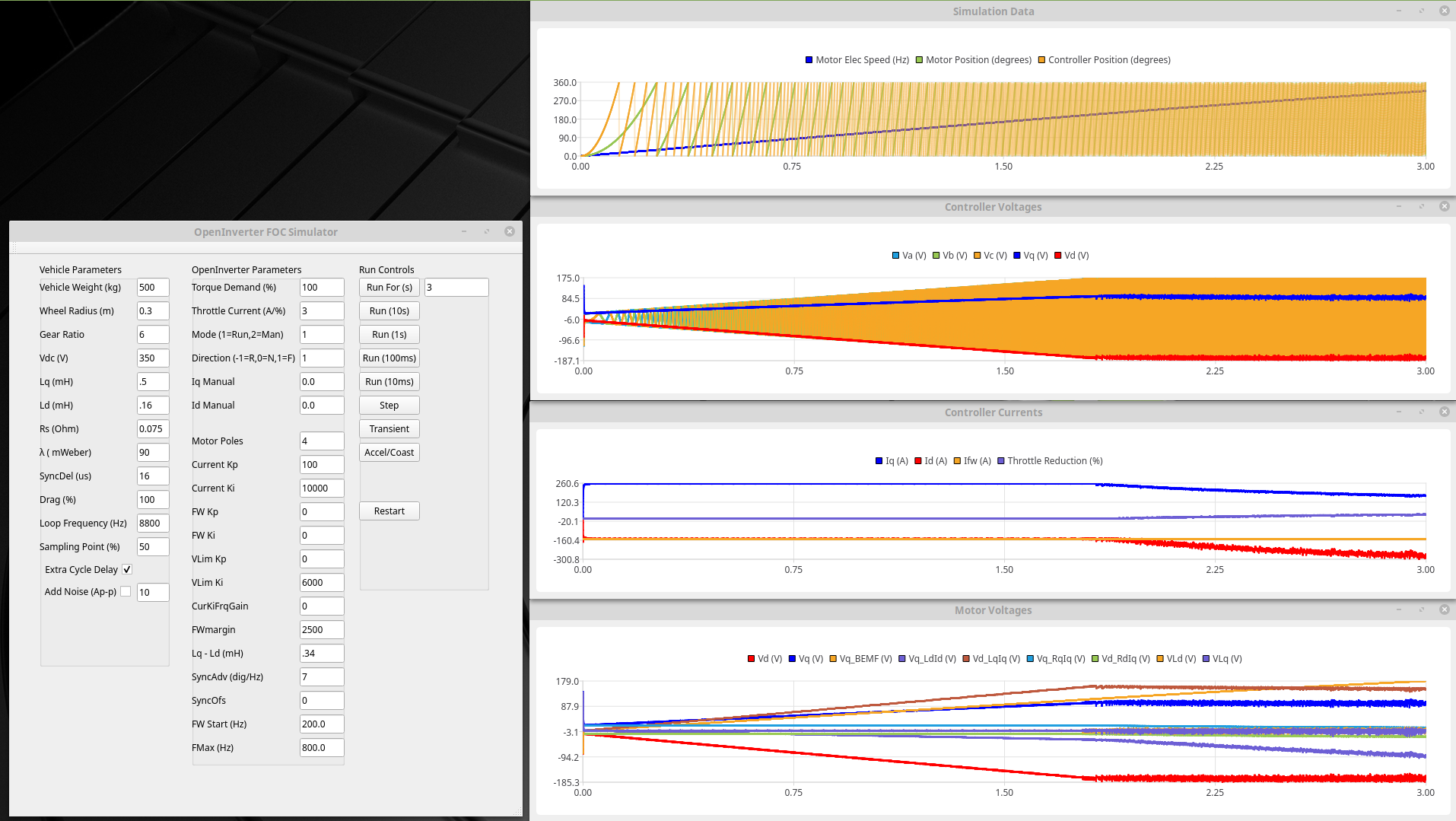

Well here's an interesting complication!
Just ran the simulation on a low L motor and it seems the FW controllers gains are the wrong way round Now I did reverse it while rewriting the controllers as had reversed their sense and convinced myself I'd just got confused while doing it - looks like I hadn't.
It turns out that if you are running a high L motor with Mtpa it is quite possible for the Mtpa to request more -Id current than the critical current of the motor. This has the interesting side effects because once you are past the critical point the effect of Id in terms of compensating the bemf is reversed
Going to have to have a bit of a think about how to address this. If we had an accurate measurement of the critical current then could possibly just check where the operating point was with respect to it - but since we are guessing that's not going to work.
Edit - @johu - do I remember you experiencing some issues with the phase of Id reversing?
Edit2 - this is really quite nasty, the effect of Id for FW is reversed depending on which side of the critical current you are, and depending on the throttle and Mtpa settings you can end up on either side of it. Going to have to take a break from this and have a ponder. Anyone got any ideas?
Edit3 - Not so sure about this now, the FW controller seems fairly broken so need to fix it first then review the gain polarities.
Edit4 - Found the problems, the PI controller anti windup doesn't like negative gains (fixed) but there is also an integer arithmetic rounding error that I'm not too sure how to sort out yet. The gains do seem to be reversed though so it looks like the issue for controlling FW on high L motors is real. Probably be Friday before I can look at it again.

@johu, is there any chance that you could do a test next time you are working on the A2?
The maths says that when -Id that exceeds critical current it will cause the motor voltage to start increasing again. This is really non intuitive for me and it would be great to have a physical confirmation that it is a real effect. Could you capture a few plots with Mtpa, fw and regen disabled but with manual Id set, one at 0A, one at -45A (critical current for the Prius?) And one at a higher level (-80-90A would be nice if you are comfortable going that high). In each case we need to see the uq and ud plots while coasting (doesn't need to be that fast, just enough to see uq clearly in the 0A plot and how it changes in the others). If the maths is right the 0A and 90A plots should be similar and the 45A plot a lot lower in amplitude (0v at the critical current).
Edit - added disabled regen in the above.

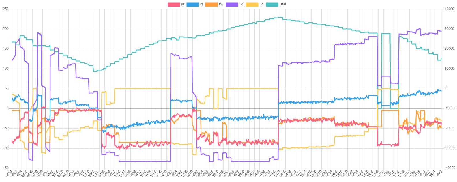

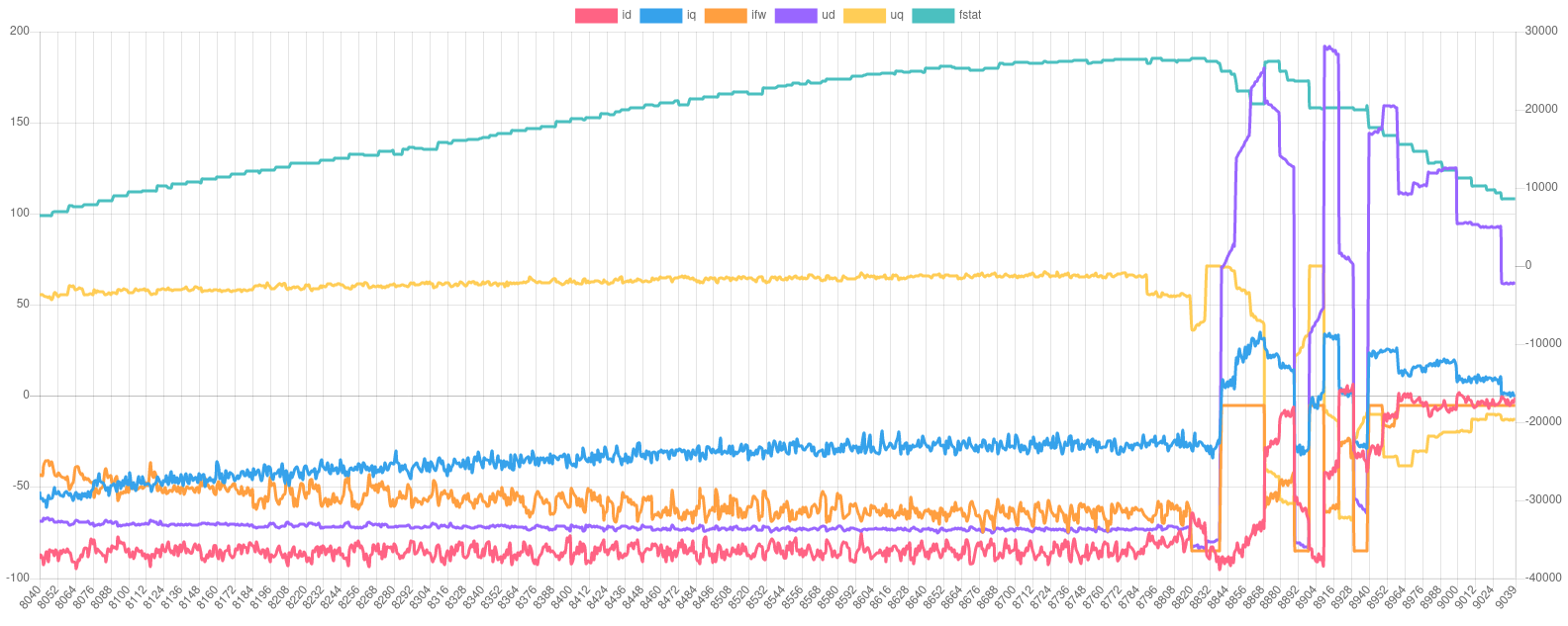

I have made that log you said, just coasting down a hill with regen and FW disabled but various fixed FW currents programmed. At the higher currents I started with low FW current and only switched in the higher value once I was rolling.
The results are rather surprising. Lets look at the 50 Hz value for uq
- ifw=0 -> -7322
- ifw=-20 -> -7352
- ifw=-45 -> -4941
- ifw=-90 -> -11
So at ifw=-90 it looks like we have completely eliminated the rotor field! Even at 100 Hz hardly any voltage is needed to keep iq=0. Then as soon as ifw is lowered to -9A we need uq=-17259 digits to stay at iq=0A. Also once again we see that there is no frequency dependence of ud but when driving with MTPA suddenly there is. syncadv=7 at all times
EDIT: at -90A ifw the inverter tripped out a number of times so you'll see some strange data
EDIT2: while off-throttle regen was disabled brake pedal regen was still enabled. So at the end of each run you see positive iq. And then ud suddenly changes sign and has much higher magnitude. So the two are very closely coupled. That's probably what "dq decoupling" is useful for.
Also did another test drive on a level road. It drives fine at full throttle (although not mighty powerful) but starts doing weird oscillations when trying to maintain speed

Thanks for doing that, it looks like it ties in well with the maths
It does suggest that either the motor Ld is lower than we thought, or the flux linkage is higher. The values we were working on would have suppressed the field at 45A not 90A. Some of it could be due to core saturation but i doubt that much (especially on only 90A of Id). Maybe 150mWeber and 2mH plus a bit of saturation.
If you are comfortable going a little higher it would be really interesting to see if the voltage increases again with more than 90A?
Could the oscillation be when the Id goes above 90A and the field start coming back? There would be some odd effects when the current crosses Icrit.
Edit - what's dq decoupling?
If its started tripping then going higher would be a bad idea. Wonder if the tripping is because the loops don't like the phase reversal on uq?

Never goes above -90A so I don't think that's it. Seems to get to the point where ud changes sign. The car felt like the plot looks. Accelerate, decelerate.
It a feed forward method to anticipate the coupling of d and q, it's in one of Dave Wilson videos, don't remember which one.
No phase reversal, it randomly tripped while just rolling. Not sure why.

Couldn't resist giving Wednesdays code a quick run with just the voltage limiter controller enabled (FW controller disabled), before starting the changes ,to see whether the idea worked and it looks very promising
This is the same code that runs the high L motor but running a low L motor.
First a plot (taken from an earlier post) showing the old code: And a plot showing the same run but with the new controller: And a run showing the coast still works fine too: Going to call that a sucess!
Couple of points worth noting. First the limiter comes in a little later (because it aims for a lower margin than the FW controller) and second the terminal speed is slightly lower. This might be due to a change in the model (there was a bug with the flux linkage updating in the model so not sure whether the motor was actually using the shown 90mW or 150mW in the first plot) or whether this is due to the slight performance reduction inherant in just using the limiter (mentioned in an earlier post). I'm going to add an Iq/Id polar plot to the simulator to make it easier to see what the operating point is doing during the simulation to see which it is.

And one more plot that has accelerated to a higher speed (~7krpm) which shows detail of what the currents do at the point where it changes from accelerating to coast:
Id is around -333A while accelerating and changes to -140A when coasting to maintain control of the bemf (bemf of 250V reduced to the max inverter voltage of 190V). There is a bit of oscillation during the transition suggesting there is still a bit of work to do on the controller gains but overall not too bad - johu

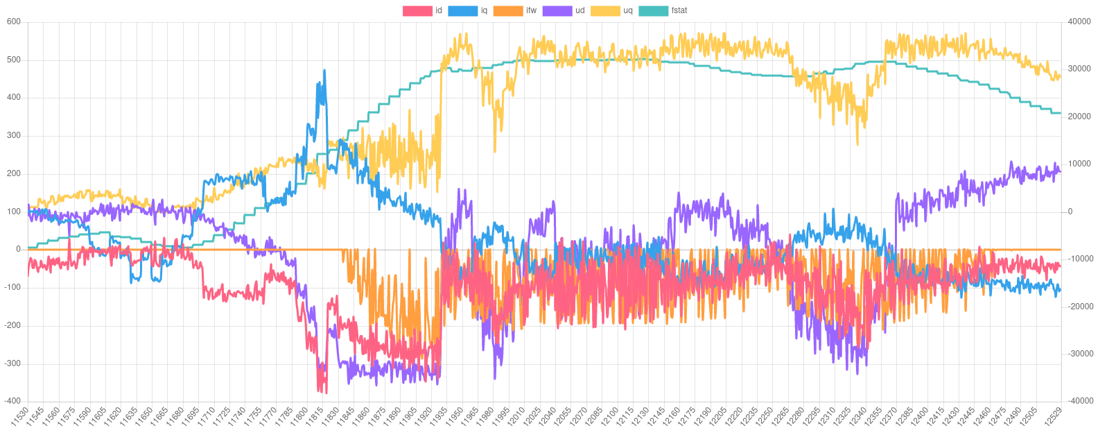

Wow, that was quite something! Flashed that latest firmware on Touran with the amplitude limit revised (not that it makes a difference on that motor, see for yourself)
First, a subtle try with throtcur tuned down to 3 and ocurlim to 500 in to be able to kill off unwanted acceleration with the current limit:
At around 300 Hz you see FW come in slowly
Then with the normal parameters downhill and up to 500 Hz. Performance is spectacular for my standards, no problems transitioning to regen and out of regen, no controller saturation. Just wow Admittedly current waveforms don't look pretty but at least they work.
