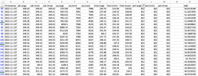

So for this, I went to the top of a hill and started logging. Only had my esp8266 on me. I plugged the uac formula in to excel and have a value about 50V? Does that seem sensible?
I'm not sure where the 83 and 70 came from on the next line and how this equals 0.56?
- Been thanked: 1913 times
Oh, copy&paste error, these were still from the Prius. Must be 169V and 300Hz
So 50V, 234 Hz would be 0.21 V/Hz or 34 mWeber - surprisingly small!

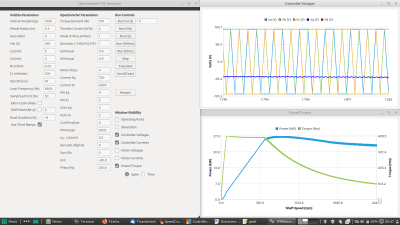

While resaerching the V/Hz definition I came across overmodulation. That is increasing the amplitude so that the sine wave is clipped and approaches a square wave. This yields higher amplitude at the cost of increased EMI, apparently.
But it seems it can wrangle a bit more power from the Prius motor: All I changed is modMax in foc.cpp to 45000
Same settings without overmodulation:

Nice find, could be worth a try!
Apart from the EMI there could be other effects. It must make the effective gain go a little non linear towards the top end (and if you go too far it could drop to 0!) I'd also expect quite a bit of pwm freq ripple to start appearing in the control loops. As long as neither of those cause the loops a problem it should work ok. Can't see the increase in EMI being huge but the motor will start seeing much more third/fifth harmonic, not sure what the effect of that would be, more vibration or losses?

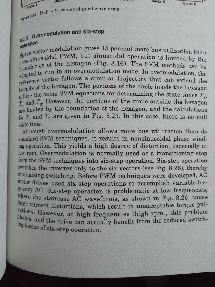

- SciroccoEV
- Posts: 370
- Location: Luton UK
- Been thanked: 16 times
From my 1998 copy of the "Motor Control Electronics Handbook".

That looks like a usefull refernce book, is it worth buying?
Been on the lookout for a good reference, particularly one that gives the full derivation of all the equations, but they all seem a bit expensive if they don't turn out to be that good.
Interesting idea about moving to 6point modulation at higher frequencies. It would give max power and reduced switching losses.

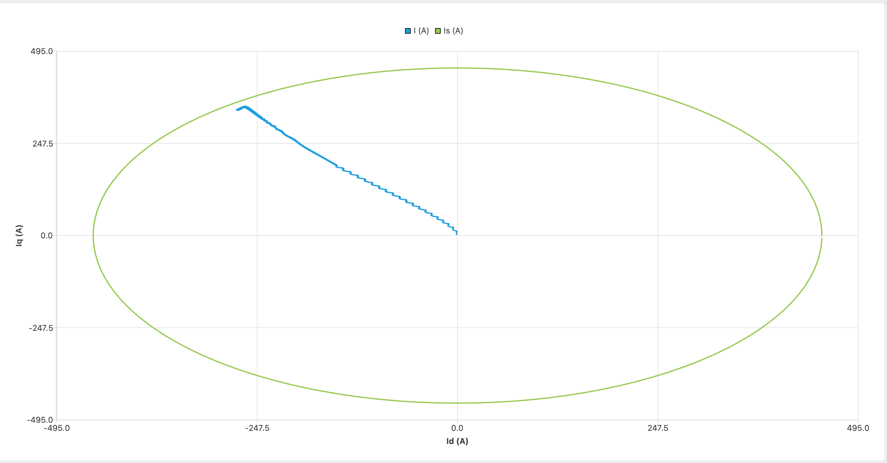

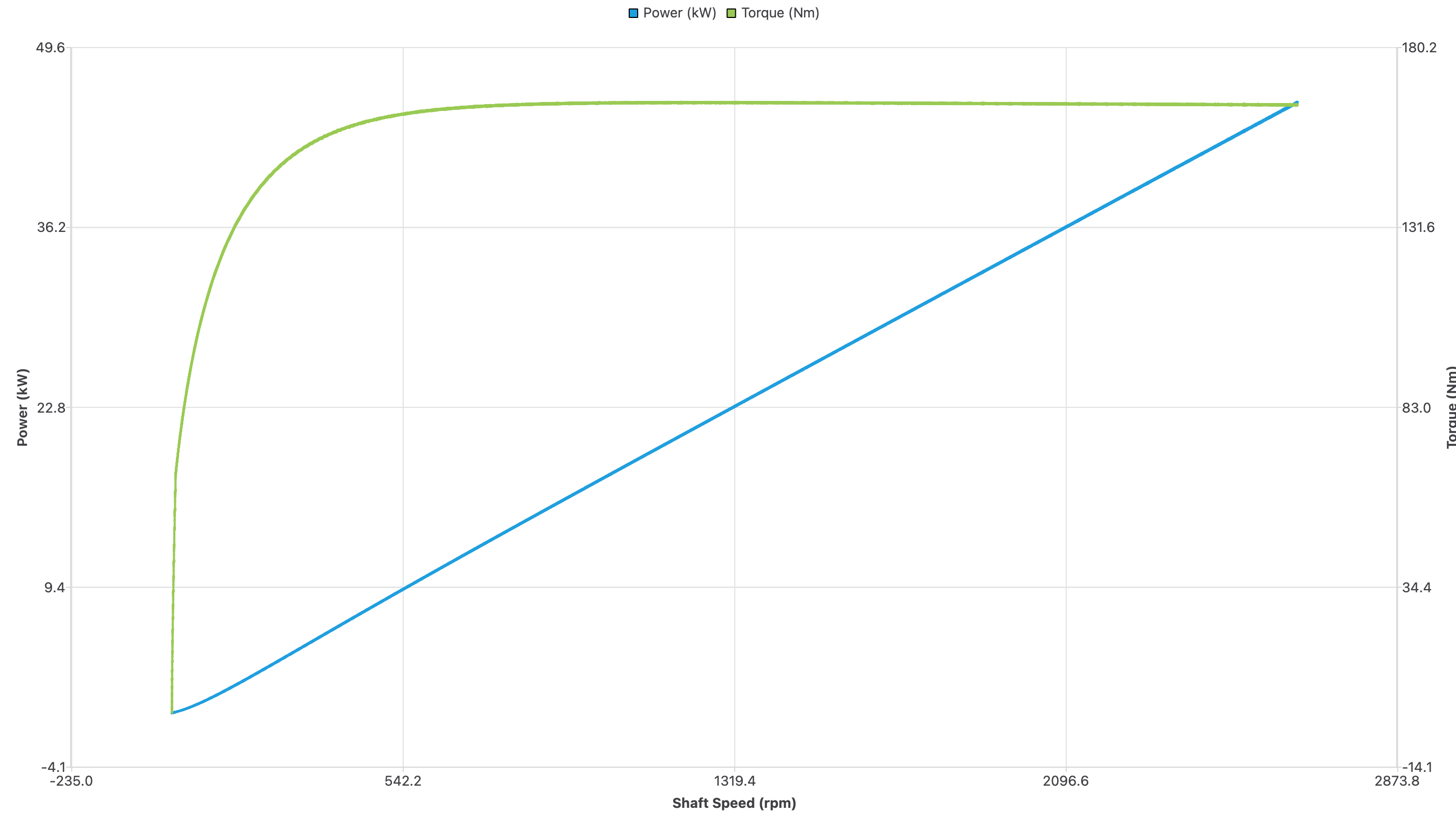

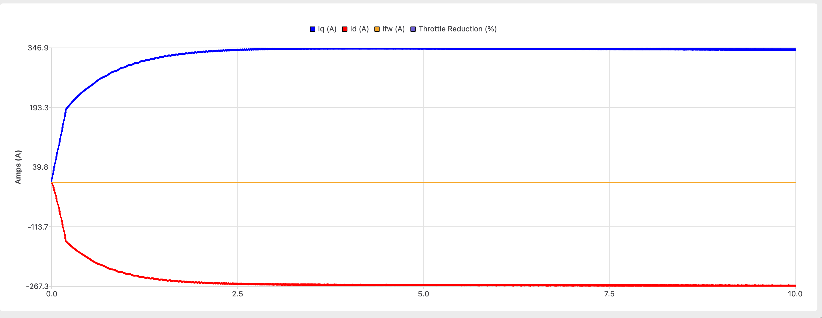

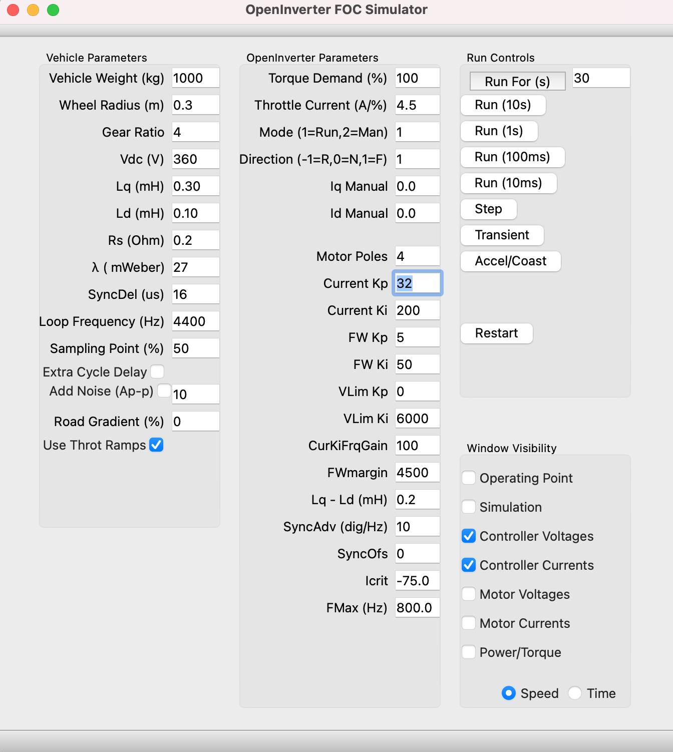

- Posts: 1884
- Has thanked: 91 times
- Been thanked: 517 times

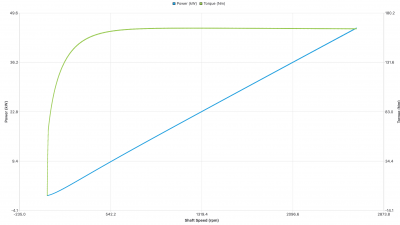

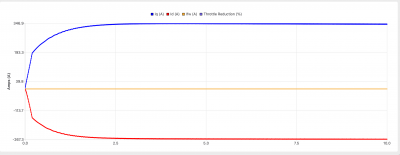

Does 27mWeber seem reasonable?
Not calculated icrit just used -75 for now The simulation looks OK to my limited understanding

Agree, 27mWb does seem a little low but it's what the maths says. Were iq, id and vq all zero when you took the measurement? Without spinning up a motor on the bench and measuring the voltages it's difficult to come up with a better estimate.
Graphs look good
Only comments are stick with loop freq set to 8800. That is the frequency the control loop runs at, its also the pwm update frequency (double update at 4400Hz). The current rise times do look a little slower than expected though (although nice and stable when they hit the setpoint), might be the loop freq but if it doesn't improve when you change to 8800 try upping the loop gains slightly.
With those values for Ld and flux linkage icrit should be nearer -270A (although not familiar enough with Johannes code to comment how to set things up for that - still need to give it a try and then do the final simulator update)
Edit - I also tend to reduce the car weight most of the time - it makes the simulations run quicker! And increase it back to a realistic number just for final runs.
Edit2 - what power is the simulator showing for your setup?
Edit3! - and keep the extra cycle delay ticked. It's needed to include the delay before the new pwm values are loaded in the real hardware.

Regarding this I forgot to say that I still plan to run some of your logged data through the simulators motor model, basically use the logged pwm values to drive the model and then compare the measured currents with the simulated currents. If the two match the measured parameters, and the model, are right if they don't then try and adjust the values till they do to see what the difference is. Trouble is its not a simple job and I can't quite face it at the moment.
To work best it really needs logged data from flat roads (no hills), and ideally with very little, ideally no, braking (regen is fine but actual car brakes would mess it all up). Would any of your logs, or sections of your logs, work for this?
- Posts: 1884
I'll go make specific logs for this purpose, I'm not sure what the values for iq, id and vq were 0, was just coasting down hill, 0 throttle or regen, low rpm, but was only logging with the old esp8266.
Simulator shows a max of 45kw, which is lower than I've seen using my shunt. Increasing the FWmargin to 5500 gets the power up to 68.8kw on the simulation, not tested that in the car though.

That's interesting, you haven't even hit the constant/max power region of the plot yet. Would be worth letting the simulation run a bit longer (or reducing car weight - doesn't affect the power, just how quickly it gets there).
Dont need to be coasting down a hill, coasting on the flat should work fine too.
Interesting on the fwmargin, should go the other way! Making it bigger reduces the max amplitude on the pwm which should reduce power
Edit - what speed do you run the motor up to in the car?
Edit2 - for the flux linkage measurement it is better to coast at a higher speed as the larger numbers improve accuracy, say half base speed?
