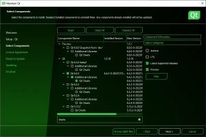

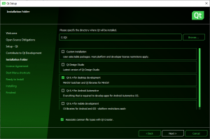

Installing Qt
To quote Wikipedia "Qt is cross-platform software for creating graphical user interfaces as well as cross-platform applications that run on various software and hardware platforms such as Linux, Windows, macOS, Android or embedded systems with little or no change in the underlying codebase while still being a native application with native capabilities and speed.". It comes in both open source and commercial versions and for home use the open source version is fine.

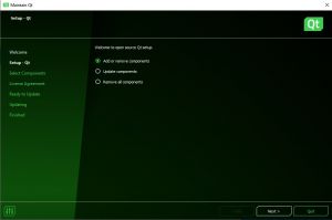

To install download the online installer from https://www.qt.io/download-qt-installer. You will also need to register for a Qt account.
An example of a minimalist installation may look like this: First install only the "Qt x.x for desktop development" module. Then, once the installation is complete, open the Maintenance Tool (MaintenanceTool.exe found in the top level folder where you installed Qt) and select "Add or remove components". In the search bar at the bottom, type 'charts' and select "Qt Charts" under the version of Qt you installed. Click 'Next' and follow the prompts to complete the update.

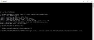

Installing the Simulator and OpenInverter Software
This assumes that git is already installed, if not you will need to install that first (https://github.com/git-guides/install-git)
Go to the directory where you would like to install and do:
git clone https://github.com/Pete9008/IPMMotorSim
cd IPMMotorSim/
cd IPMMotorSim/
git clone --recurse-submodules https://github.com/jsphuebner/stm32-sine
This will copy the simulator code onto your machine and copy the OpenInverter code into a subdirectory within it. Johannes also has a fork of the repository which already includes the OI code it can be installed by doing a single:
git clone --recurse-submodules https://github.com/jsphuebner/IPMMotorSim.git
Currently the only difference between the two is the way a line of OI code is handled, Johannes automatically comments out a line of code that causes an oscillation in the simulator output but keeps it for real firmware builds. I'm not too keen on this as I believe the line also causes problems in real life and I'd prefer to understand and fix it rather than mask it in the simulator and so I haven't pulled this change. See here for details https://openinverter.org/forum/viewtopic.php?p=49172#p49172

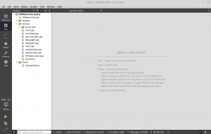

Open QtCreator, go to 'Open Project' (either in the File menu or on the Home screen), browse to the directory where you installed the simulator and then go down into the 'IPMMotorSim' subfolder twice. In there there should be an 'IPMMotorSim.pro' file. Open this and you will get a 'Configure Project' dialog, just accept the default for this. You should see something like this:
To build the software go to 'Build' at the top and select 'Build Project: IPMMotorSim'.  This should do a full build of the simulator software and the OI firmware.  On my Qt install (which is a little out of date) this results in 53 warnings.  They are non-critical (mostly to do with old style type conversions in the OI fixed point math). With that done you can run the software either by clicking the 'Run' button (green triangle at the bottom left), the 'Start Debugging' button (other green triangle with a bug icon) or by selecting the same from the top menu. With that done you should see something like this:

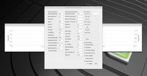

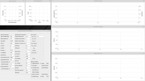

Now on the first run the window positions are not set so the first thing to do is to set the windows up how you like them, this is how I set it up:
On subsequent runs these positions are remembered.  It's worth noting that the more windows you have active the slower the results are to draw so there is no point having windows up that you don't use.

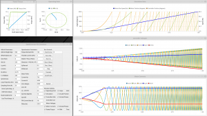

The last thing to do is run the simulator to see if everything works, first change the values for Lq to 4 and Lq to 2 (so that it matches the Lq-Ld setting of 2 that has been pulled from the param file) and hit 'Run (1s)', you should see something like this:
How to Use the Simulator

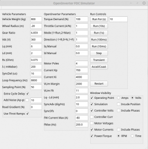

The first screen to explain is the main data entry and control window:
This is split into 4 areas, taking each in turn.
Vehicle Parameters
These are the settings that only affect the motor model, they basically configure the model to match the parameters of your motor and vehicle, they can either be measured (see earlier posts in thread for details) or found online.  The closer they match your vehicle/motor the closer the simulator results will be to the real world.  The values are:

OpenInverter Parameters
These are all fields from within the param_prj.h file which are made available here to allow them to be adjusted easily. Any changes to their values are NOT persisted across program runs but are instead re-initialised from the param_prj.h file on each program start up. It is suggested that the param_prj.h file is modified to reflect any changes that you would like to make permanent. Please note that some parameters in the files that you may expect to have an effect are ignored (syncofs, pinswap and respolepairs). All parameters that affect the higher level vehicle control functions of OI are also not used.

Run Controls
These are fairly self explanatory and just control the running of the simulation and run for a set time or restart the simulation. Slightly less obvious ones are:
  • Numeric field - The time the simulation will run for when using the 'Run For (s)', 'Transient' or 'Accel/Coast' buttons.
  • Step - This is primarily used when debugging code using the Qt debugger. It allows the OI control loop to be run a single time only.
  • Transient - This runs for a period at zero torque, a period at 'Torque Demand' torque, a period at zero torque and finally a period at 'Torque Demand' torque. The period is set from the numeric field. This can be useful when testing control loop transient response and overshoot.
  • Accel/Coast - This runs for a period at 'Torque Demand' torque and then a period at zero torque. It can be useful when testing field weakening.

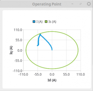

Operating Point
This is probably only useful if you are looking at developing MTPA or MTPV control algorithms. The Id and Iq currents, or Vd and Vq voltages, are shown on the two axis, the green circle shows the maximum current or voltage circle and the blue trace shows the operating point of the motor. Please note that the voltage circle includes the space vector allowance so can be higher than may be expected based on Vdc. In the plot above you can see the operating has moved along the MTPA line as the motor accelerates until it hits the current limit and then dropped down as FW comes in. The plot would look different for low inductance motors.

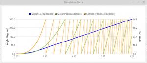

Simulation
Basic simulation data, motor electrical speed, motor rotor angle, and controller (motor electrical) position. To speed up rendering the position traces can be disabled.

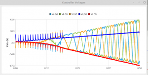

Controller Voltages
This plot provides the motor voltages imposed on the motor by the controller PWM output value. This is not the true motor voltage, as the output is a PWM value, but is the equivalent non-PWM voltage that would produce the same motor currents. NOTE - these voltages are referred to an imaginary ground and so the space vector modulation is visible. The voltages actually seen by the motor would not have the space vector ripple on them (it cancels out across the three phases). If you don't like seeing the space vector ripple then comment out the three lines at line 413 of mainwindow.cpp and uncomment the three lines at line 445. The equivalent direct and quadrature voltages are also shown and are usually more useful than the phase voltages. To speed up rendering the phase voltage traces can be disabled.

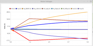

Motor Voltages
This plot shows the components of the motor voltages as calculated from the motor equations. Each term of the equations are plotted on a separate trace. This plot is only really of value if you want to understand the interaction of the equation terms and would normally not be enabled.

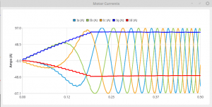

Motor Currents
This plot shows the motor currents. Note that these are the actual and correct motor currents, if the controller currents and motor currents disagree then these are the correct ones and the sampling parameters (probably SyncAdv unless you have changed SyncDel or Sampling Point from their defaults) needs adjusting. It is worth noting that these should always be sinusoidal as the motor does not 'see' the space vector modulation at all, just a 15% bigger sine wave than would otherwise be possible. If over-modulation is used then some waveform distortion is to be expected. To speed up rendering the phase voltage traces can be disabled.

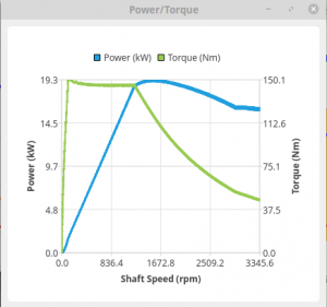

Power/Torque
This plot is fairly self explanatory. Use a time x-axis if trying to correlate against other plots and a speed axis if you would like a traditional power/torque plot. The normal plot is calculated from the shaft power of the motor. If the Efficiency checkbox is ticked the electrical power going into the motor is also calculated and plotted. The motor efficiency is also calculated and plotted (shaft power/electrical power). Magnetic and mechanical losses are not allowed for in any calculations.

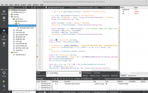

Finally if you are interested in the OI code the Qt debugger is fully integrated into the environment and works well with the simulator. For example:
This is with a breakpoint set in the middle of the main control loop (the red dot by the line numbers), the values of frqFiltered, ud and uq are shown on the right, you can single step through the code (while watching how the values change), push down into subroutines, set more breakpoints etc. Hovering over variables also shows their values. For debugging, or just understanding how code works, I find it invaluable. With the simulator it also has the advantage that it's safe, hitting a breakpoint in firmware controlling a real running motor can be problematic to say the least! With the simulator when you hit a breakpoint everything stops, including the motor model, allowing you to continue as if the breakpoint hadn't happened. Without the debugger I very much doubt that any of the fixed point overflow bugs would have been found and I definitely wouldn't have developed the understanding of the way the code works. If you are used programming without a debugger then it is worth having a play with it just to see what you are missing!
