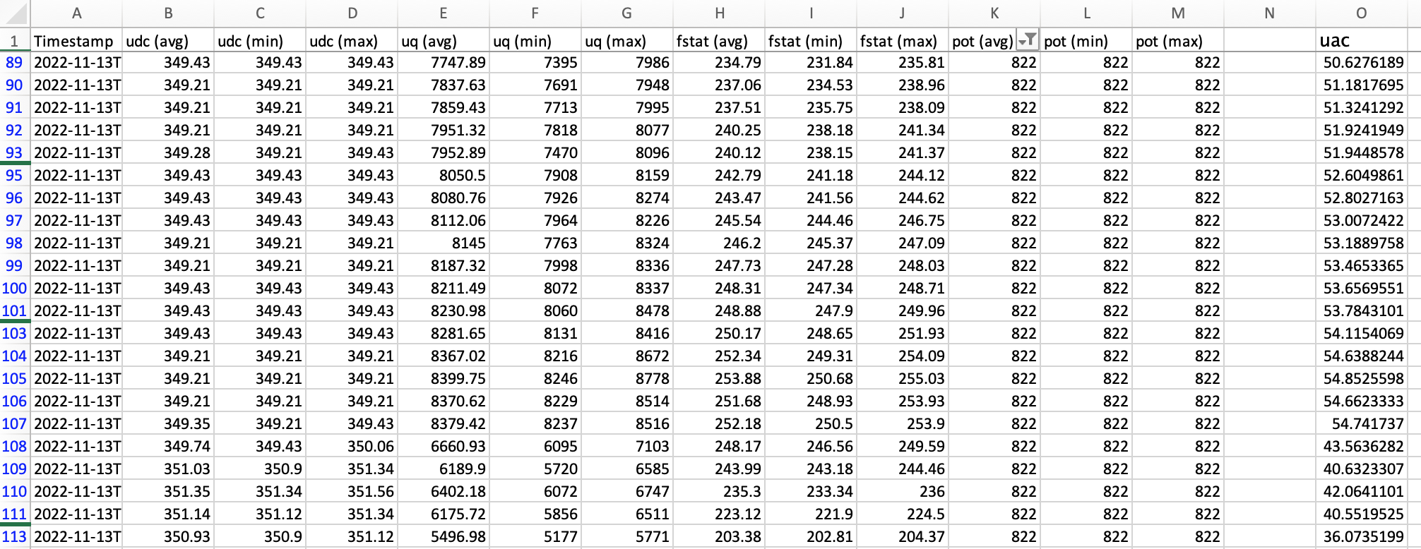

So for this, I went to the top of a hill and started logging. Only had my esp8266 on me. I plugged the uac formula in to excel and have a value about 50V? Does that seem sensible?
I'm not sure where the 83 and 70 came from on the next line and how this equals 0.56?
- Posts: 6968
- Has thanked: 454 times
- Been thanked: 1771 times
Oh, copy&paste error, these were still from the Prius. Must be 169V and 300Hz
So 50V, 234 Hz would be 0.21 V/Hz or 34 mWeber - surprisingly small!

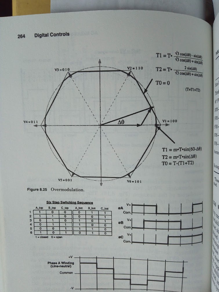

While resaerching the V/Hz definition I came across overmodulation. That is increasing the amplitude so that the sine wave is clipped and approaches a square wave. This yields higher amplitude at the cost of increased EMI, apparently.
But it seems it can wrangle a bit more power from the Prius motor: All I changed is modMax in foc.cpp to 45000
Same settings without overmodulation:

Apart from the EMI there could be other effects. It must make the effective gain go a little non linear towards the top end (and if you go too far it could drop to 0!) I'd also expect quite a bit of pwm freq ripple to start appearing in the control loops. As long as neither of those cause the loops a problem it should work ok. Can't see the increase in EMI being huge but the motor will start seeing much more third/fifth harmonic, not sure what the effect of that would be, more vibration or losses?

From my 1998 copy of the "Motor Control Electronics Handbook".
Pete9008
- Posts: 1801
- Has thanked: 102 times
- Been thanked: 350 times
That looks like a usefull refernce book, is it worth buying?
Been on the lookout for a good reference, particularly one that gives the full derivation of all the equations, but they all seem a bit expensive if they don't turn out to be that good.
Interesting idea about moving to 6point modulation at higher frequencies. It would give max power and reduced switching losses.

Simulator shows a max of 45kw, which is lower than I've seen using my shunt. Increasing the FWmargin to 5500 gets the power up to 68.8kw on the simulation, not tested that in the car though.
Pete9008
- Posts: 1801
That's interesting, you haven't even hit the constant/max power region of the plot yet. Would be worth letting the simulation run a bit longer (or reducing car weight - doesn't affect the power, just how quickly it gets there).
Dont need to be coasting down a hill, coasting on the flat should work fine too.
Interesting on the fwmargin, should go the other way! Making it bigger reduces the max amplitude on the pwm which should reduce power
Edit - what speed do you run the motor up to in the car?
Edit2 - for the flux linkage measurement it is better to coast at a higher speed as the larger numbers improve accuracy, say half base speed?
