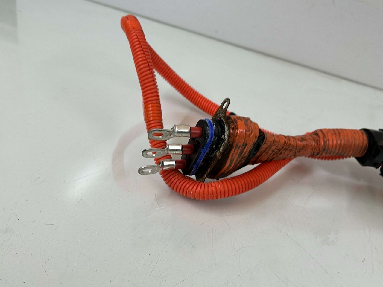

Gentlemen I could really appreciate your help in identifying the mystery 3 prong "extra" cable in this Medusa like listing

Re: I just bought a Mitsubishi Outlander charger. - Now What?
That's the rear inverter to motor cable.
That price is very cheap for both cables. Was this listing for just one of the cables and did you get the right one?
