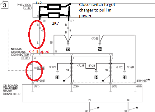

I ordered an outlander charger and DC:DC earlier in the week and it arrived yesterday. It is quite a neat unit, would easily fit in a spare wheel well of a conversion.
I found some good diagrams online for the outlander which detail the 13 pin connector on the side of the unit. Here's the pin out so far:

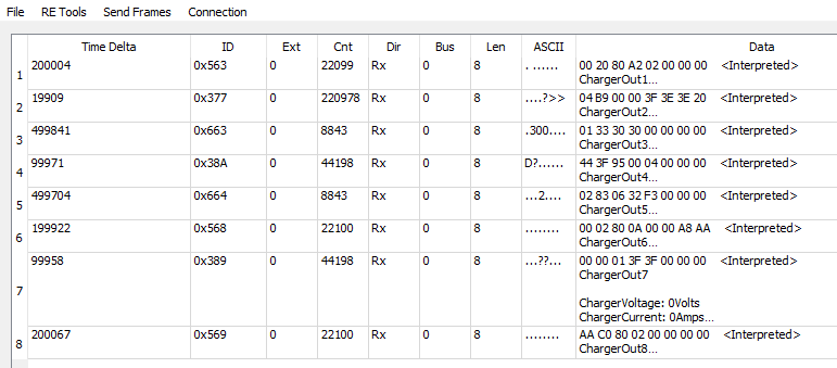

I powered up the unit from a 12V supply, takes about 250mA and was able to see 500kbps traffic on the CAN bus, using SavyCAN. The proximity signal connects to the phev-ecu, do something will be needed to read that signal.
I can see the volts/amps being supplied to the charger on the CAN bus, frame 0x389.
Now that i have the DBC file for what the charger puts on on the bus i can use this when i go to log on the vehicle, to filter out 1/2 of the traffic.
I also plan on using a signal generator on the control signal set different duty cycles and see if can spot the message going to the charger changing to say the max current allowed from the charger.
There is still a good bit more work to do, but it is looking positive so far.

Updated pinout based on what's on the vehicle.
Pin 1 (Orange) NC on outlander
Pin 2 NC on outlander
Pin 3 (Blue) NC on outlander
Pin 4 DC SW (enables the DC:DC converter, seems to just target 14V when this is high)
Pin 5 CHIN (Serial protocol to EV Remote wifi module)
Pin 6 CAN H (Black)
Pin 7 Sense line for DC to DC converter
Pin 8 IGCT main power to charger
Pin 9 Proximity signal from charger
Pin 10 GND
Pin 11 NC
Pin 12 CHOT (Serial protocol to EV Remote wifi module)
Pin 13 CAN L (Red)

0x38A, 8, temp, temp, input bus voltage, pilot pwm duty (plain in decimal), charger status

Thanks for the info, it's very useful. Yes, I had the prox and pilot signals flipped, so I have changed them back. I replayed the CAN bus frames from the vehicle and at one point I believe I got the charger to try to start a charge.
Do you know which CAN ID contains the byte which sets the max charge rate?

You only need to send 0x285 and 0x286
0x285 alone will connect the evse but won't charge until you send 0x286
0x286 byte 2 sets the charge current, there is a voltage setting on byte 0 and 1 but that is completely ignored

Definite charger progress being made. I need to review the values I'm sending, as I can get the evse to pull in it's main contactor but it drops out right away. I'm not sure is it because I'm trying to push power into a resistor. I wonder is the charger seeing no battery voltage and faulting out.
