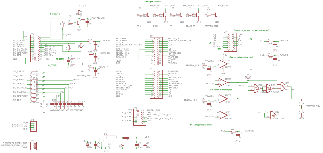

The main board is the heart of the inverter system. It contains all the intelligence that is needed to convert the users inputs into motor shaft movement. It also contains all the protection circuitry to avoid damage in case of errornous inputs.

Digital inputs
There are external 8 digital inputs on JP5. A voltage of >7V is interpreted as a logical 1 (high). They all have a cutoff frequency of 40Hz.
  1. Cruise Control (Pin 5).
    This input sets the current motor speed as the set point for cruise control. Cruise control is disabled with the Brake input.
  2. Start (Pin 7).
    This input starts the inverter operation.
  3. Brake input (Pin 9).
    This input is connected to the brake pedal. It sets a configurable negative torque (regen) which overrides the throttle. I.e. if you press both, brake pedal and throttle, the throttle is ignored.
  4. Motor Protection switch (Pin 11).
    This input is connected to the thermal protection switch that is embedded into many motors. Its function is to inhibit the PWM signals when the motor overheats. This input directly controls the PWM signals without software interaction. The PWM is enabled as long as this input is high and shut down as soon as it goes low. If your motor does not have such a switch, tie the input high permanently.
    Of course you can use this input for any other fault condition, e.g. the error signal of a 3rd party gate driver.
  5. Forward (Pin 13).
    If this input is high the motor spins forward.
  6. Reverse (Pin 15).
    If this input is high the motor spins backward. When neither input is high the motor will not spin at all.
  7. Emergency Stop (Pin 17).
    This input has the same function as the motor protection input. It can be used for an emergency stop button. Tie it high otherwise.
  8. BMS input (Pin 19).
    This input limits the motor torque (both negative and positive) if a BMS signals an over or undervoltage condition. It is active high, i.e. high means over/undervoltage.

Analog Inputs and over-current protection
There are 3 external analog inputs on JP5. The reference voltages are provided as well (Pin 4) so the inputs are connected to sensors or pots directly.
  1. Throttle input, 0-3.3V (Pin 6).
    Cutoff frequency 16Hz, input resistance 47k.
  2. Regen pot input, 0-3.3V (Pin 8).
  3. KTY83 temperature sensor input (Pin 22 positive, Pin 21 negative).
There are 4 internal analog inputs on JP4. Pins 5,7 and 10 provide a GND connection, Pin 8,11 and 12 provide stablelized 5V.
  1. Udc (Pin 4)
    Bus voltage input. 0-3.3V, cutoff frequency 16Hz
  2. Il1 (Pin 6)
    Current phase 1. 0V=-Imax, 1.67V=0A, 3.3V=Imax (software configurable). Cutoff frequency 48kHz.
  3. Il2 (Pin 9)
  4. Heatsink temperature (Pin 13)
The two current sensors are used for the programmable hardware over-current protection. A trip limit can be programmed that configures a hardware comparator. When the given current limit is hit, the PWM signals will be shut down without software interaction.
