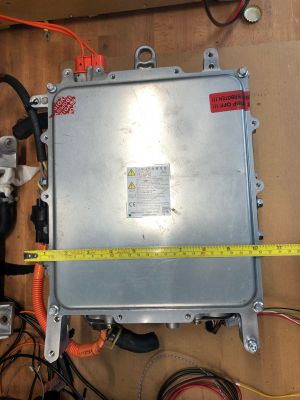

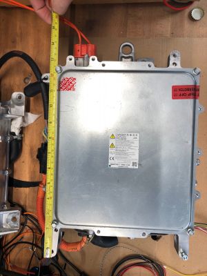

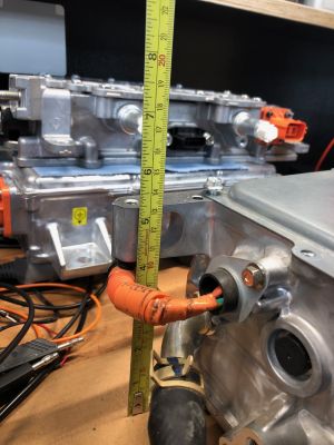

Dimensions
* Length 370mm * Width 270mm * Height 150mm
