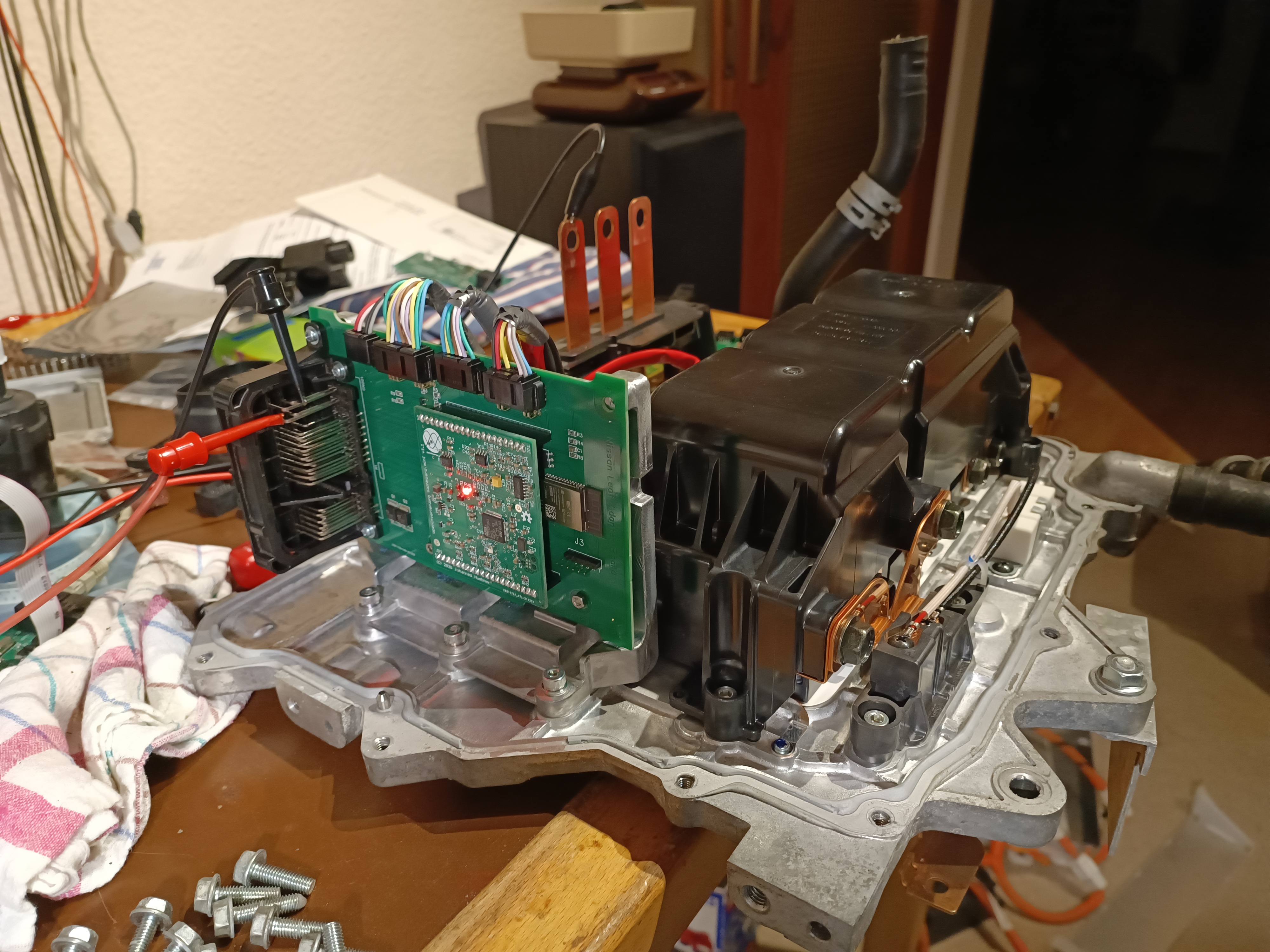

Today I was victim of my own code. I did some test driving in Touran which includes flashing new firmware from time to time.
So flashed firmware (wasn't parked in my own driveway, of course) and afterwards had no CAN comms, no parameters on wifi etc. Ok, no problem I thought I'll just flash again. Nothing, again nothing and again...
So towed the car back home. Flush coolant, take charger and aux inverter out, remove inverter and put it on the table.
When I opened it and powered it I found the alive LED blinking happily. WTF?
Tried again, no parameters via wifi. So plugged in a serial cable and restarted. What do I see?
In other words, instead of getting the inverter out I would have just needed to type "enableuart 0" into the custom command field. Maybe time to remove that feature, don't think it's being used.

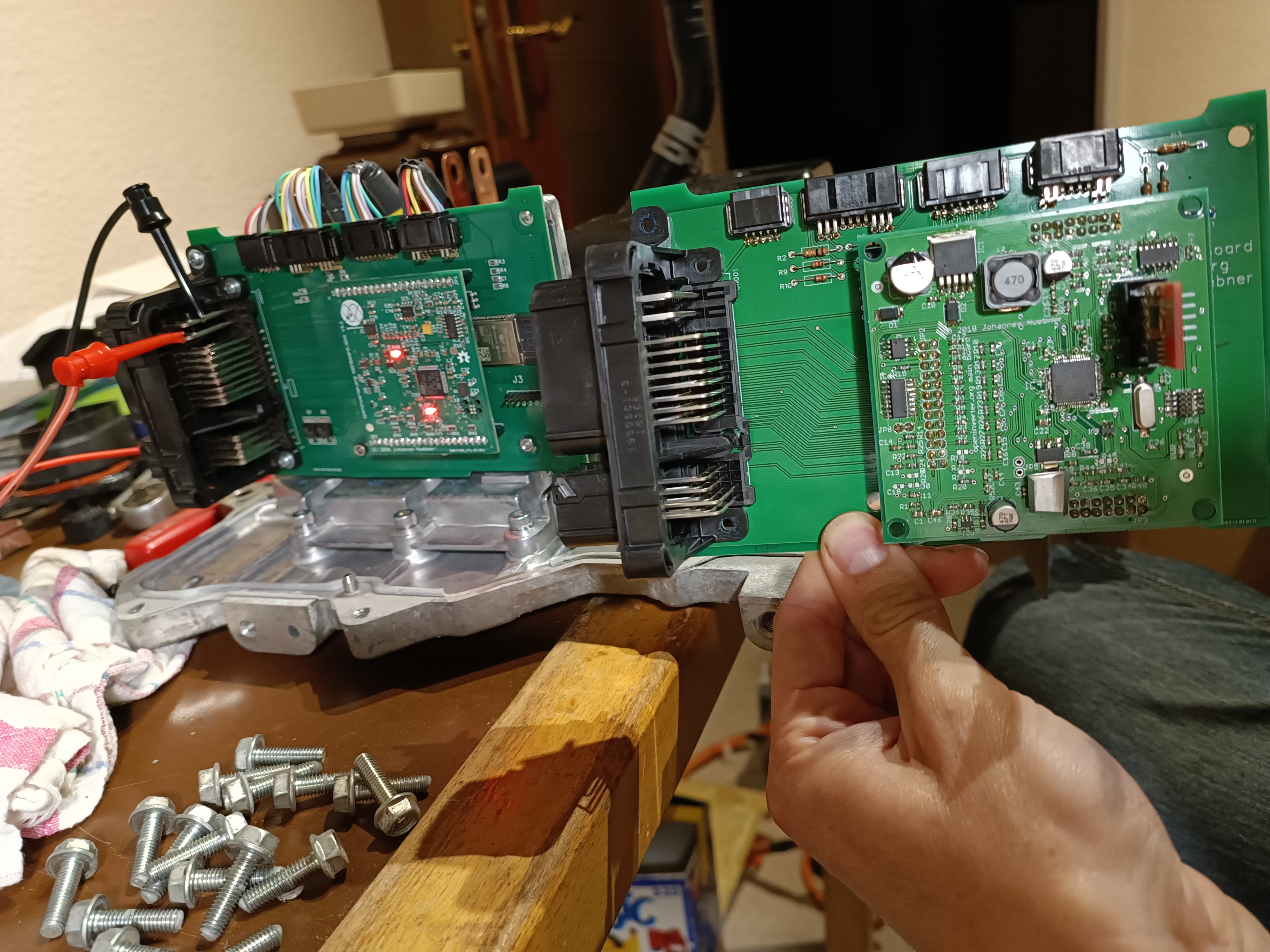

Now since the inverter is out anyway I decided to upgrade it with the latest and greatest Leaf board that uses the ESP32 and mini mainboard.
Now I can auction off the original that I did virtually all FOC development on. Kurt Cobains guitar in terms of motor control. I'll become a millionaire.
EDIT: extra value for the hand soldered SMD and resolver amplifier heat sink made from a tea candle cup.
