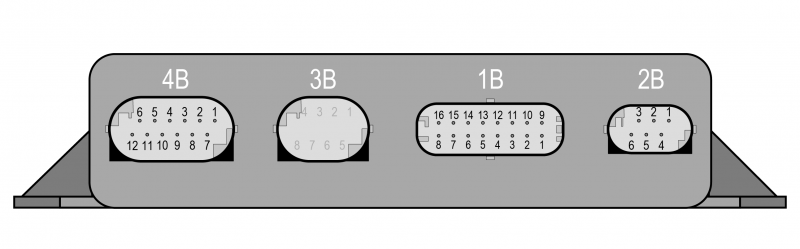

Connectors and Pinouts
All connectors are available at https://www.auto-click.co.uk/ worldwide.
| Label | Description | Compatible Plugs |
| 4B | 12 Pin Connector | BMW 61138373632
Audi 4E0 972 713 TE 1534152-1[1] / 1534151-1 |
| 3B | 8 Pin Connector (CHAdeMO models only) | BMW 61138364624
Audi 4F0 972 708 TE 1-1534229-1 |
| 1B | 16 Pin Connector | Hirschmann 805-587-545[2] |
| 2B | 6 Pin Connector | BMW 61138383300
Audi 7M0 973 119 |
| X | Replacement Pins | 5-962885-1[5] |
| X | Rubber Seal | 1-967067-1[6] |
| X | (for the connector on the i3's Charge Port Cable Lock, |
| Pin # | Function | Description |
| 1B-1 | LED_S | Charge Port Lighting (not necessary) |
| 1B-2 | - | |
| 1B-3 | LED_M | Charge Port Lighting (not necessary) |
| 1B-4 | LOCK_MOT+ | Charge Port cable Lock Motor |
| 1B-5 | LOCK_MOT- | Charge Port cable Lock Motor, and reference for 1B-16. |
| 1B-6 | CAN_H | Powertrain CAN |
| 1B-7 | CAN_L | Powertrain CAN |
| 1B-8 | IGN | Wake up signal +12V (ignition, contact 15) |
| 1B-9 | VCC | Constant Power +12V |
| 1B-10 | GND | Ground |
| 1B-11 | - | |
| 1B-12 | - | |
| 1B-13 | - | |
| 1B-14 | - | |
| 1B-15 | CHARGE_E | Goes to KLE. Guessing this is charge enable or drive interlock signal? |
| 1B-16 | LOCK_FB | Charge Port cable Lock Feedback (1k unlocked, 11k locked), referenced to 1B-5[7]. |
| 2B-1 | CP | Pilot (charge port) ~620 ohms to GND is needed if no original i3 charge port is used! |
| 2B-2 | PP | Proximity (charge port) |
| 2B-3 | Jumper | Connected to Pin 4 |
| 2B-4 | Jumper | Connected to Pin 3 |
| 2B-5 | GND | Ground (charge port) |
| 2B-6 | US CCS1 version connected to 2B-2 |
3B Pinout:
- N/A (for CHAdeMO only)
| 4B-1 | POS_CONT+ | Positive HV Contactor Control (Contactor coil resistance needs to be ~15 ohms) |
| 4B-2 | NEG_CONT+ | Negative HV Contactor Control |
| 4B-3 | POS_CONT- | Positive HV Contactor Control |
| 4B-4 | NEG_CONT- | Negative HV Contactor Control |
| 4B-5 | U_HV_DC | Charge Port DC Voltage (current input 3-20mA?)(1.42V for 0V HV, linear to 4.8V for 500V HV)[8] |
| 4B-6 | LED_RT | Red charge Status Light (12V RGB LED) |
| 4B-7 | LED_GN | Green charge Status Light (12V RGB LED) |
| 4B-8 | LED_BL | Blue charge Status Light (12V RGB LED) |
| 4B-9 | LED_GND | Charge Status Light Ground (common cathode of RGB LED) |
| 4B-10 | COV_MOT- | Charge Port Cover motor (Not necessary) |
| 4B-11 | COV_MOT+ | Charge Port Cover Motor (Not necessary) |
| 4B-12 | COV_FB | Charge Port Cover Feedback (connect to GND to simulate open cover[9])(To be left floating for contactors weld test) |

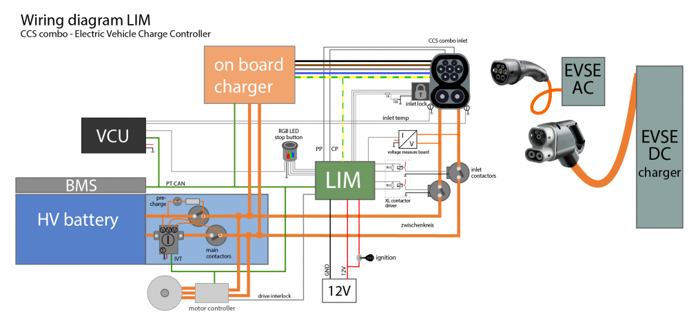

Wiring Diagram
Note [18Jun2022 ALS]: In the above diagram, some details may be non-current, eg the Charge Port Cover sensor is not shown, but its line @ 4B-12 must be floating (signalling that the Charge Port Cover is closed (?)) in order for the LIM to proceed with its welded contact tests; 4B-12 is tied to Ground (?) to indicate that the cover is open[10].
Wiring notes
Make sure you mount the LIM as close to the charge socket as possible and keep the pilot wire separate from the high power wiring.
Bad pilot wiring can result in SLAC, PLC, or other communication problems.

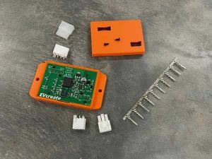

Isolated DC charge inlet voltage sense board
The LIM gets the inlet DC voltage from a board in the KLE.
This board needs to produce an isolated 3-20mA current signal (or: 1.42V for 0V HV, linear to 4.8V for 500V HV)[11] from the high voltage DC voltage.
A circuit of a voltage sense board is shared here and can be purchased here.
An alternative voltage sense board is available here.

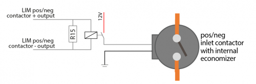

Larger contactor control
If you want to use larger contactors with PWM economizer or dual coil, use small relays to drive them and place a 15 ohm resistor (with heat sink) in parallel with each to simulate the original contactor coil's impedance.
Each of the two 15 ohm resistors must dissipate ~6W @ 13.4V, 50% PWM.
Further investigation is needed to find out if the LIM also detects a contactor failure via the current draw.

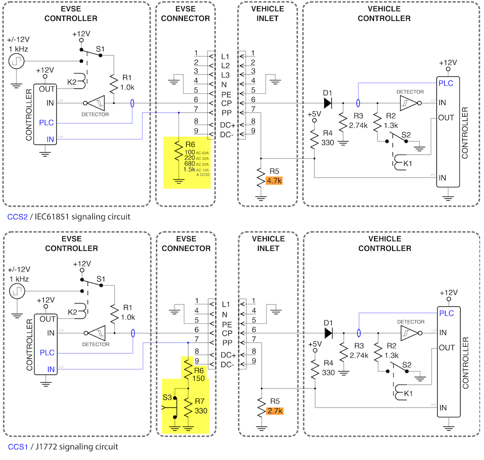

Charge port

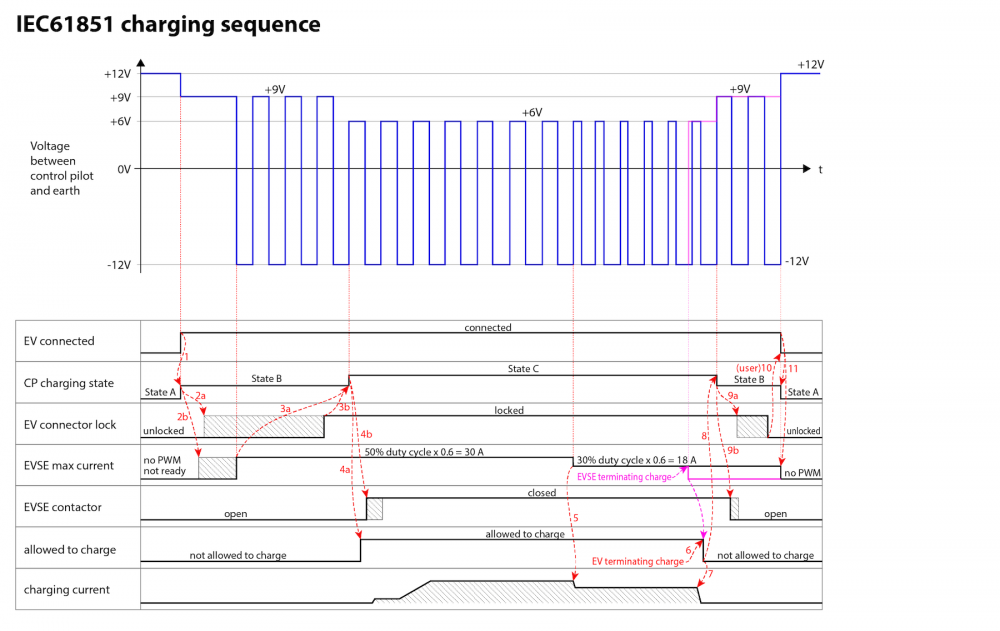

SAE J1772 (US) and IEC 61851 (international) cover the general physical, electrical, communication protocol, and performance requirements for the electric vehicle conductive charge system and coupler.
https://en.wikipedia.org/wiki/SAE_J1772#Signaling
The original BMW i3 Type 1 charge port has 2.7 kΩ between PP and PE and no connection between CP and PE, as J1772 describes.
The Type 2 charge port used in Europe probably has 4.7 kΩ between PP and PE. (from Phoenix datasheet. Not confirmed!)
Make sure to match these if you want to use a different charge port. Some brands use different resistor values.
The CP communication is similar for US Type 1 (1-phase) and EU Type 2 (3-phase) charge ports, but the PP circuit is different.

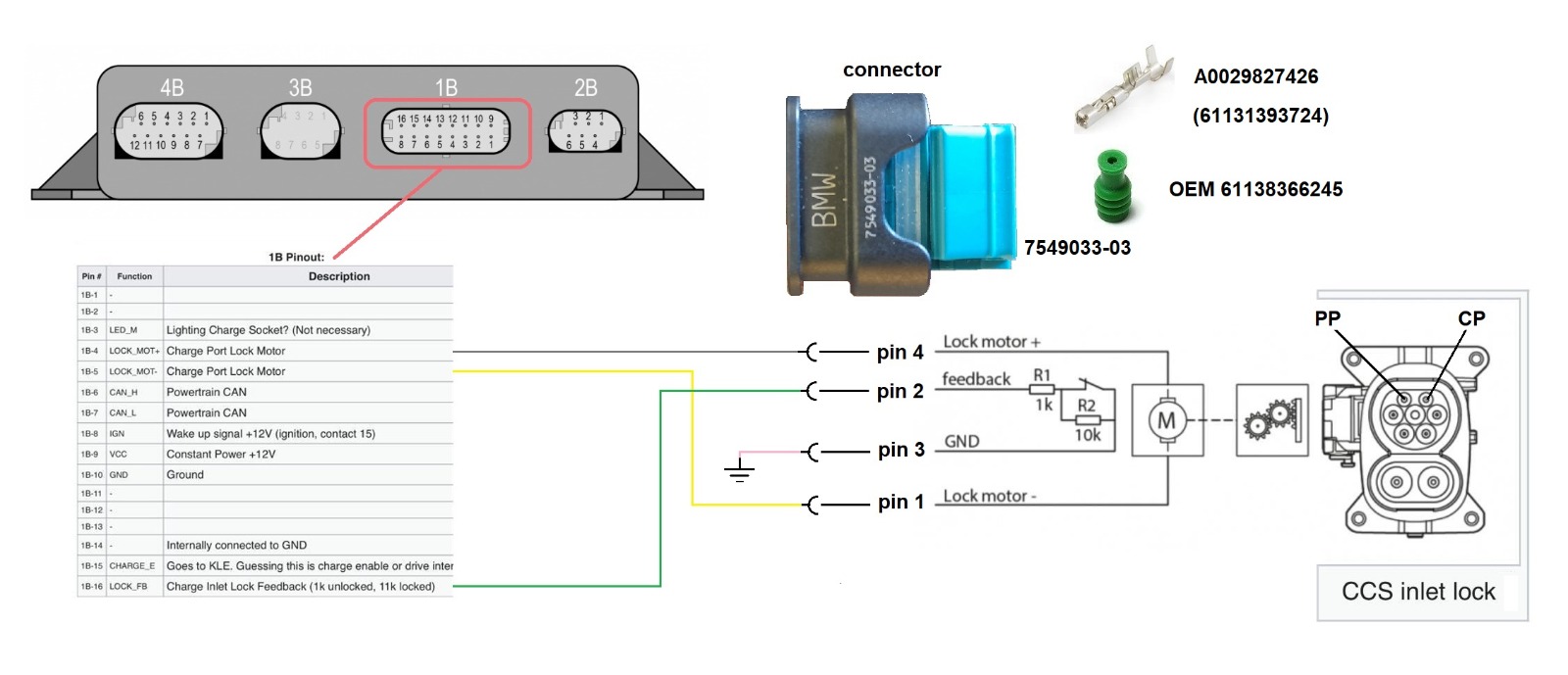

Charge port lock
In the BMW i3 a quite expensive Phoenix/Delphi CCS charge port is used and it would be nice to be able to use the cheaper Duosida CCS charge ports.
The charge port lock should work with the Duosida lock as well but the feedback (1k unlocked, 11k locked) is a bit different which requires some additional resistors.
If using an OEM BMW i3 CCS charge port, the Kuster cable lock uses these connector parts:
- Connector shell: BMW 12527549033 (ref. jon volk) or Hirschmann 805122541 (ref. Sidemips[12])
- Terminals: BMW 61131393724
- Terminal seals: BMW 61138366245

The EVSE (charging station) shares its charging capacity limits via PWM during IEC 61851/ J1772 AC charging, or via PLC during DIN 70121 or ISO 15118 CCS sessions, but often the car cannot handle the max available power of the charging station.
The actual battery voltage and battery current values are needed by the LIM to check the response of the charging station. In this setup, the battery voltage and current are measured by an Isabellenhütte IVT CAN bus sensor, but these values could also be measured and shared on the CAN bus by the BMS. (CAN message 0x112)

Signaling circuit
AC charging
Usually the J1772 (US) or IEC61851 (EU) protocol is used for AC charging.
Some new charging stations support AC charging with ISO 15118 high level protocol as well, but it is not confirmed which versions of the LIM support it.
By default, the the EVSE (charging station) outputs +12V on the CP pin, and when connected to an EV will be reduced to 9V because of a load resistor present in the Electric Vehicle; this signals the EVSE that the connector has been plugged into a EV. After this, the EVSE will send a 1khz +12V to ‐12V square wave (PWM signal) and the duty cycle value corresponding to the maximum current it could deliver. If the EV is okay with that value of current, then it performs a handshake by changing the load resistance and dropping the PWM voltage to 6V, after which the charging begins.
In IEC61851, where untethered charging stations are allowed, the PP pin is used to detect the maximum power rating of the cable.
In the US, with J1772, where charging stations need to be tethered, the PP pin is used to detect if the manual unlocking mechanism is pressed, to stop the current flow before the plug is removed.
More information: https://en.wikipedia.org/wiki/SAE_J1772
