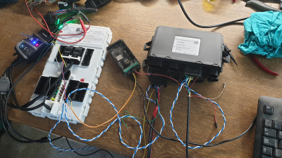

So now that I have a workbench again I'll be tackling the brand new LIM programming seeing as no one (to my knowledge) has done so or if so was not shared. As per my previous posts the plan is to use the i3 BDC , key and BDC simulator to allow ista-p program the module. No idea how to do this of course so follow along as I stumble blindly forward. Anyway, a new LIM was collected today from my (new) local friendly BMW dealer for the total sum of 241.42 Euros. Damn cheap for an OEM proven CCS controller if you ask me but then again what do I know ...

You will need to get hold of a programmed one. If I'm correct you can read that config to your desk. Save it. And load that one into the new LIM if you go bare instantion i think you will need more devices to assemble a car config.

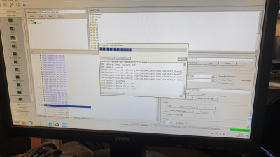

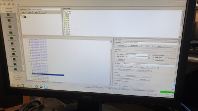

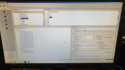

New LIM programming in progress. With CAN capture of course so with luck can be just done via CAN in future so no need for BDC etc.

What 10 minutes.
Didn't take all the Weekend. Next testing?

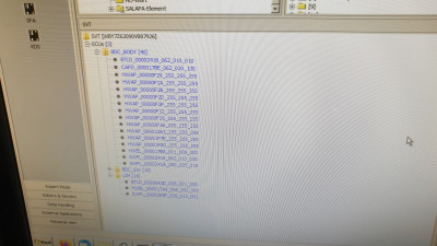

Yeah I'll test it in the goose to be sure its working. Not a big deal to program. I'll make a video tomorrow with details on how to diy and might offer it as a service.

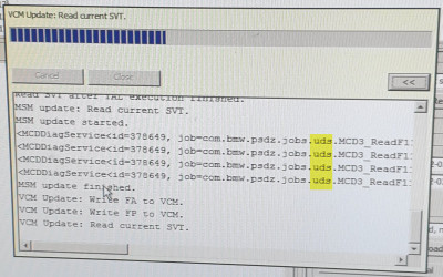

While trying to understand what the screenshot of the programming log tells I found this post which is not really related but still explains a bit...
The UDS jobs might only be to communicate with the BDC.
It might be useful to have the whole programming log.
https://f30.bimmerpost.com/forums/showt ... ?t=1318616E-sys installation instructions suggest to un-check "Update VCM" & "MSM." These stand for Vehicle Configuration Management & Master Security Management, respectively. They are part of ZGW (Zentrales Gateway), which stores everything which happened with the car, including some codings.
It is not necessary to tell your car everything you do. You cannot change the calculated values, like last coding date, in CAFD files. But, disabling these two functions, minimizes the record of what is written to vehicle.
ZGW will be read each time a vehicle is connected to an online ISTA+ (Diagnostic Software) in a service station and collected data is transmitted to BMW AG. So, to avoid further problems with BMW, we switch of the actualization of VCM and MSM.

now that i know what UDS is i found it. CAN address 6F4h sends to the LIM, which responds with 614h.
