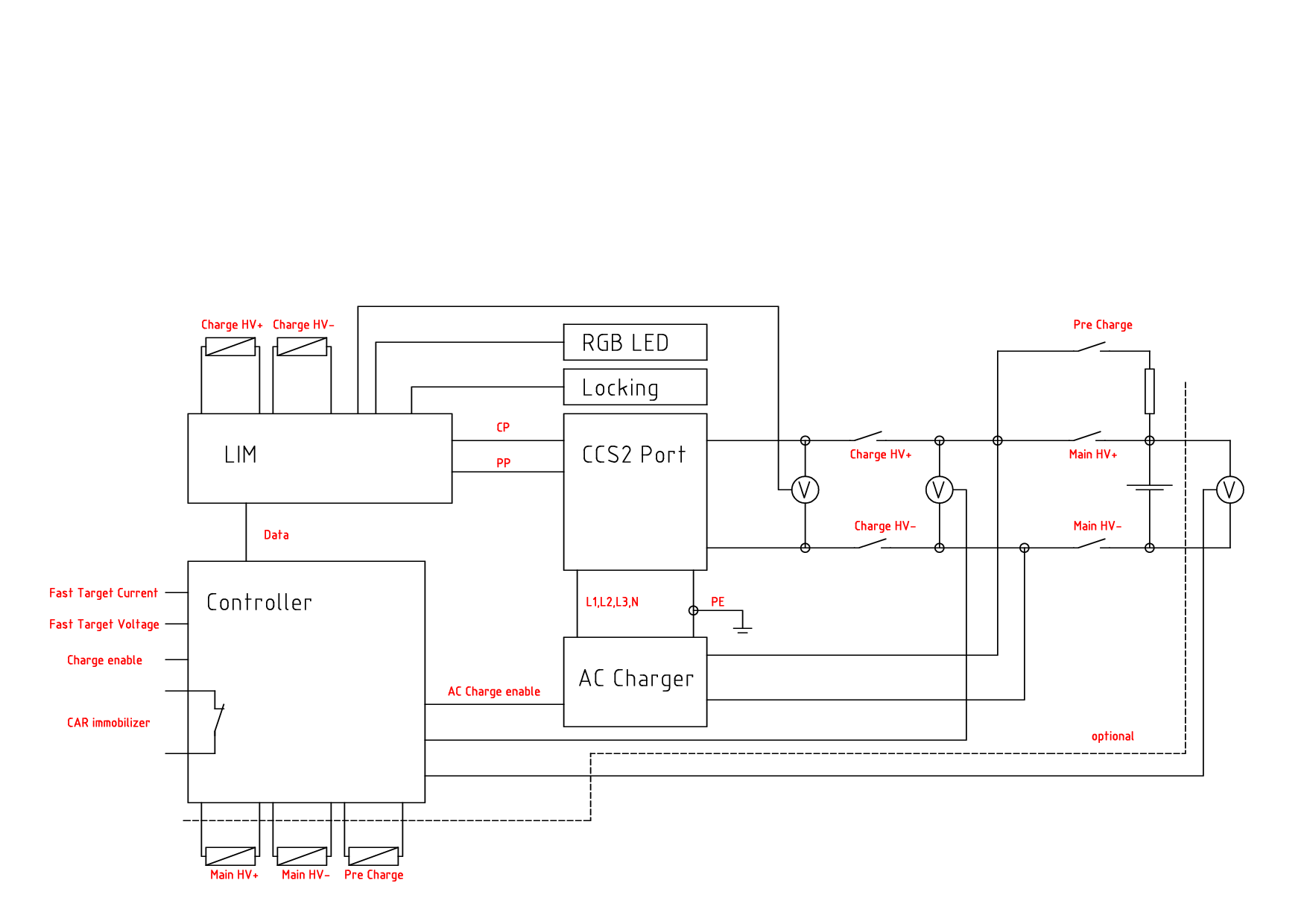

I'm currently working on a controller for the BMW charging interface module (LIM). These modules are easy to get on Ebay and are new available for €230.-. At the moment the reading of CP and PP works and the control of LEDs and locking. Next I will go to a public charging point and test the PLC communication.
here is the concept:

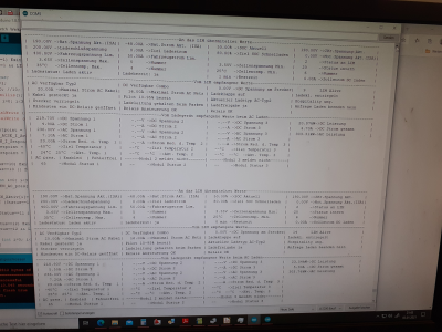

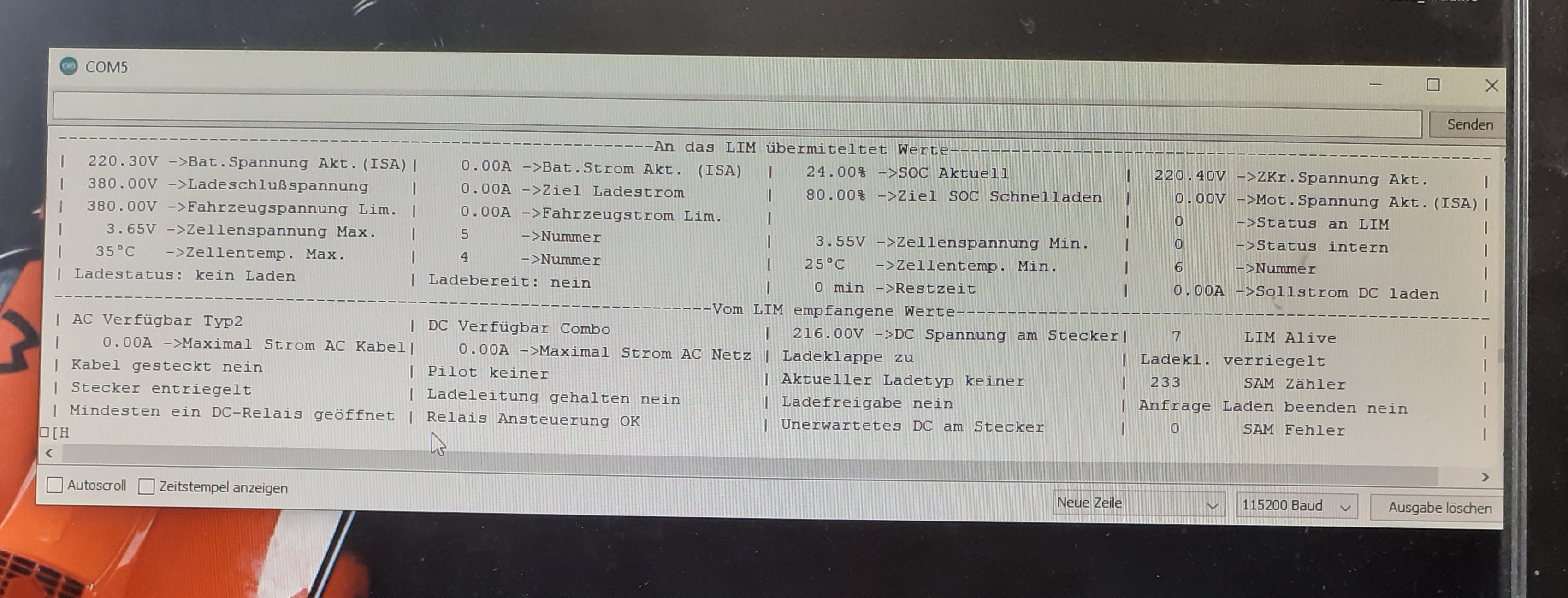

A little update. I am still determined to use this controller in my project. I have an arduino programmed to communicate with the LIM. AC charging is already working. The arduino also controls my Tesla GEN3 charger and receives data for voltage and current from the ISA shunt. The LEDs that in the i3 indicate ready, initialize, charge, end of charge and errors are working correctly. The connector lock also works. The i3 LIM does not use a closing contact to query the locking, as DUOSIDA, but wants 11kOhm locked and 1kOhm unlocked,
like Phoenix. The communication with the DC charging station has not yet worked. The LIM does a weld detection, for which it controls the contactors individually and measures the voltage at the contacts. For this test, the loading flap must be closed and locked (simulated in my case).

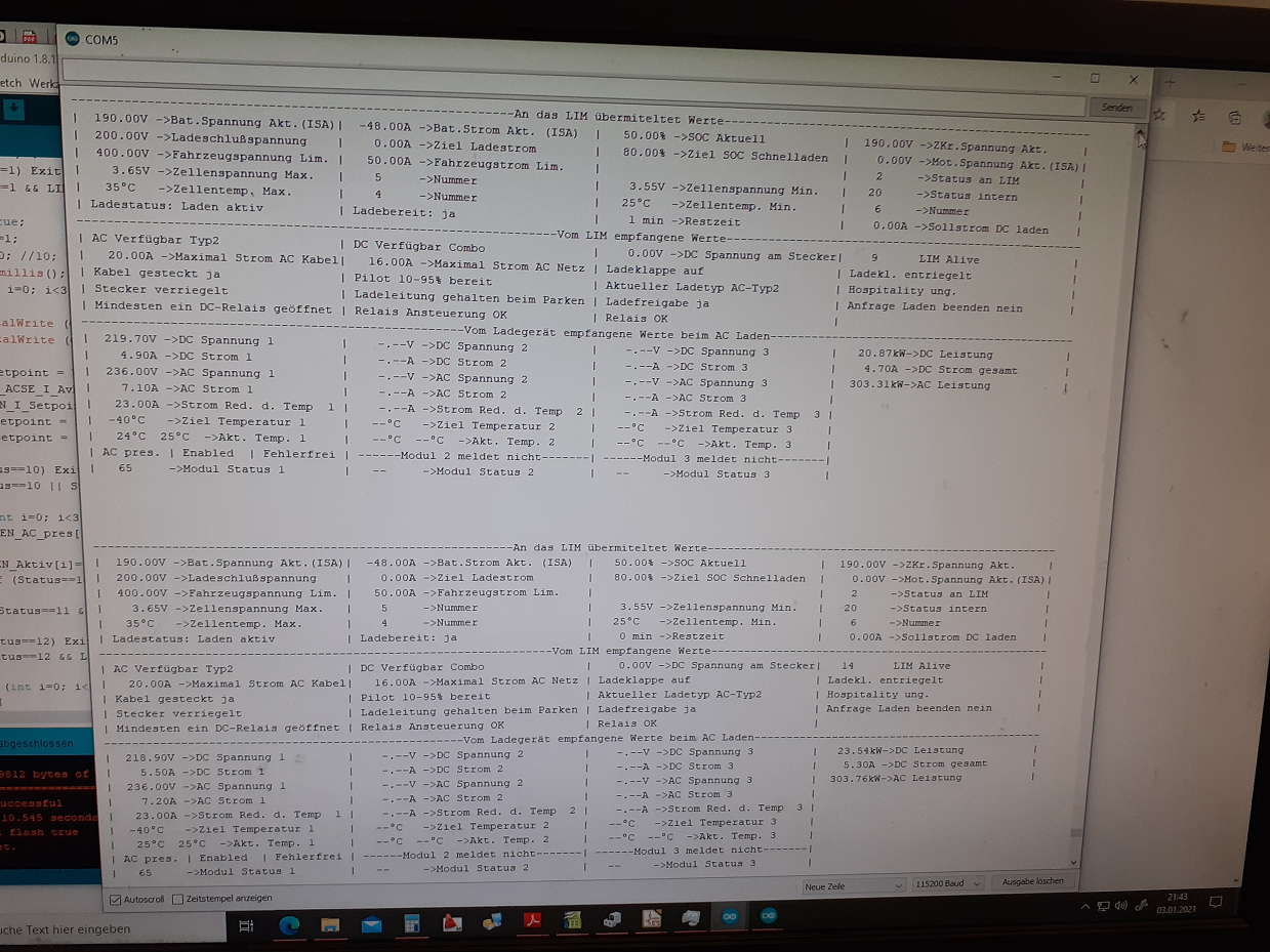

Jack Bauer wrote: Tue Mar 02, 2021 2:17 pm I know you can't share the details but is the available AC charge current from the evse sent via can from the LIM? I ask just for the sake of wiring my car:)

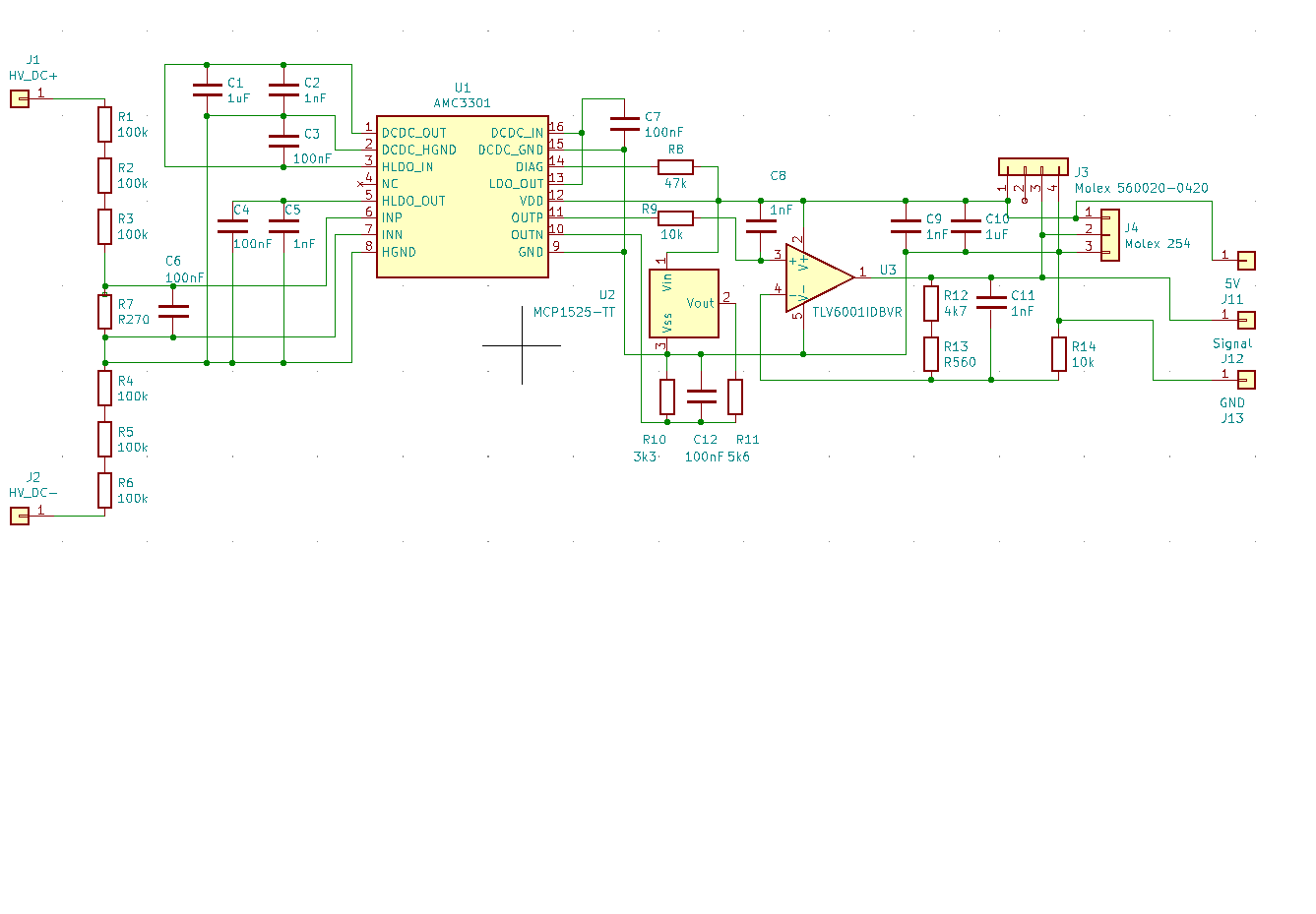

If you look at the second block you will see "vom LIM empfangene Werte"", that is, received from the LIM via CAN. The current for the cable and EVSE are determined by the LIM (16A and 20A in my screenshoot), just like whether the plug is plugged in or not. "DC spannung am Stecker" is the voltage measured via U_HV_DC as I postet, 1.42V for 0V HV linar to 4.8V for 500V. anything between 0.3V and 0.8V will be displayed as "AC or negative DC". Maybe you can check if my little circuit does that, because you are certainly more of an electronics engineer than me.

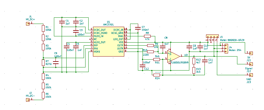

i changed my circuit a little and now it's fine. The circuit is required to measure the voltage at the charging connector and to pass it on to the LIM

muehlpower wrote: Tue Jun 01, 2021 1:01 pm i changed my circuit a little and now it's fine. The circuit is required to measure the voltage at the charging connector and to pass it on to the LIM
You mean in order to save us an extra donor device / pcb right?
Its the famous 'current' signal?

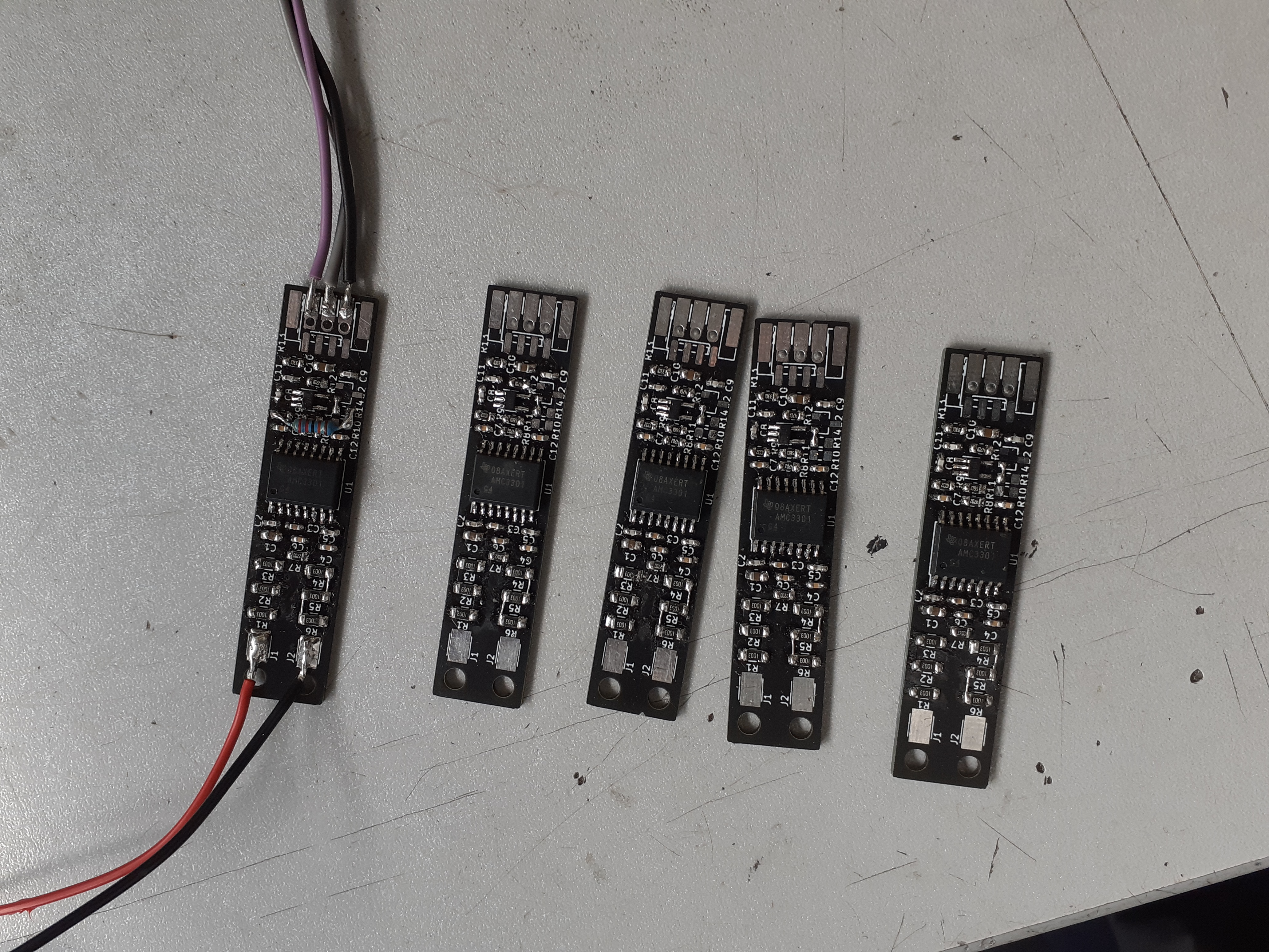

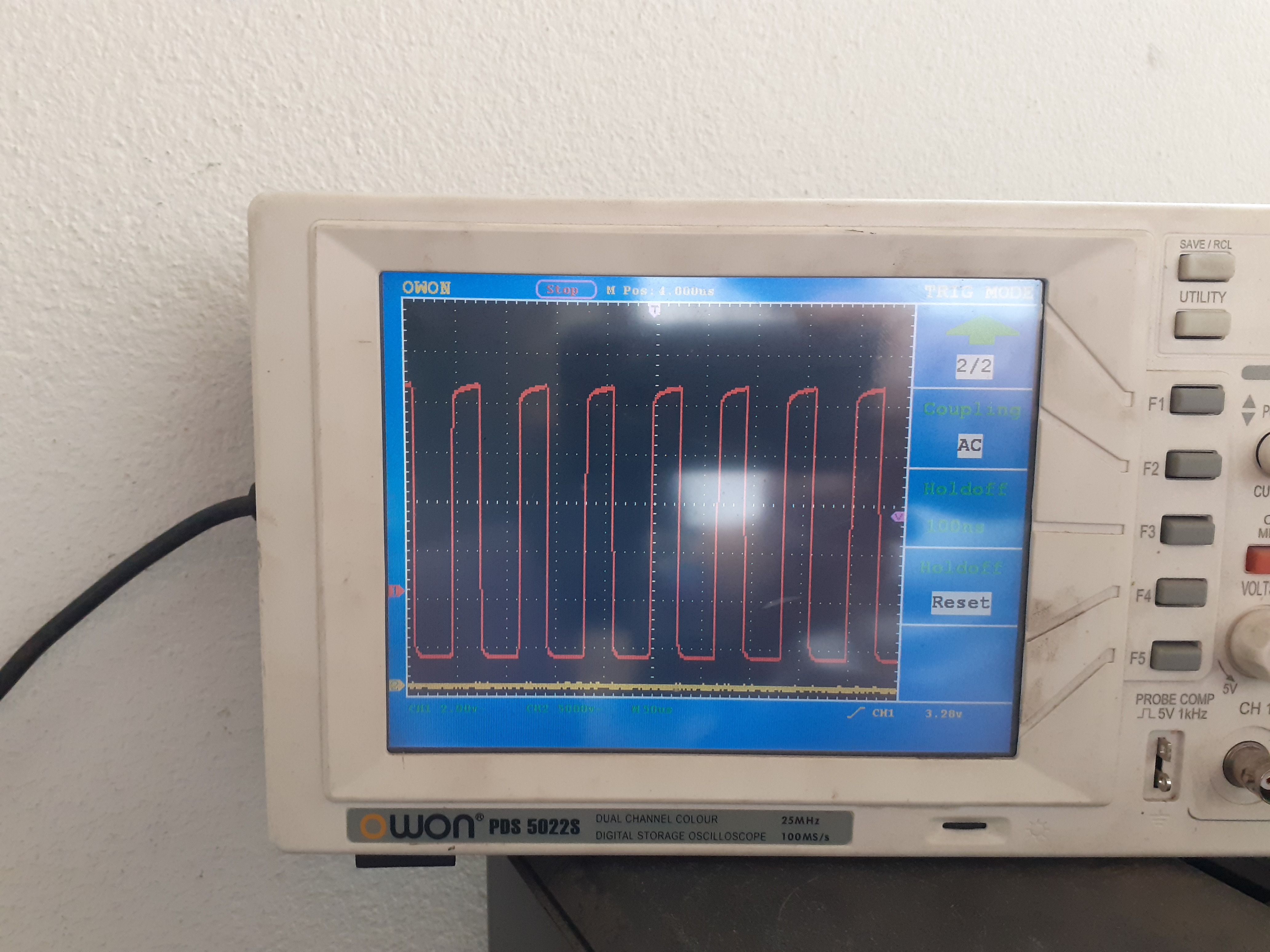

The Contactors are controlled by PWM, as jou can see at the OSZi, so it would be fine to use contactors without economizer, like the original Tesla model 3.
The first prototypes for voltage measurement are ready. In the screenshoot "DC spannung am Stecker" compared to "Bat Spannung Akt." measured by the ISA shunt. It seems the LIM only works on voltages above 200V.

Jack Bauer wrote: Thu Jun 03, 2021 11:56 am At least they are honest about it unlike chademo. Will you be selling those boards muehlpower?
May be. Unfortunately, jlcpcb does not have the transmission amplifier in its range. I can send you a sample if you want.
