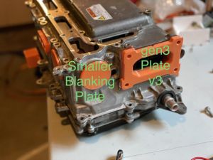

added pictures of 3d printed part locations |

3D Printed Parts
User bobby_come_lately has created a fair few 3D printable parts for use with the inverter. They can be downloaded https://github.com/jamiejones85/Gen3PriusInverter3DParts
More information on these parts can be found in this forum post https://openinverter.org/forum/viewtopic.php?t=836
3D Printed Part Locations
