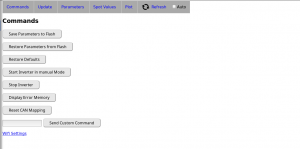

Commands
Save Parameters to Flash saves the current parameter values and the CAN message configuration onto the embedded flash. In other words, if you make changes to the latter and do not hit this button your changes will be lost at the next power cycle.
Likewise, Restore Parameters from Flash will do the opposite, it will load the last saved parameter values and CAN configuration from flash memory in case you messed up your configuration
Restore Defaults = factory reset. You can see the default values in the table below.
Start Inverter in manual Mode Just turns on the PWM. It takes parameters ampmin and flslipspnt and runs the motor closed loop. It does NOT close the DC switch, ignores throttle input and does not check for various start conditions. Careful!
Stop Inverter - just that
Display Error Memory - shows the latest 4 errors. Errors are only reset by power cycling. See: Errors for list of errors.
Reset CAN Mapping - Deletes all CAN configuration
Send Custom Command - since not all terminal commands are brought out to the web interface you can enter them here. Like adding the hidden flag to channels

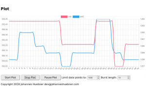

Plot

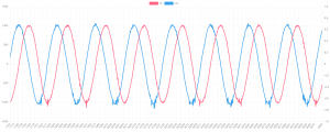

Finally maybe the best part, the plotting facility. It lets you plot as many signals as you want at the appropriate update rate. The fewer signals you select, the higher the update rate. The ESP8266 communicates with the STM32 via a 1 MBit/s serial link. So with the highest burst length you can plot one signal at roughly a 100µs time resolution. That is in real time. You can easily see the sine wave character of the current sensors that way.
The Limit Data points to field lets you specify how many data points per signal are displayed in the plot a once. It is limited to 10000 points. The Burst Length lets you specify how many data points are obtained from the inverter at each polling cycle. So for long term plotting you would limit the data points to 10000 and have a burst length of 1. This would fit roughly 40 minutes of data in one screen (one poll cycle takes roughly 250ms). For real time plots you would limit to 1000 points and poll 1000 points. It will look like a slowly updating scope and give you about 100ms of data.
