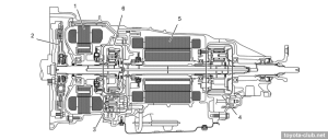

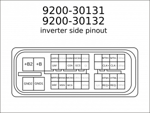

1 - motor-generator MG1, 2 - input shaft, 3 - power split planetary gear (PSD), 4 - intermediate shaft, 5 - sun gear (MSR), 6 - ring gear (MSR), 7 - output shaft, 8 - planetary carrier (MSR), 9 - motor speed reduction planetary gear (MSR), 10 - pinion gear (MSR), 11 - motor-generator MG2, 12 - planetary carrier (PSD), 13 - ring gear (PSD), 14 - pinion gear (PSD), 15 - sun gear (PSD)
1 - motor-generator MG1, 2 - damper, 3 - mechanical oil pump, 4 - motor speed reduction planetary gear, 5 - motor-generator MG2, 6 - power split planetary gear (PSD)

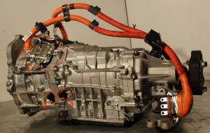

Left hand side
Left hand side connections
  1. MG1 3-phase power connection
  2. MG1 resolver (and temperature) port
  3. MG2 resolver (and temperature) port

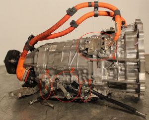

Right hand side
Right hand side connections
  1. Input/output from/to oil cooler radiator
  2. Mechanical shifter and shift sensor port
  3. Ground strap
  4. MG2 3-phase power connection

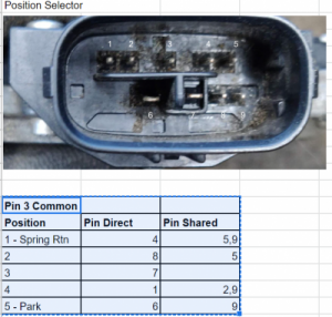

Shift sensor
part number: 89451-30010
Connector: SUMITOMO 90980-12362
Position 1 being the sprung return and 5 being park
Pin 3 is common, you can see there is a direct connection to
a pin for each position and a secondary connection to either 2,5,9
this could be used as an error check[10]

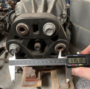

Output flange
Bolt pattern: About 100mm from hole to hole (~58mm radius) (compared to GS450H's 91mm (or 52.5mm radius)).
The hardy disk shown on the picture is hard to come by. Lexus in Europe only sells it with a new driveshaft (3000+€). It appears you can get it from Japan for around 100€, otherwise there is overpriced used ones on Ebay. Ensure, you can buy it with your motor.
