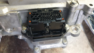

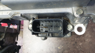

I'm guessing the plug for the inverter data is unobtanium as per the gs450h ?
- Posts: 3660
- Has thanked: 10 times
- Been thanked: 334 times
Re: L210 gearbox

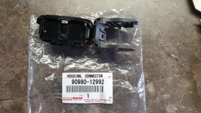

Nobody? that's ok I did the leg work. Toyota p/n:90980-12992. Ordered from my (new) friendly local toyota dealer for approx 20 euros. Will have it in a few days and report back. Now to find the pins ...
- Posts: 3660
Re: L210 gearbox
Looks like :
Plug : 90980-12992 - 20eur
Seals to plug unused : 90980-09871
Terminal 1 - 82998-24250
Terminal 2 - 82998-12790
Terminal 3 - 82998-24420
Ordered from Toyota and will report back in a few days.

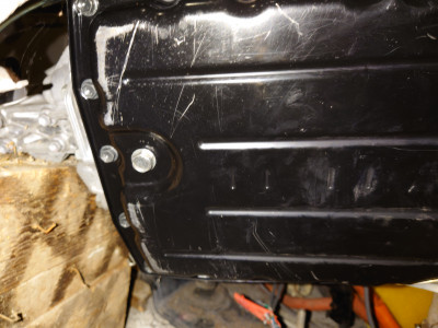

Anyone know how to change the oil on this gearbox? Mine's all on the floor:)
Re: L210 gearbox
Drain hole as usual at the bottom in the pan.
The filler hole on the side and it is also an indicator of the required level.

Ooft - just got prices back from my local Toyota dealer for those parts - all ex VAT at 20%.
90980-12992 £23.25 each
90980-09871 £6.16 each
82998-24250 £7.16 each
82998-24420 £20.25 each
FYI I added these part numbers to the wiki

You only need the connector housing from toyota. There are two pin sizes both available for a few bucks from Aliexpress :
https://www.aliexpress.com/item/4000661 ... 5R075&mp=1
https://www.aliexpress.com/item/1005002 ... mfJmK&mp=1

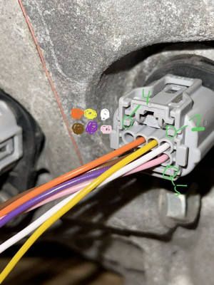

Question about resolver pinout, the numbers in the picture here (viewtopic.php?p=35989#p35989 ) don’t correspond to the cable side of the resolver connectors, which way around is the correct way?
(Suppose an easier Q to ask is are the temp sensors on the left side of the cable side of the or the right side?)
Also ignore the fact that I only have 6 wires coming out, old pic
- Posts: 3660
Re: L210 gearbox
Yep I came across this also. If I remember the temp sensors are on the wrong side of the plug in the diagram. You can tell by doing a resistance mesurement.
- Posts: 228
- Location: West Midlands, UK
- Been thanked: 13 times
Re: L210 gearbox
So just to confirm the temp sensors are the 2 I’ve left out in the photo? (Which makes sense as this pair has a reading in k ohms, all the others are in ohms)

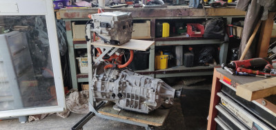

I got one too

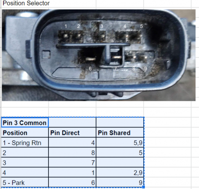

Whilst waiting for connectors to turn up I took a look at and buzzed out the gear selector switch:
part number: 89451-30010
Connector: SUMITOMO 90980-12362
Position 1 being the sprung return and 5 being park
Pin 3 is common, you can see there is a direct connection to a pin for each position and a secondary connection to either 2,5,9 this could be used as an error check
Pin numbers as per drawing:

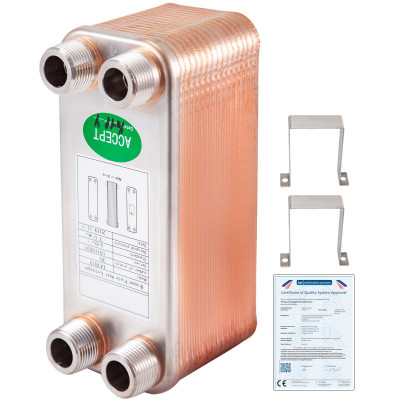

Very Exciting thread this. Got myself a L210 + Matched inverter. Plugs / Connectors on order. Still need to buy a Zombie Verter. Just getting the parts together for a build.
In doing so thought about the Cooling of the whole lot.
Would it be completely daft to run the L210 gearbox cooling line through the inverter cooling plate and then to radiator and back to the gearbox?
Could ATF damage the inverter cooling loop? Seems like a good enough plan. As long as the gearbox spins the ATF Cooling loop will be moving. Not sure if the pump is more high pressure than high flow though and if that would actually matter?
If this is not the right section , please move or delete it. Or file under Dumbass Ideas.
