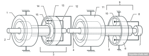

The L210 is a continuously variable transmission (CVT) which can be found in the Lexus GS300h. It is very similar in design to the GS450h CVT. It contains two motor-generators - MG1 and MG2. When used as originally intended, MG1 is spun by the ICE, via a planetary gear system, and acts primarily as a generator. MG1 also acts as a starter motor for the ICE. MG2 is connected to the output shaft via a second planetary gear system to provide traction directly to the rear wheels.
The ratio between MG1 and the output shaft is 2.6:1. The ratio between MG2 and the output shaft is 3.333:1.
The official power output of the CVT is 105kW and 300Nm of torque[4], but this has yet to be tested.
For use in a pure EV application, the ICE input shaft can be locked stationary with a plate or bar. This allows traction to be provided by both MG1 and MG2.

One key difference between the L210 (GS300h etc.) and the L110 (GS450h) is that the L210 only has an internal oil pump.
On the L210 the internal oil pump is driven by both the ICE and/or the rotation of MG2. So, even when you lock the ICE input shaft to allow MG1 to provide traction, MG2 will still drive the oil pump whenever the car moves. Since there are no gears/speeds in this CVT (and hence no clutch packs, etc.), the oil is only required for cooling and lubricating the bearings.
