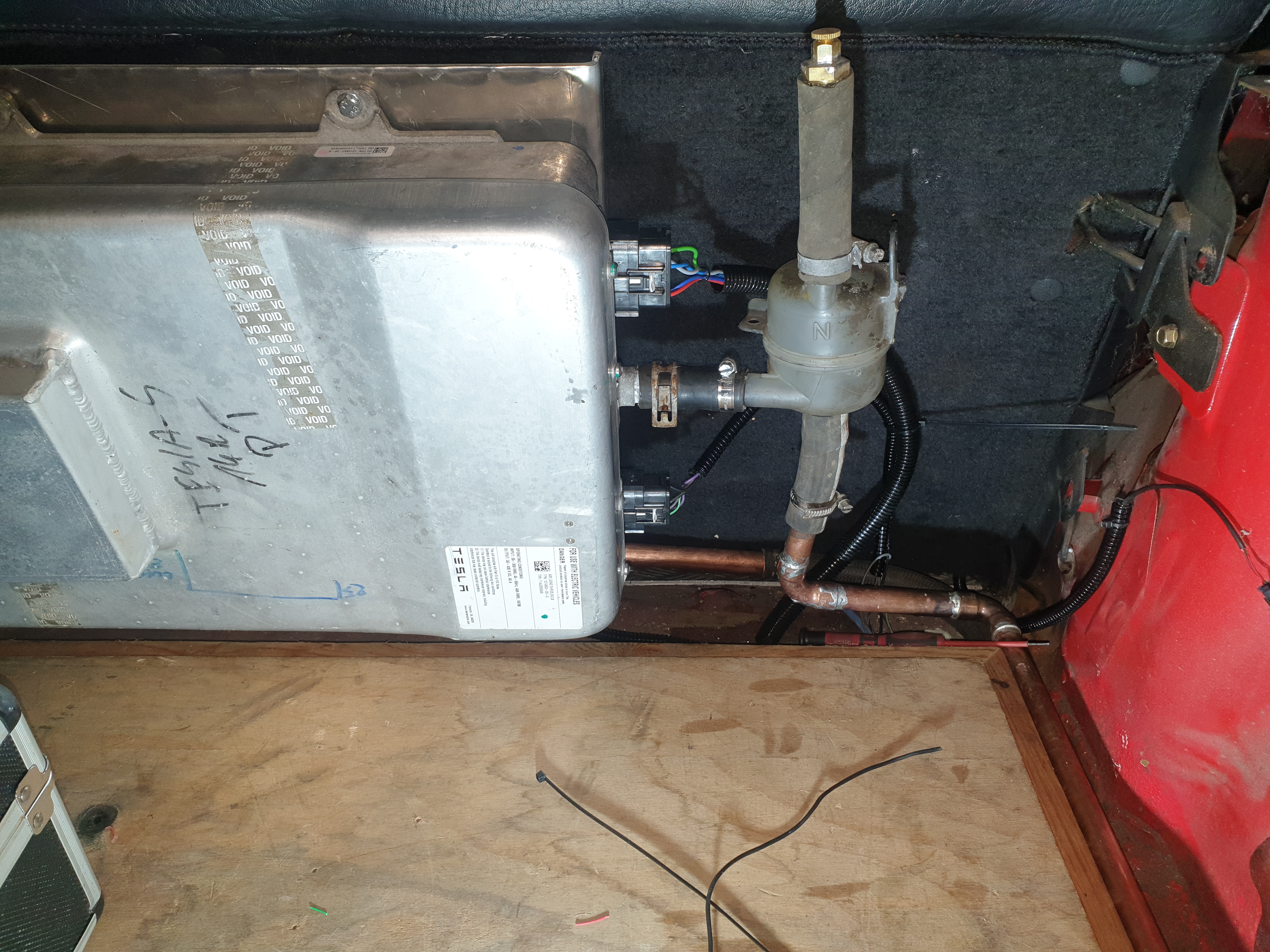

In the end i have decided to go for 2phase Outlander/Eltek chargers which will use the existing cooling circuit and main VCU that is allready there.
Dual cooling systems and VCU and control systems can cause more problems so i will streamline this as much as possible.
Additionaly the bulky charger at the back steals a lot of the trunk area. Mazda is a small car...
Since my daughter is driving this car i intend to make the experience as easy as possible.

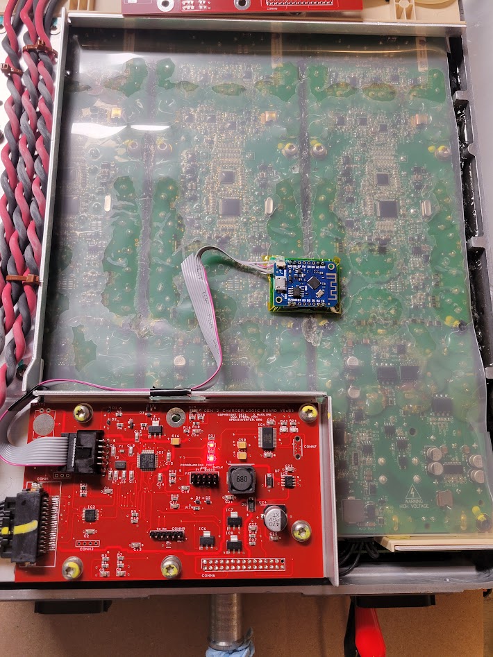

Okay, I hope this is a stupid question, but should I be seeing the LEDs on the modules with just 12v power (no AC and no HV) connected?
This is on a gen2 charger (K variant) with a V5aB3 board and the OI firmware v 1.19.R.
On the board I have LED1 flashing and LED2 solid, but nothing from the charger modules and I am assuming no communication because the temps all show zero degrees in the spot values.
I tried bringing the enable pin high and proximity pin low and saw the changes detected in the spot values, but still nothing on the modules. I did solder the CAN termination resistor and even tried a second resistor at the molex plug since some people were saying the single R120 was causing problems. Also probed the pins on the surface mount connector and didn't find any bridged pins. Checked continuity from pins to nearby vias where possible and all seemed ok.
I'm hoping that's normal but confirmation either way would be appreciated.
Finally, quick note to anyone doing this in the future, if you get the WEMOS wifi board you will need to mount it remotely. If you use the 90 degree plug it will sit too high to close the case of the charger. You can't solder the adapter directly to the board without blocking a screw hole, although you might be able to adjust the gerber to move the adapter board away from the mounting hole. My solution, at least for testing, was to solder a ribbon cable from an old 3d printer directly to the adapter board and plugged into the logic board as normal.
Posts: 2962
Has thanked: 328 times
Been thanked: 847 times
Re: Tesla Charger Support thread gen2/gen3
Zieg wrote: Tue Aug 27, 2024 5:21 am Okay, I hope this is a stupid question, but should I be seeing the LEDs on the modules with just 12v power (no AC and no HV) connected?
Only when the charger is in RUN mode.

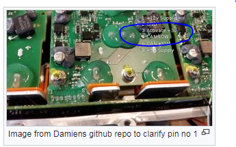

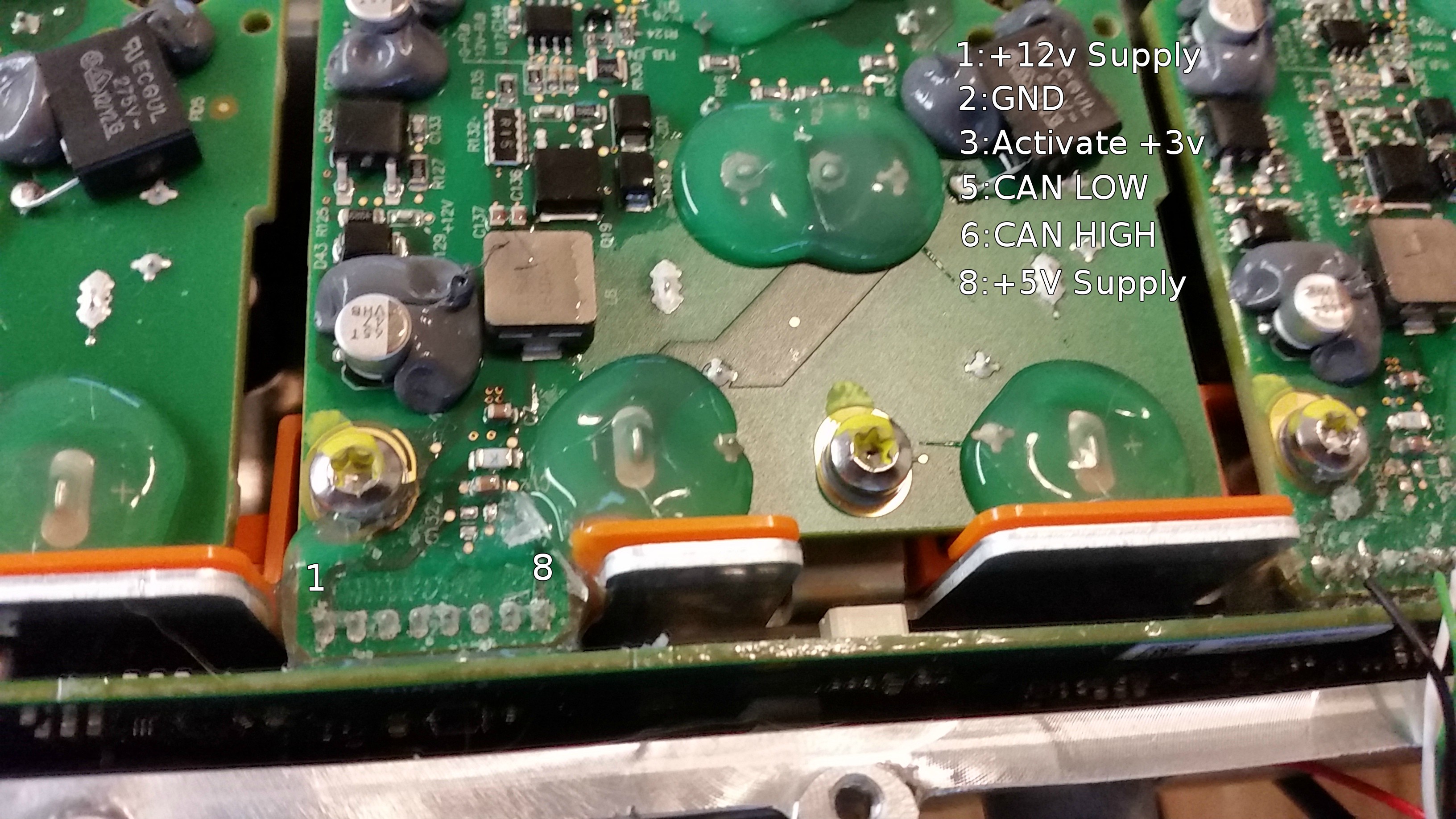

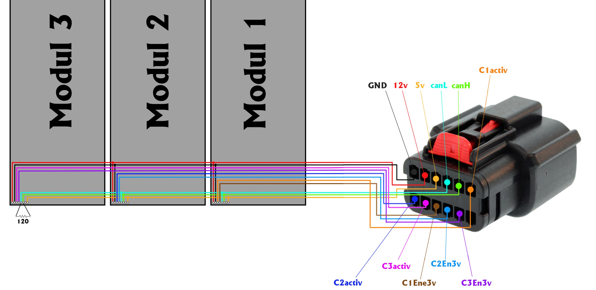

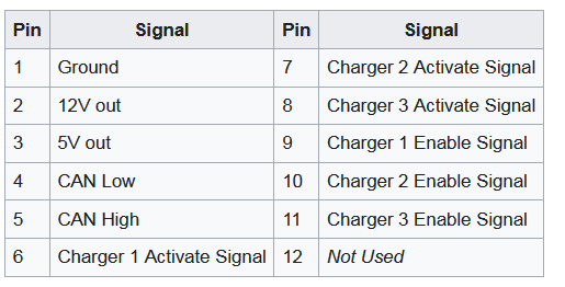

Hi All,
Please can someone clarify "Activate" and "Eanble" signals?
The Gen 3 charger Wiki pagehas this picture
which suggest that pin 3 is the activate and it needs 3V signal, but the table under suggest pin 3 to be low and pin 4 to have 3V.
I have connected my charger and when pin 3 is low (0V) and pin 4 is connected to 3V, there is no activity (both LEDs off and no CAN activity).
When I connect pin 3 to 3V, modules do come to life with one LED on (per module) and 15 different CAN messages per module. this looks like the correct wiring ar lest for my unit.
what should be the level for pin 4 ?
Thank you

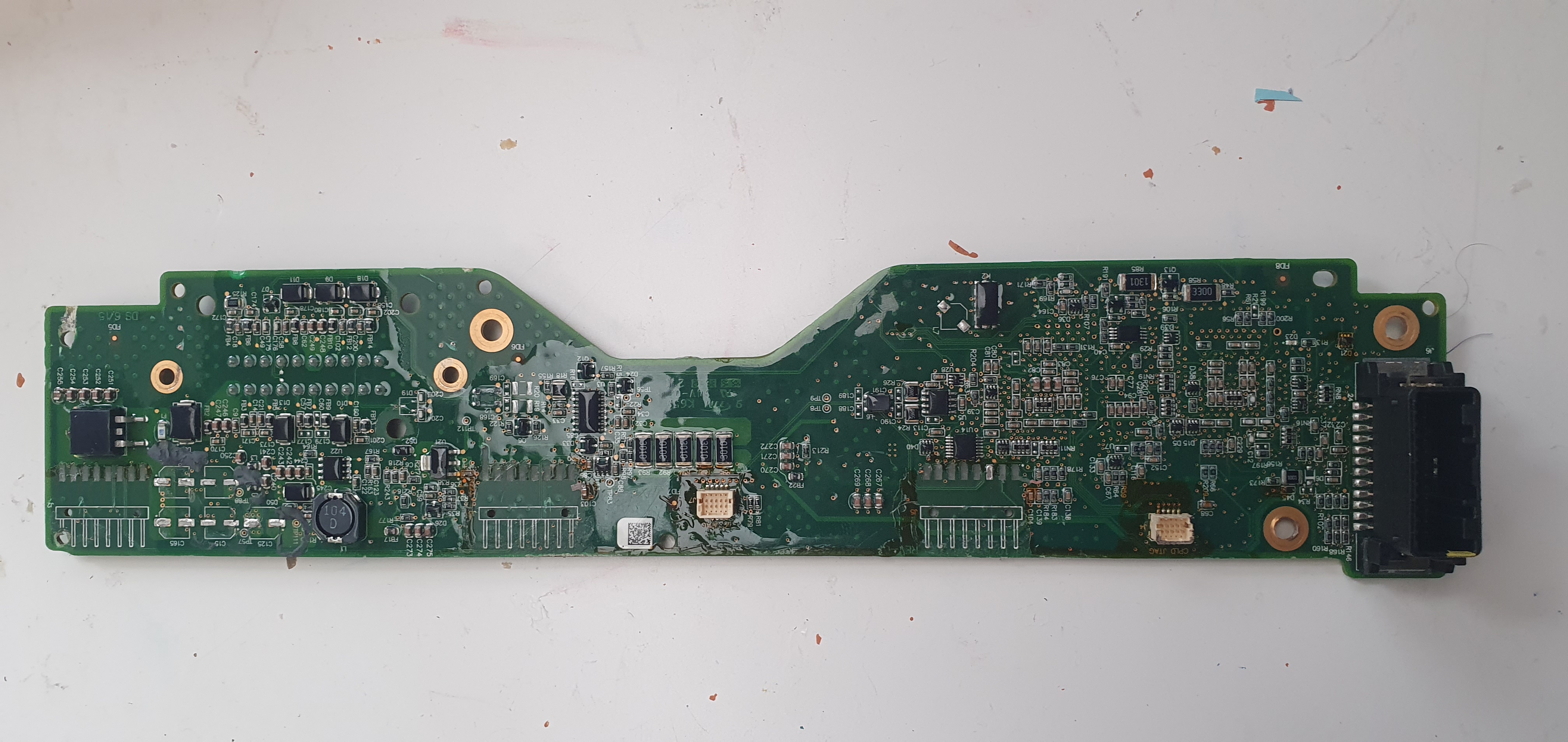

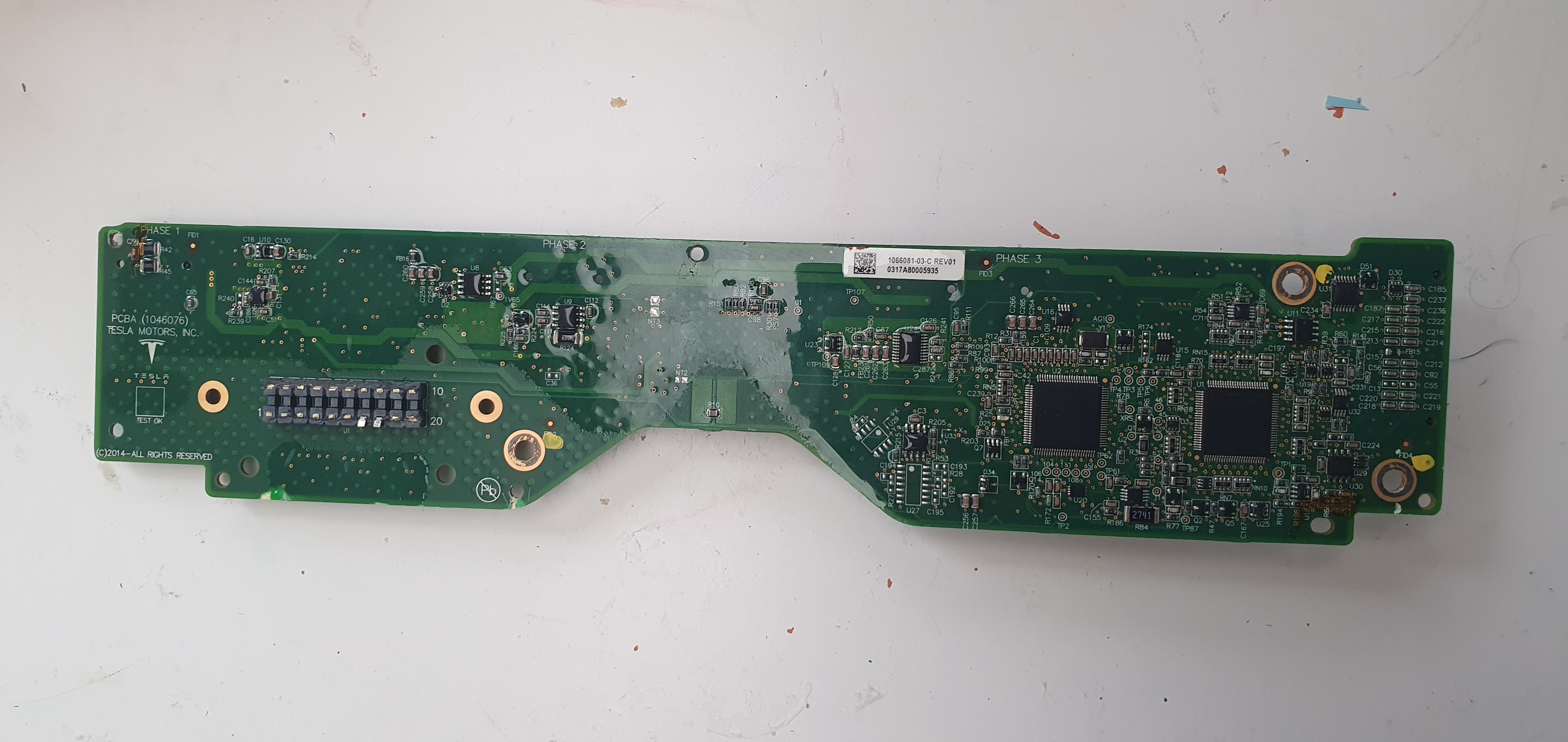

The contol board from Tesla Gen3 charger
Not sure is anyone is interrested, but I have "extracted" the control module and took some pistures. As I did not want to remove the phase modules and completely strip the charger (as I believe its working), I took sligtly different approach.
The board did sustain bit of damage when I was isolating it from the phase modules and then during removal, but not too much ;-)
If anyone is interrested in any details, please let me know.
and here are the pictures.

for me the pin designations are a bit misleading
would that be connected correctly???
Posts: 2962
That drawing matches the pin numbering as its detailed.
