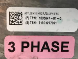

P/N 103564701C device is 3phase EU version of 72A output charger! On the outside you can distinguish it by a sticker on the side which says 3PH

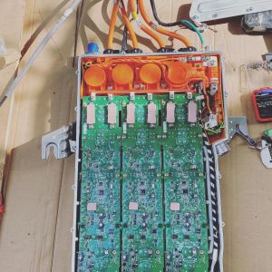

Charger with top cover removed
Step 1, to confirm all modules charger work you can connect 12V between top and bottom leftmost pins of the LV connector. Every modul lits its standby LED.
Step 2, was to remove internal components from contactor box in front of the modules. There are DC rails, AC rails, fuse and contactors which we will not use.

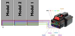

Image from Damiens github repo to clarify pin no 1

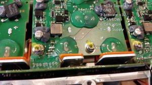

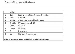

Step 3, inspect each power modules contact points with control board. This is where we will apply new wiring to be able to control the charger. See wiring table of module pinout.

12 way plug pinout (To charger power modules)
Pin Signal Pin Signal
1 Ground 7 Charger 2 Activate Signal
2 12V out 8 Charger 3 Activate Signal
3 5V out 9 Charger 1 Enable Signal
4 CAN Low 10 Charger 2 Enable Signal
5 CAN High 11 Charger 3 Enable Signal
6 Charger 1 Activate Signal 12 Not Used
